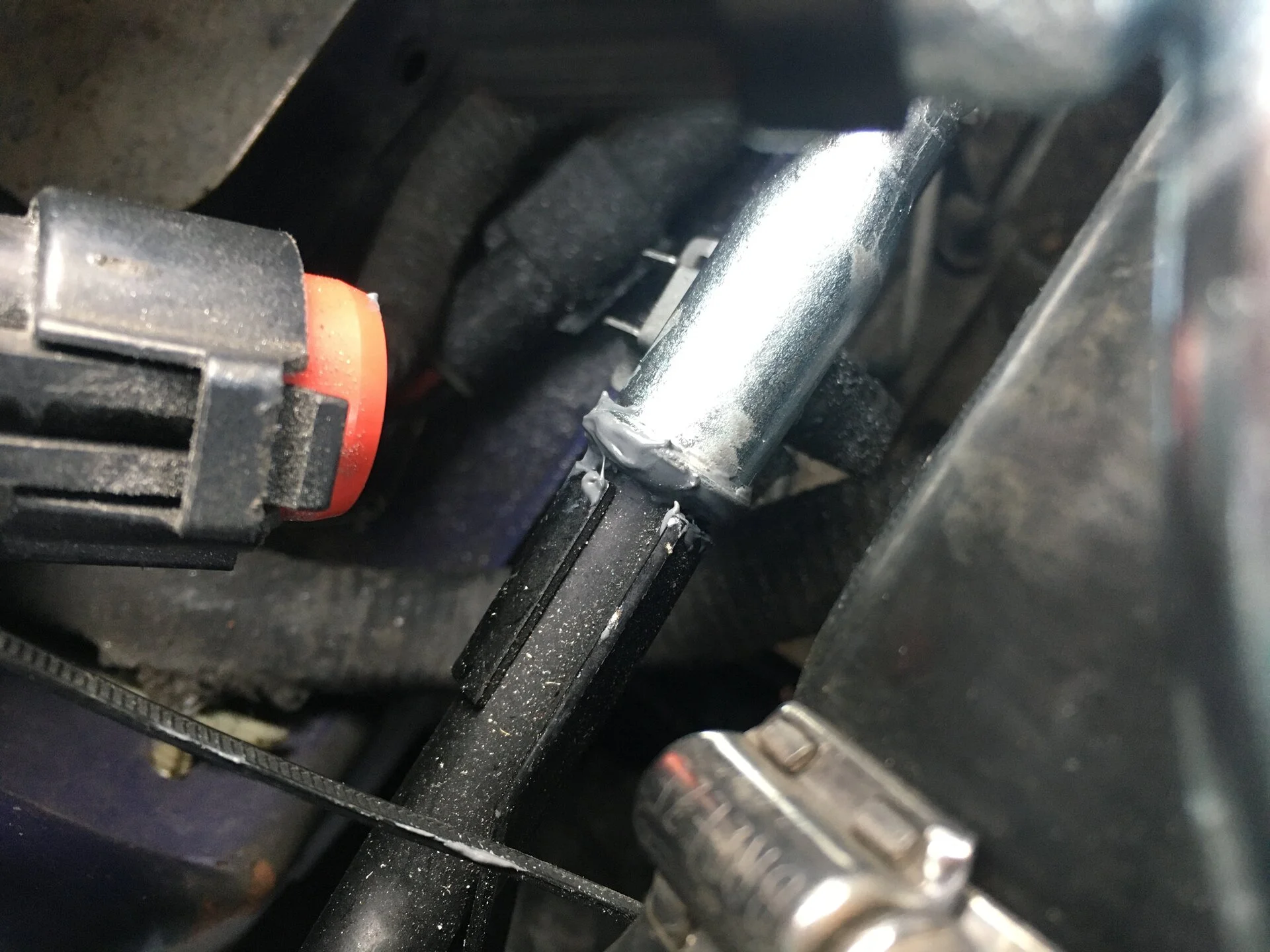

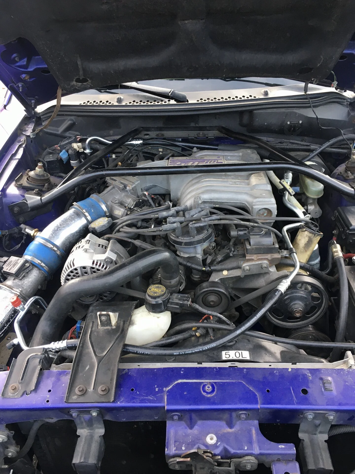

I disconnected the 2 ac lines from the compressor and the other end of the low pressure line. My brother came over to help me get off the other end of the high pressure line. We spent the last three and a half hours trying to disconnect that last line. He broke my two brand new quick disconnect tools and worn down a brand new Dremel bit. He still couldn't get it disconnected even though we can see the lock spring opening. We decided to cut it off by the spring lock and we're going to just weld the new high pressure side pipe straight on.
Get pics!!
we like to see fab work, the more boogers the better.
a small amount of blood or animal fur for extra credit :nice:
Ok here’s a pic of the Midas touch in action. The new high pressure end connection fit nice over cut off end of its connector. I first wrapped a bunch of Teflon tape on the cut off to make sure it had a good air tight connection. Then put JB WELD behind it, put the new pipe on the cut off and smoothed around the whole edge with my finger.
I used JB WELD to hold the side of the radiator on the core for my 72 Buick Skylark. Also made new threaded bolt holes to hold down the intake manifold on anonther car. Great stuff.
Friday I’ll do the pressure check, vacuum the system and recharge it.
