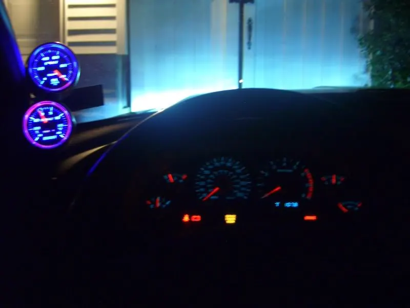

I got my new pillar and the guages fit flawlessly. I also got it 2 days after you called me! :hail2:
SoS pillar is F'ing AWESOME!
Can you get some better pics maybe? Like in the day too....ill be ordering an A piller gauge pod in the next few weeks and in between the SOS and an autometer 3 gauge setup. I have seen the auto meter setup personally and it looked GREAT. I have something up my sleeve, so I NEED 3 gauges for it to work. ANY SOS 3 gauge pods?

Sorry, SOS doesn't offer a triple. That may make your decision a little easier. :(
If you want daytime pics of the SOS pillar anyway, just click the link in my sig.
