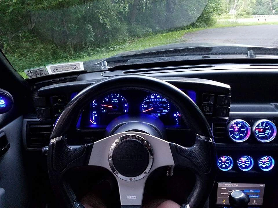

Next winter i will be disassembling the car down to pretty much a shell and slapping on a rotisserie to redo the undercarriage etc. Im contemplating upgrading the factory ECU to a standalone system that i can learn to tune myself. A couple years ago i rewired the whole car and removed all unnecessary wiring (i have no hvac, ac, smog etc) and wired all my autometer gauges, fan controller etc into the factory harness (no add on fuses or that nonsense). I like the way my car looks with my autometer gauges (i dismantled and modified my stock cluster to match my autometer gauges) and would like to retain them if i do decide to upgrade. My goal with this car is to look as if the factory built a high end street/race version of a fox. So i want to add to what makes these cars what they are and not essentially slapping a foxbody shell on a brand new car. I know the holley requires a bit of rewiring etc where as the haltech and Pro-M seem to be more plug and play. I may eventually want to go to a DIS system. If i do i dont want a dual sync dizzy i would rather run a setup like a price motorsports cam sync to clean up the look.

Its funny because when i asked my tuner about systems like megasquirt or pro m etc he said all garbage...easier and better to tune the stock ecu...i feel he was just providing job security for himself...if people tune on their own they dont need him lol. Ill read up on these systems. I have all electronic full sweep autometer gauges (fp, oil pressure, oil temp, water temp,) a dakota digital fan controller, and an innovate LC1 wideband. Hatch mounted battery...relays for the headlights, dual contours etc.
How much of this can i keep? Or should i go a different route?

I also want to reiterate that you can keep all the current stuff you have set up now gauges wideband Etc. I am currently in the works of upgrading my instrument cluster to a digital LCD screen running the tuning software.

Well im boosted and eventually want to build a dart so i can hit 700+rwhp so it sounds like one of these systems should eventually happen. Im not against running a digital dash or something and removing some gauges but since i already have them i may as well utilize them..
Would you guys run Maf or SD? Ill also be building a custom intercooler setup at somepoint and ditching the MAF and in doing so the bpv would allow me to clean it up nicely but i dont want to jeopardize driveability.
I spent alot of time making them match...
