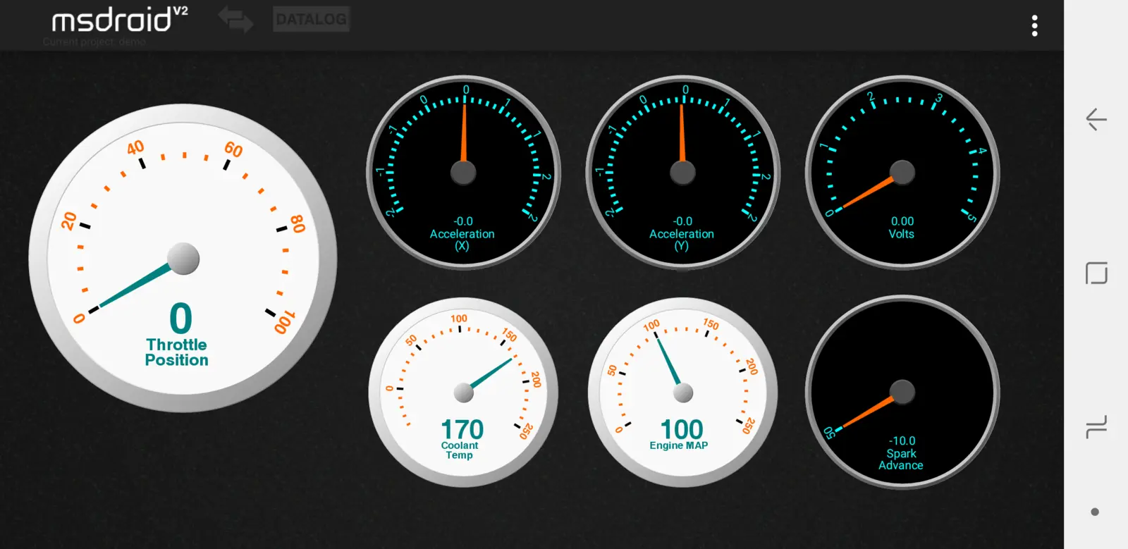

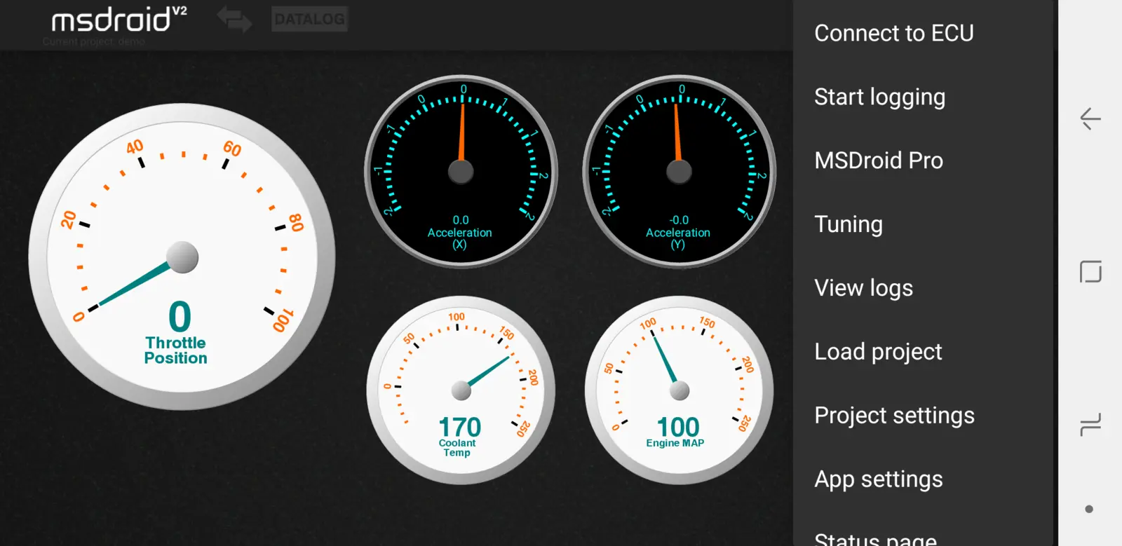

Megasquirt has a smart phone app that allows you to hook up via Bluetooth. You can log or tune right on your phone and review it. It also has a dash screen with customisable gauges for whatever you need. Display is in real time.
