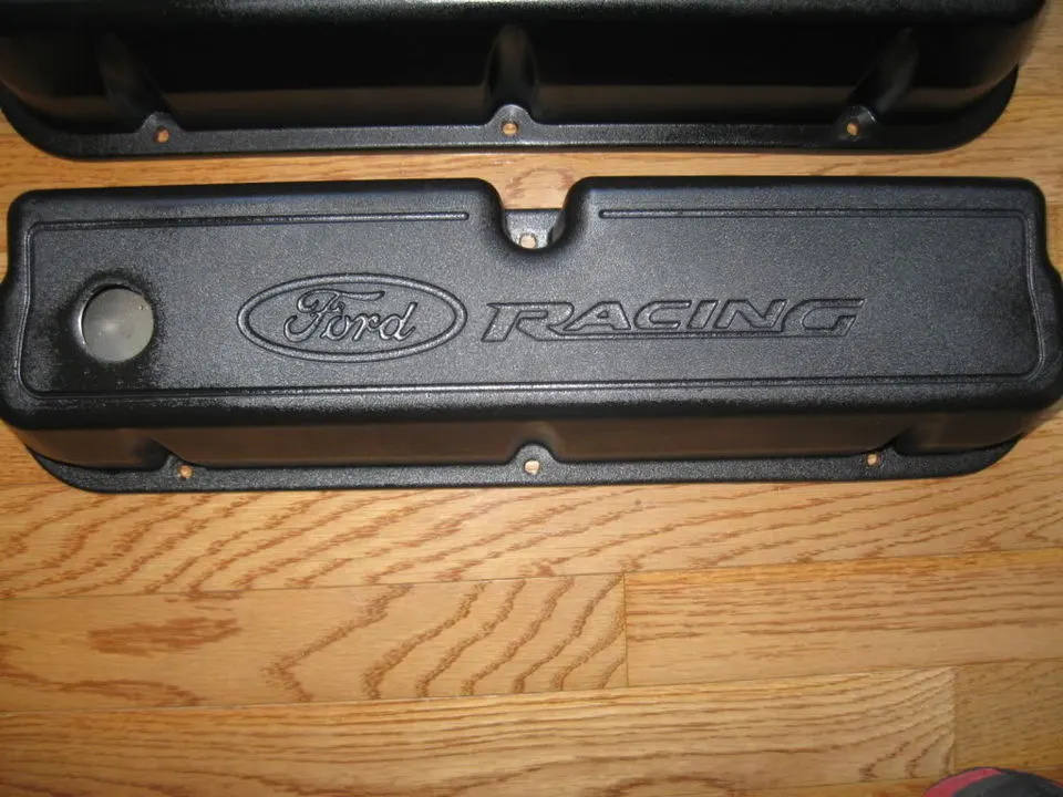

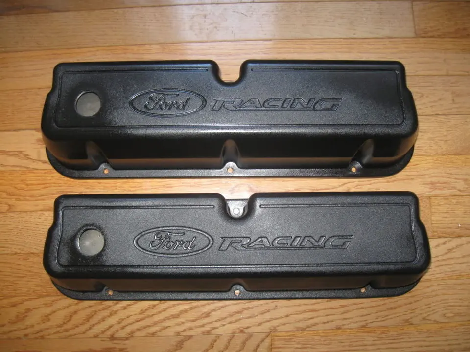

Took some time yesterday and repainted the valve covers b/c in my recent move they got chipped and scratched up. I re did them in black wrinkle to match the intake when I get it powder coated. I considered just spray painting the upper/lower intake as well in black wrinkle but I'm not sure how durable it would be as compared to the powder coat. I know in general powder coat is much more durable but once the intake is bolted down I dont plan on moving it again for quite awhile.
