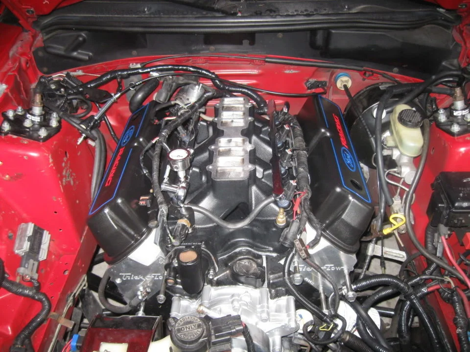

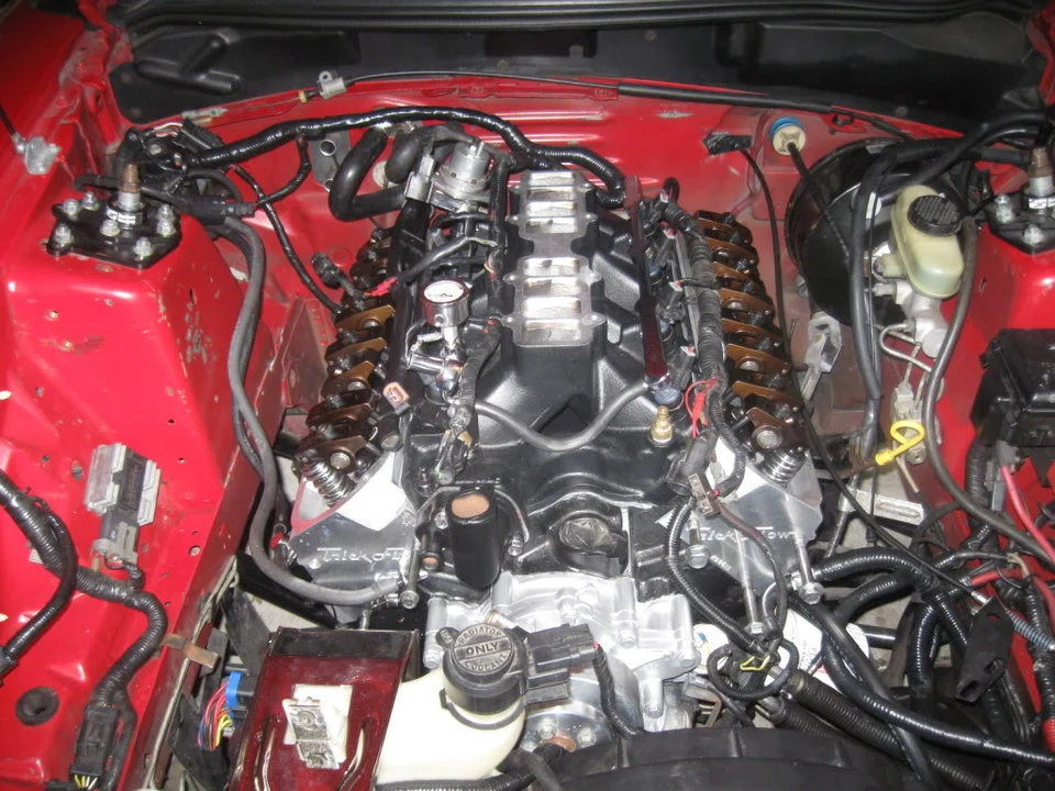

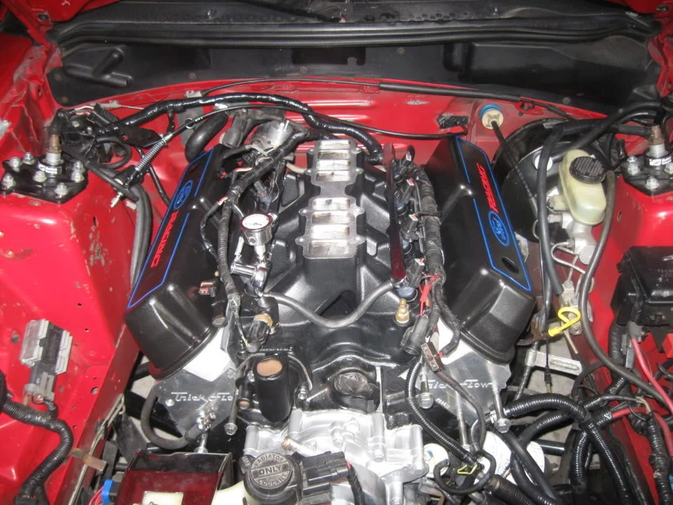

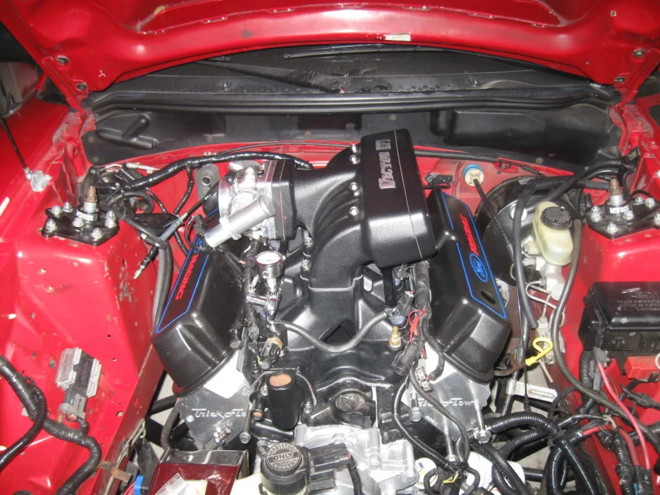

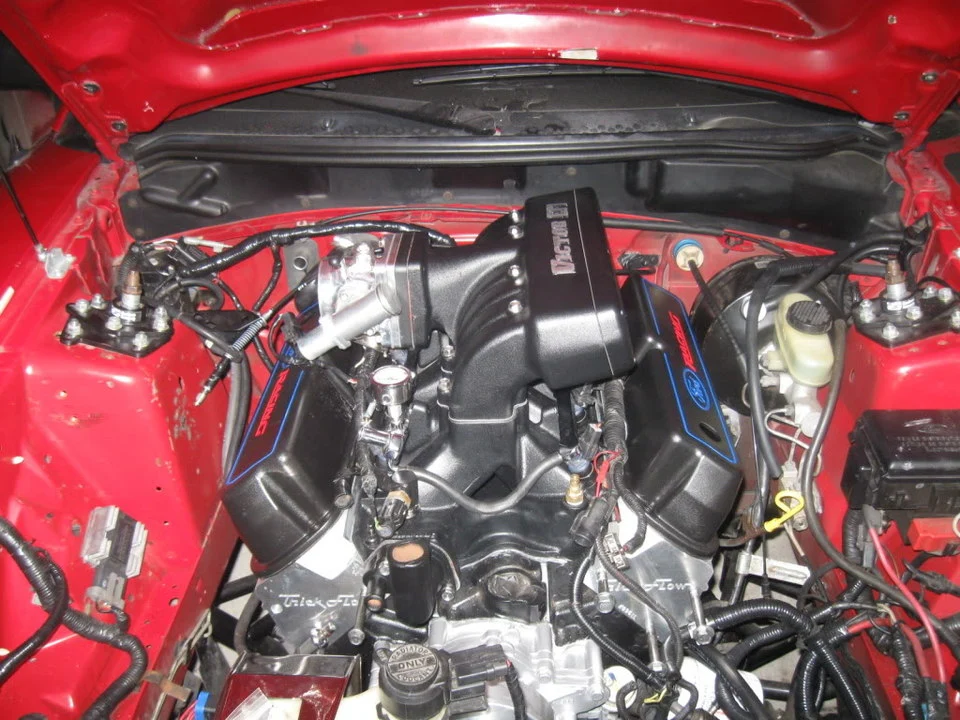

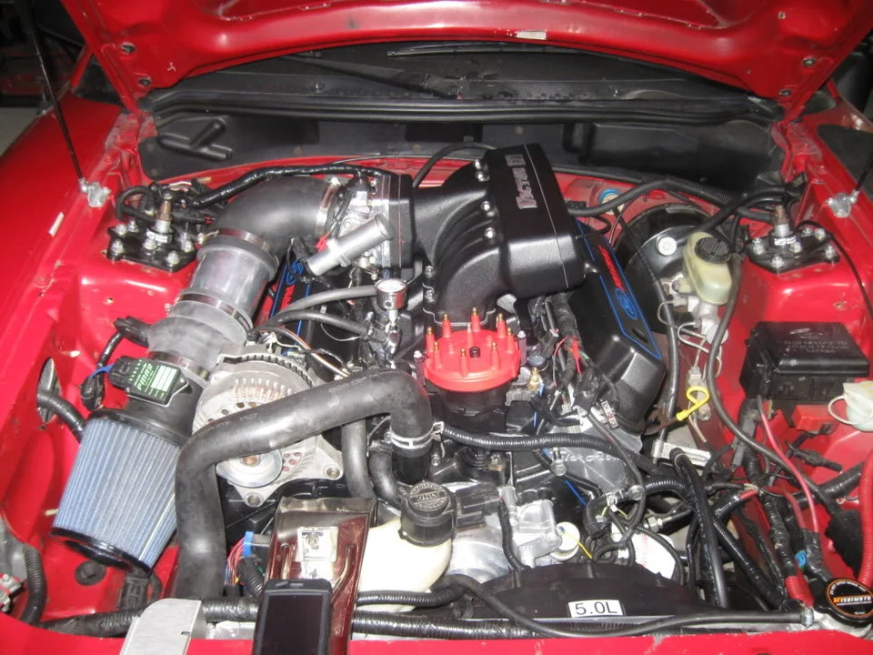

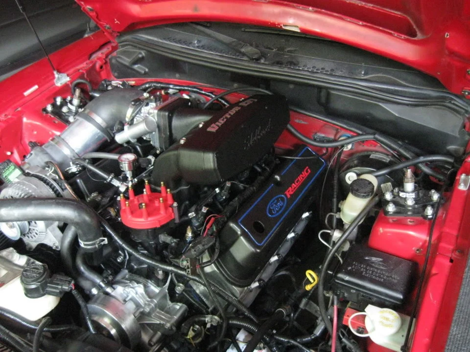

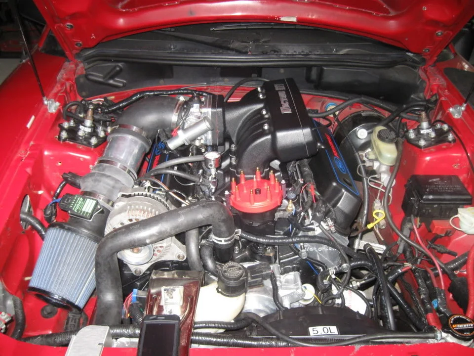

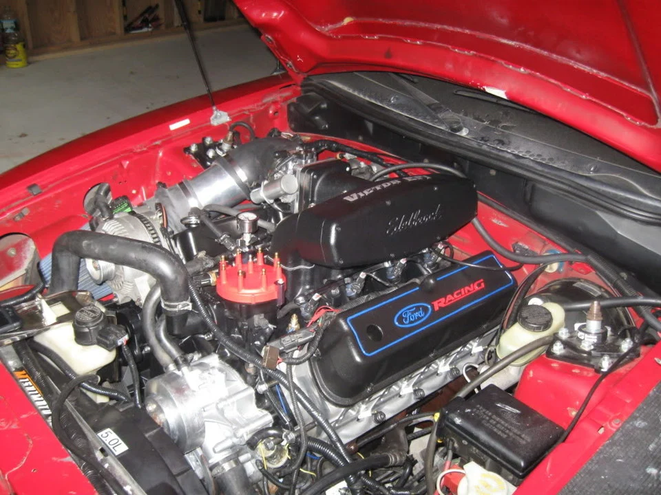

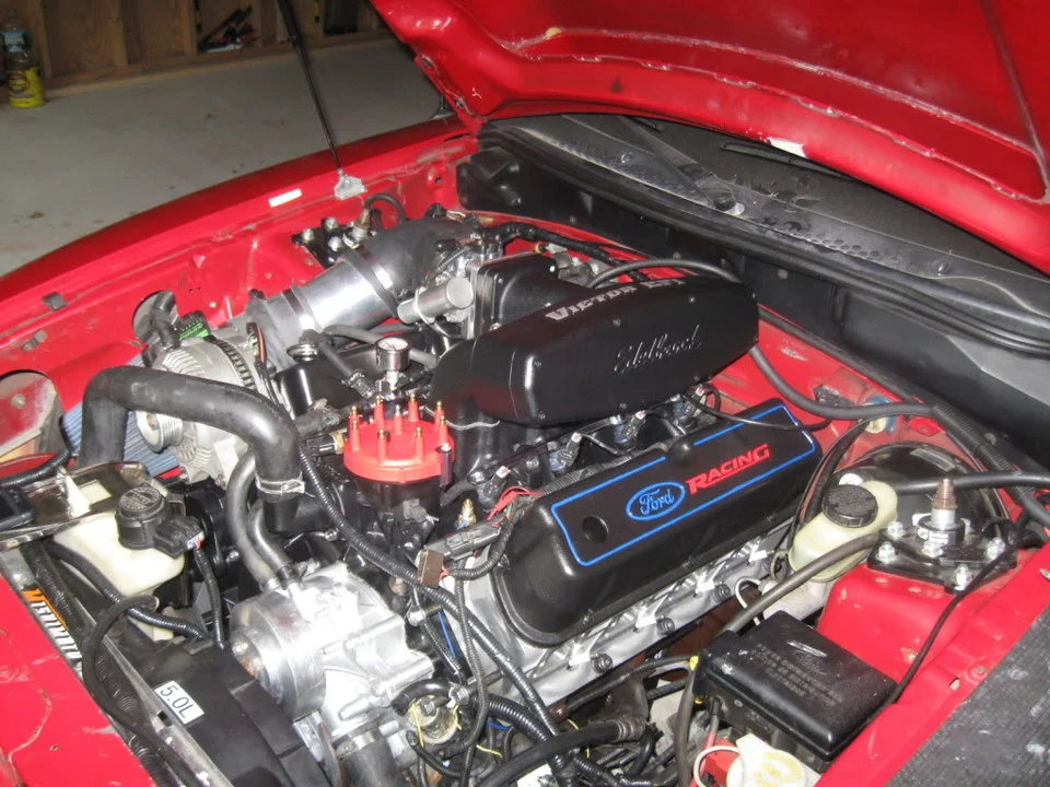

Made some decent progress this morning

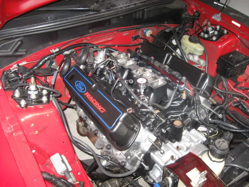

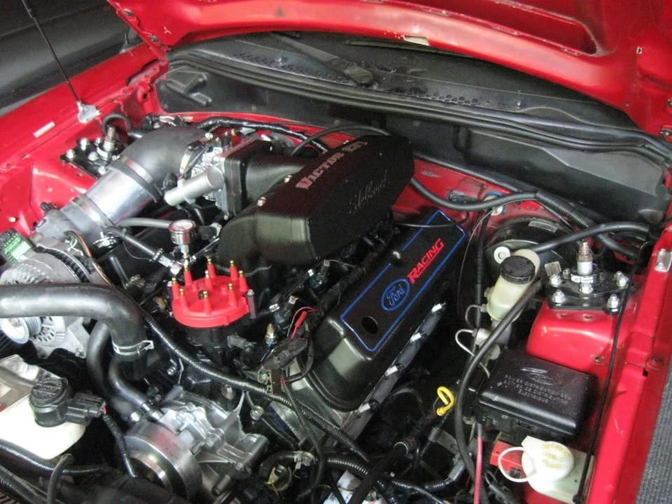

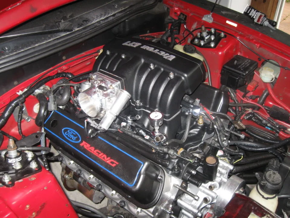

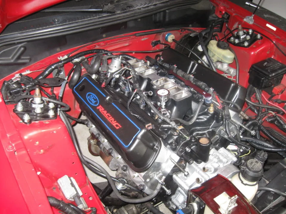

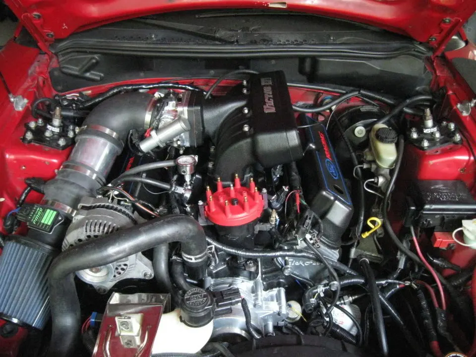

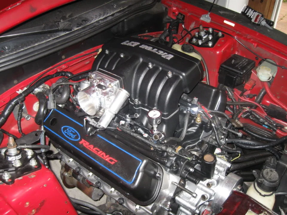

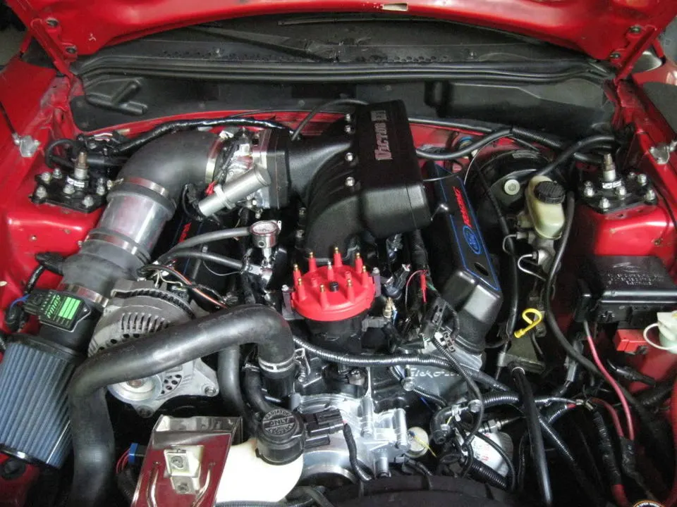

Thanks Kevin, here are a few w/ the flash off. I just need a better camera in general this one is getting old. My iphone 3 takes better pics then this thing does.
Also if you look at the pics in one of the side shots you can see the IAC has been flipped on the bottom. I had to do this bc the harness would not plug in from the bottom there was not enough clearance from the valve covers. Is it ok to flip it like that?

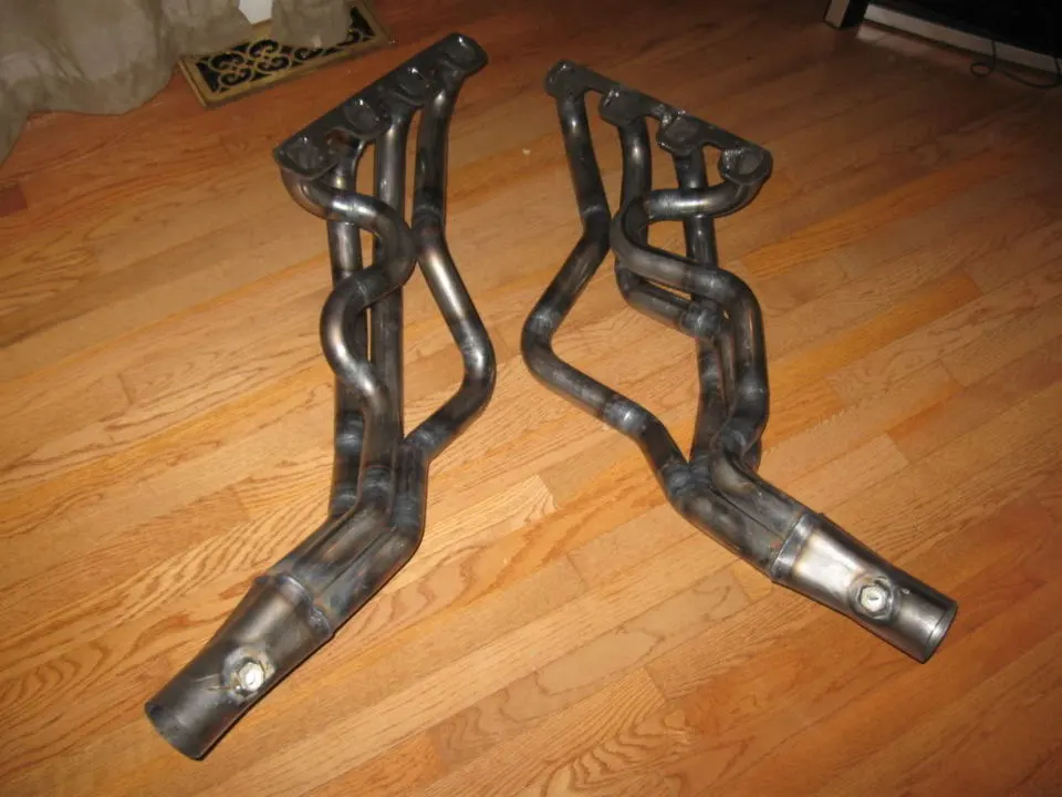

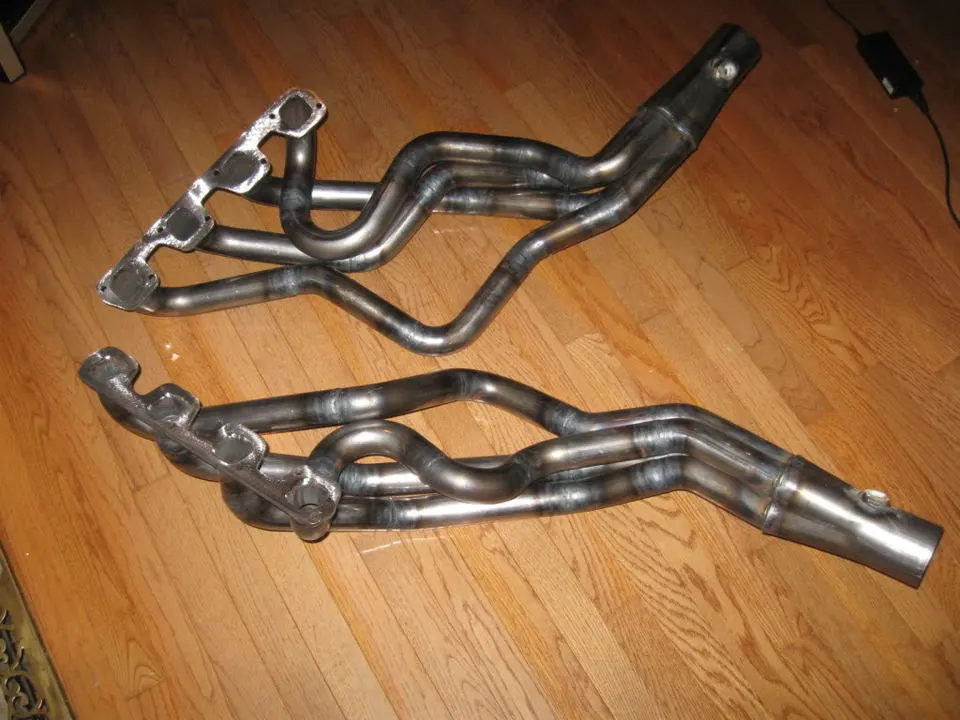

Well been awhile since I have updated this and reason being there is nothing to update lol. The Long tubes are done from Accufab and I'll post pics when I do get them but I'm sorry to report that I will not have the Mustang running this year. In order to finish the car off w/ the parts I have left to buy is going to be about $900 plus the cost of Insurance, Inspection and registration and the best case is that I got it running in September ( sometime ) and that would give me very little time to actually drive the car and take it to the track. And that is if eveything goes perfect and it started right up and there were no issues or leaks. Point being I dont want to dump that kind of money into the car just for a push of only being able to use it for a few weeks before its up for the winter. Usually I dont have it out past the end of Oct. So as for now it will sit as it is, over the winter I will get the rest of the parts I need and once spring time rolls around I'll pick up where I have left off. So Dyno numbers on the new nasty heads will have to wait until next spring......sorry guys

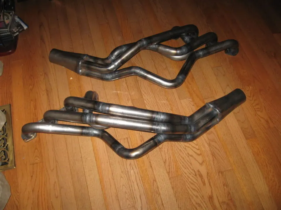

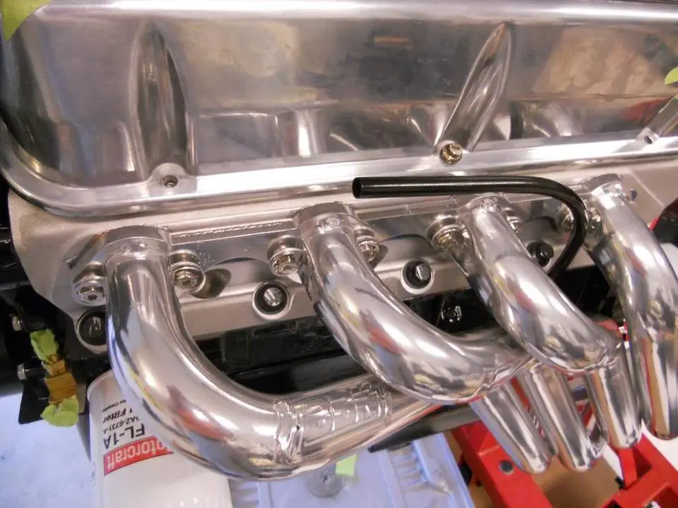

Finally got my headers from Accufab a few days ago. I tried to test fit them by putting them in from the top but thats a no go, looks like I'll have to install them from the bottom which is going to suck anyway. Not looking as though I'll be able to clear the steering shaft either so I'll have to undo that as well. I'll try and get them installed before Im done working on the car for the winter. I need to get the 02 sensor holes drilled out in the long tubes and I need to get the flanges put on them and get some gaskets and bolts and I should be good to go.

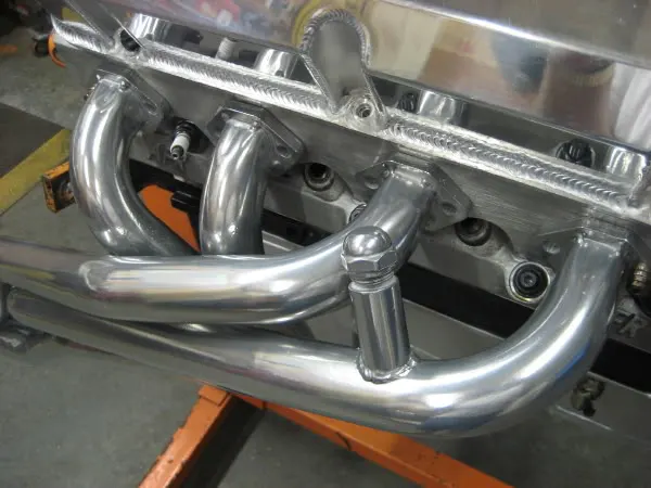

I used these guys... Photos
Price was 200.00 for in/out plus 35.00 for shipping. Well worth the money as mine still look like the day I put em on.
