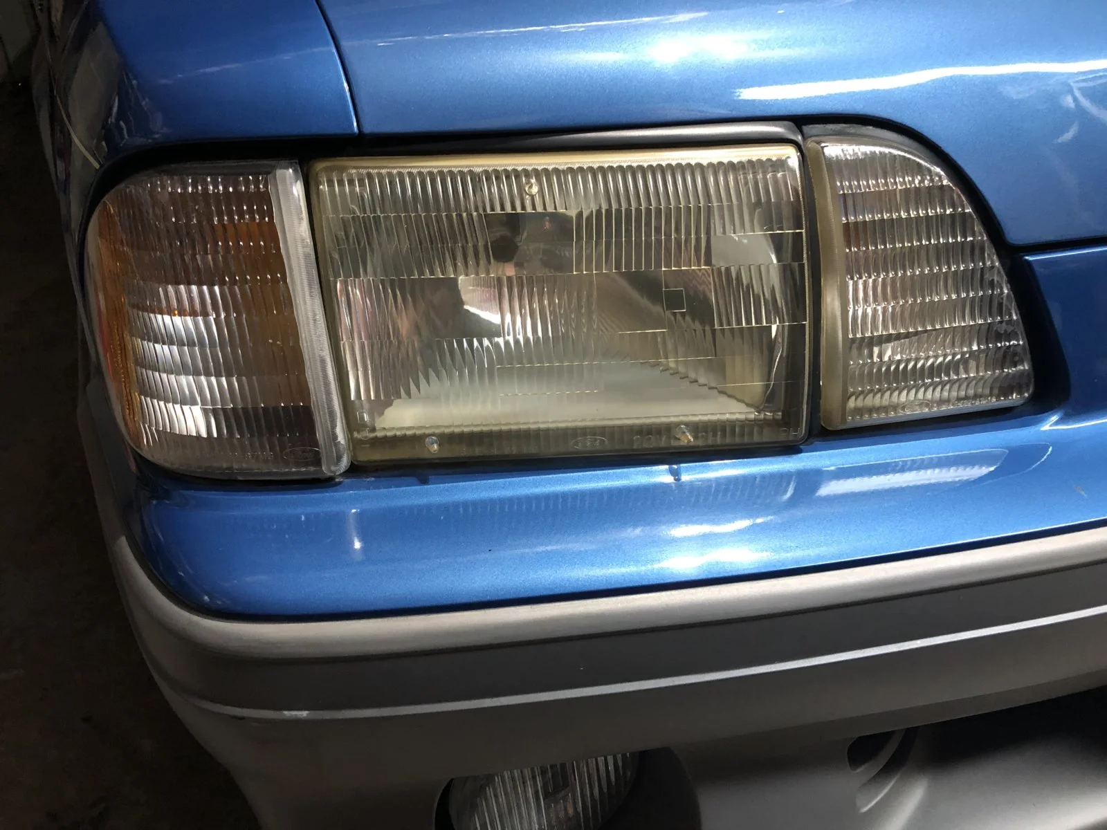

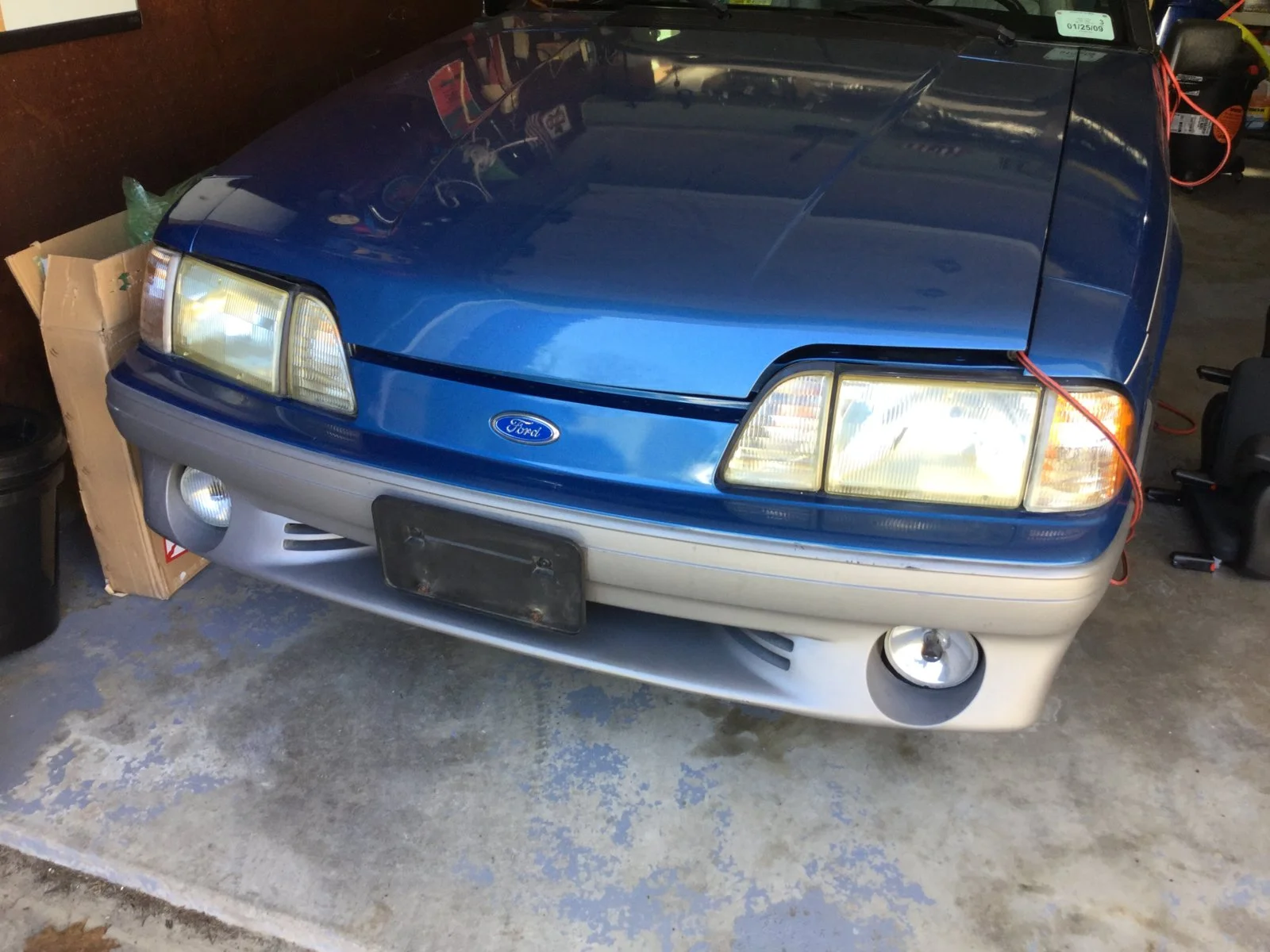

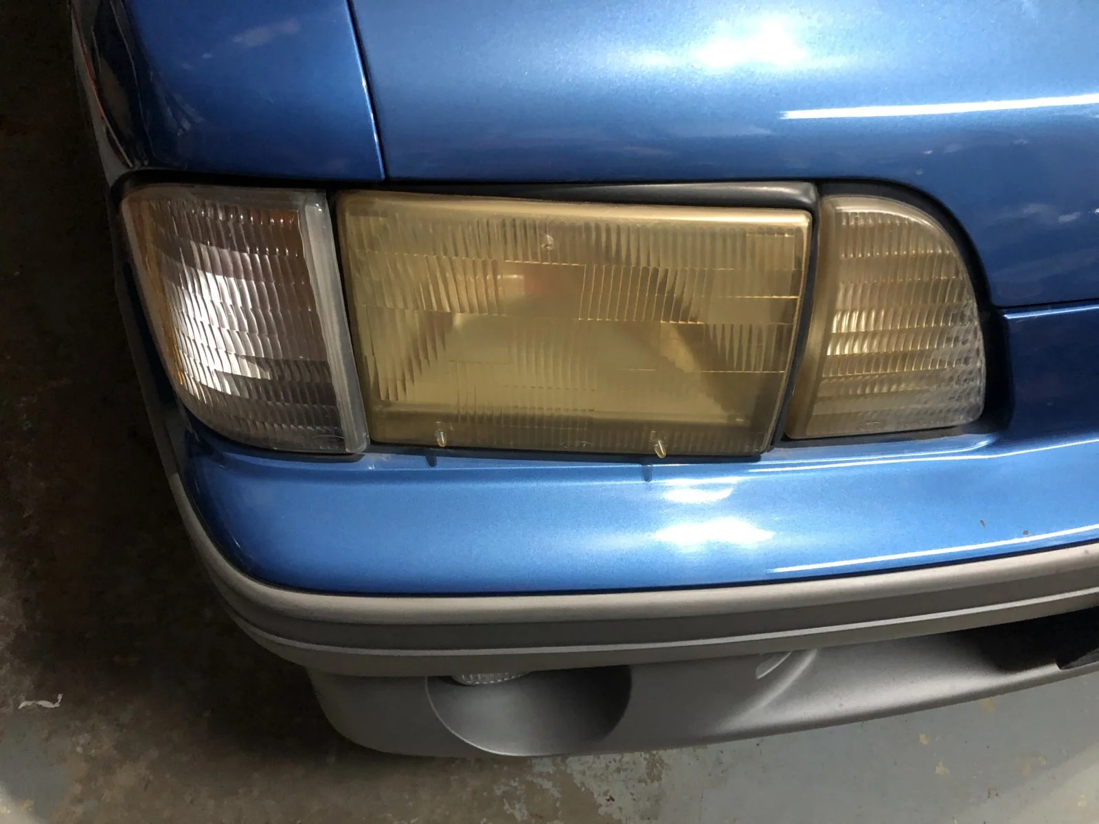

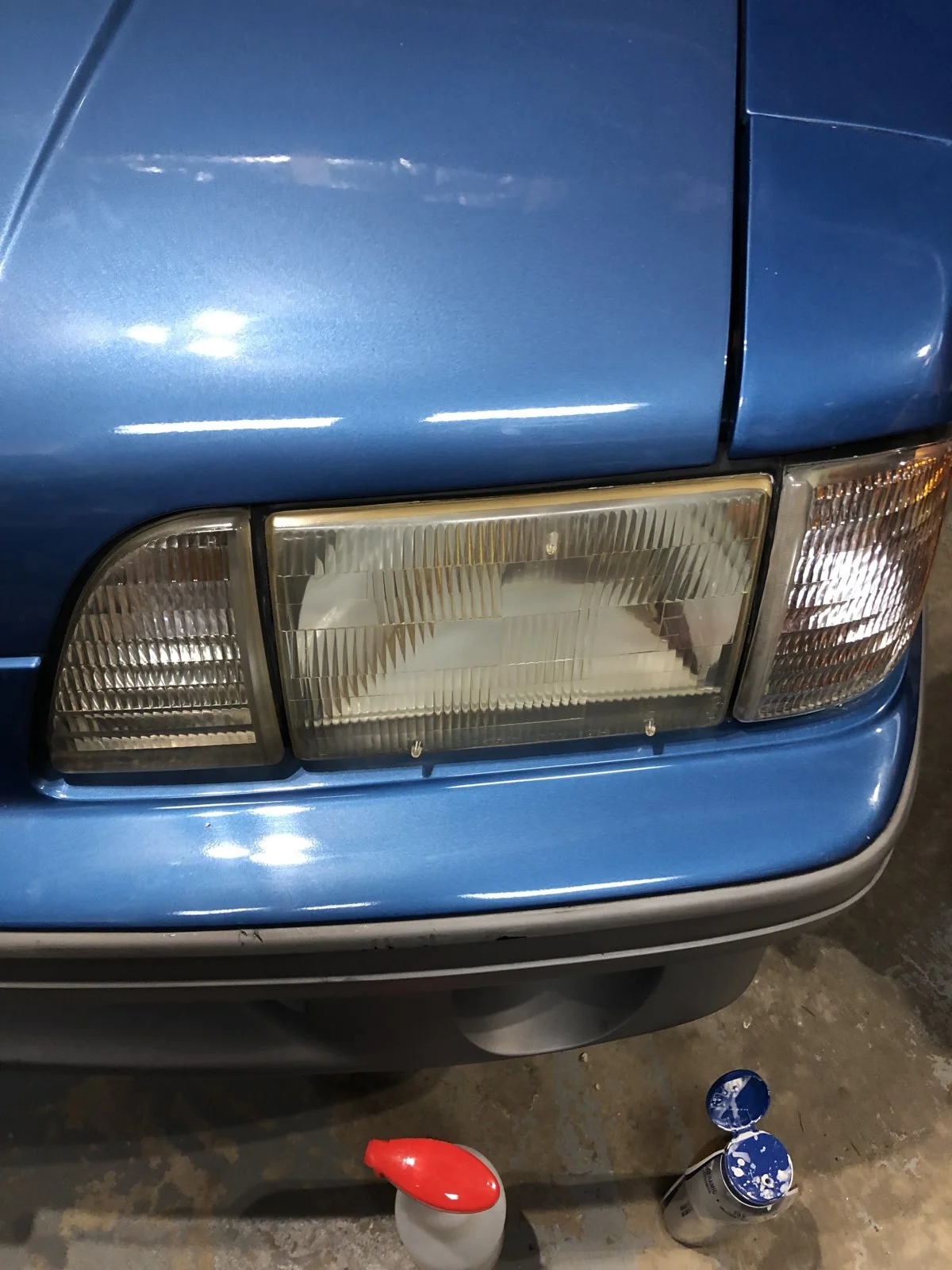

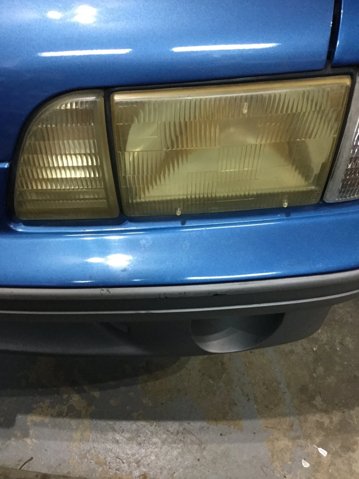

The thread I found this on was old, so I thought I’d make a new one. Did my headlights today using only Bar Keepers Friend, Mr. Clean sponge and some elbow grease. Not perfect, but way better and cheaper than any kit out there. I did use Rejex as a protectant after I was done, but I already had that. Point is it can be done cheap if you’re on a budget and don’t want repros.
I don’t know why the right headlight is crooked. Drives me nuts, but a project for another time.

In think your right headlamp is out of adjustment. You can use a 5mm socket and bring that back in. There are a couple adjustment screws that stick out of the back of the lamp. Right, left / up, down. The lamps really cleaned up well.
Reactions: gearhead77
After the damp Magic Sponge, Kit Scratch Out or Meguires Mirror Glaze (both for plastics and even helmet visor screens) will take the micro scratches out. That’s the step to get them or your gauge faces crystal clear again.
The hard work is scrubbing long enough to get all the yellowed plastic off, and your certainly did that.
It looks so far out though that I bet one of the springs is loose or broken.
Cheap fix though, LMR has replacement springs.
