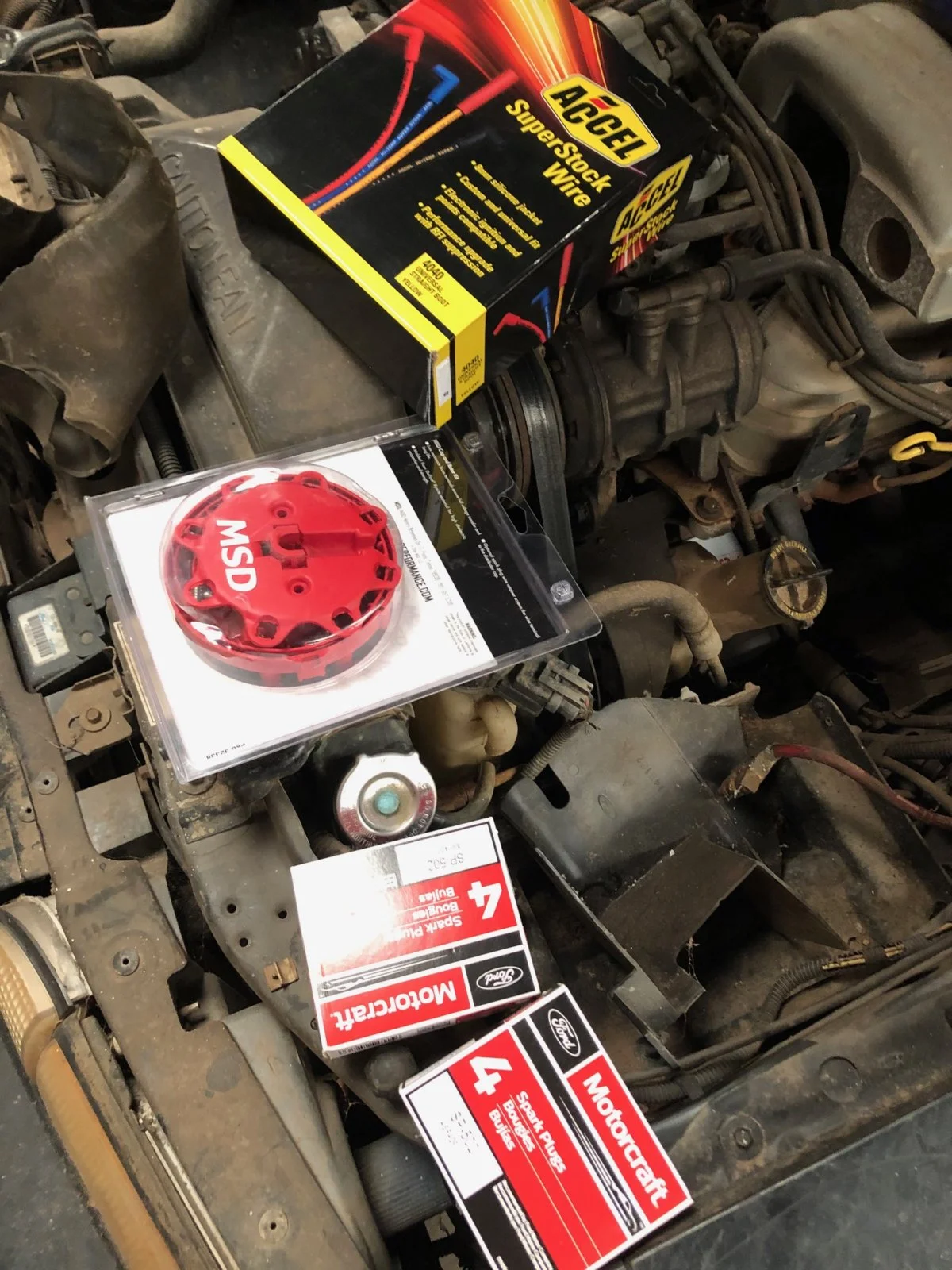

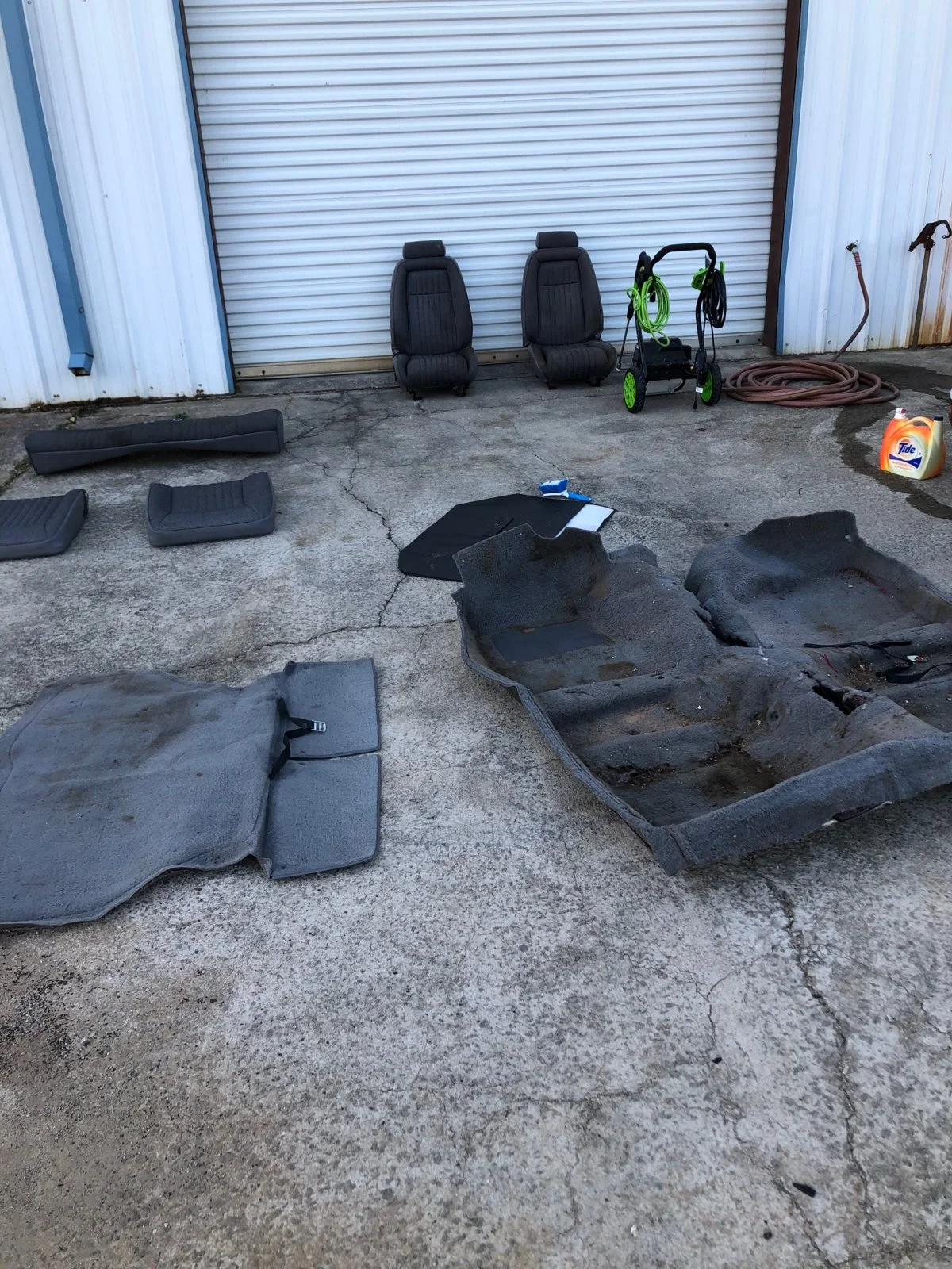

Yea I will get some pictures and post them before I start cleaning. We are working everyday doing auto repair at the shop so I am limited to what I can do during the week. I did order a MSD cap and rotor, motorcraft sparkplugs, acell wires, coil, regulator, motorcraft fuel filter, and an air filter yesterday. I hope I can change all of that out by this weekend.

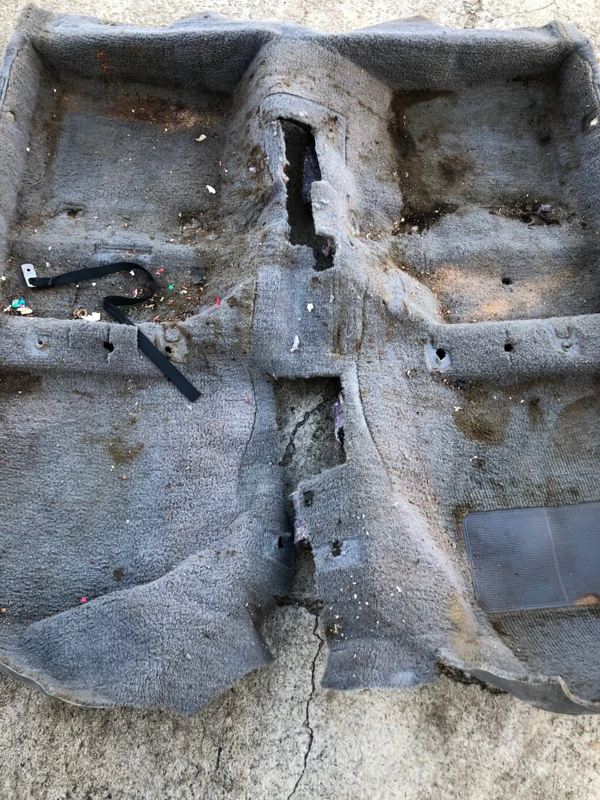

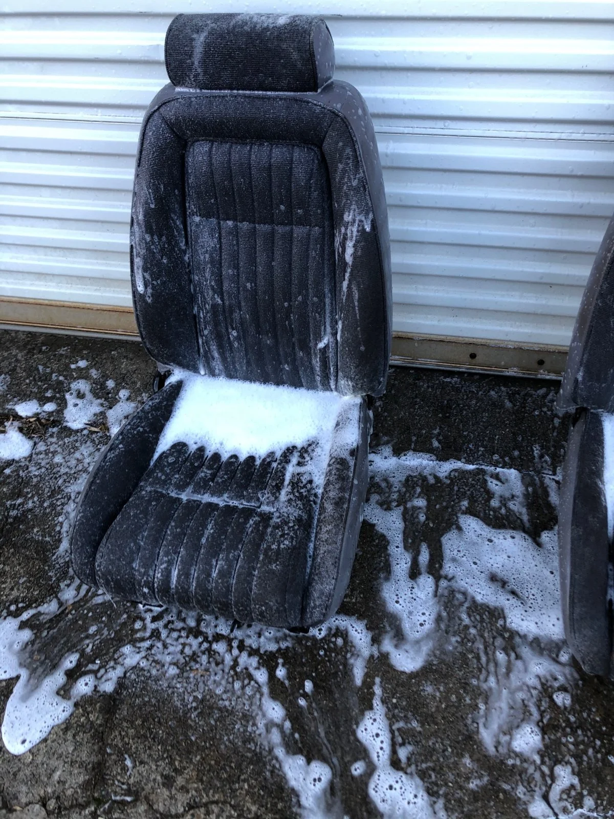

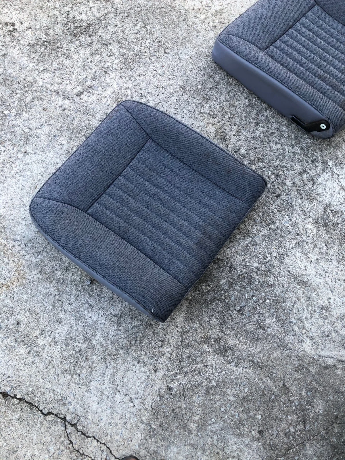

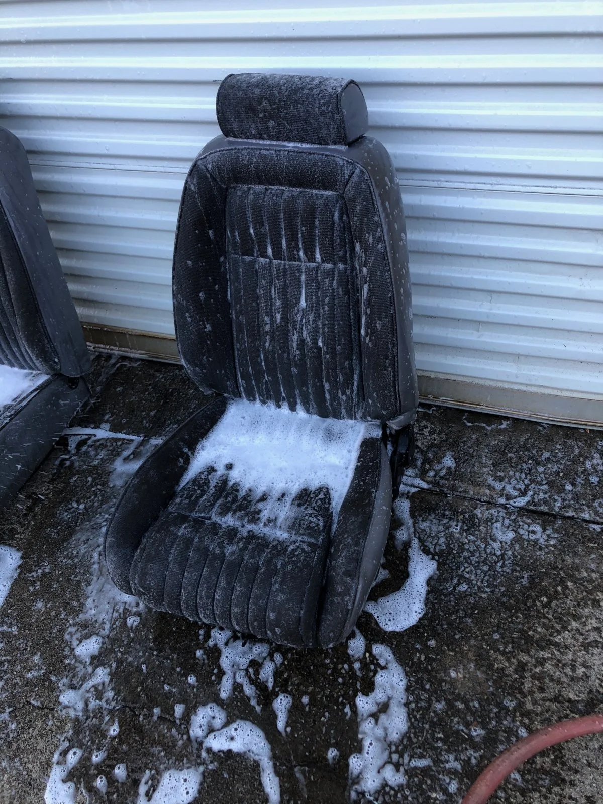

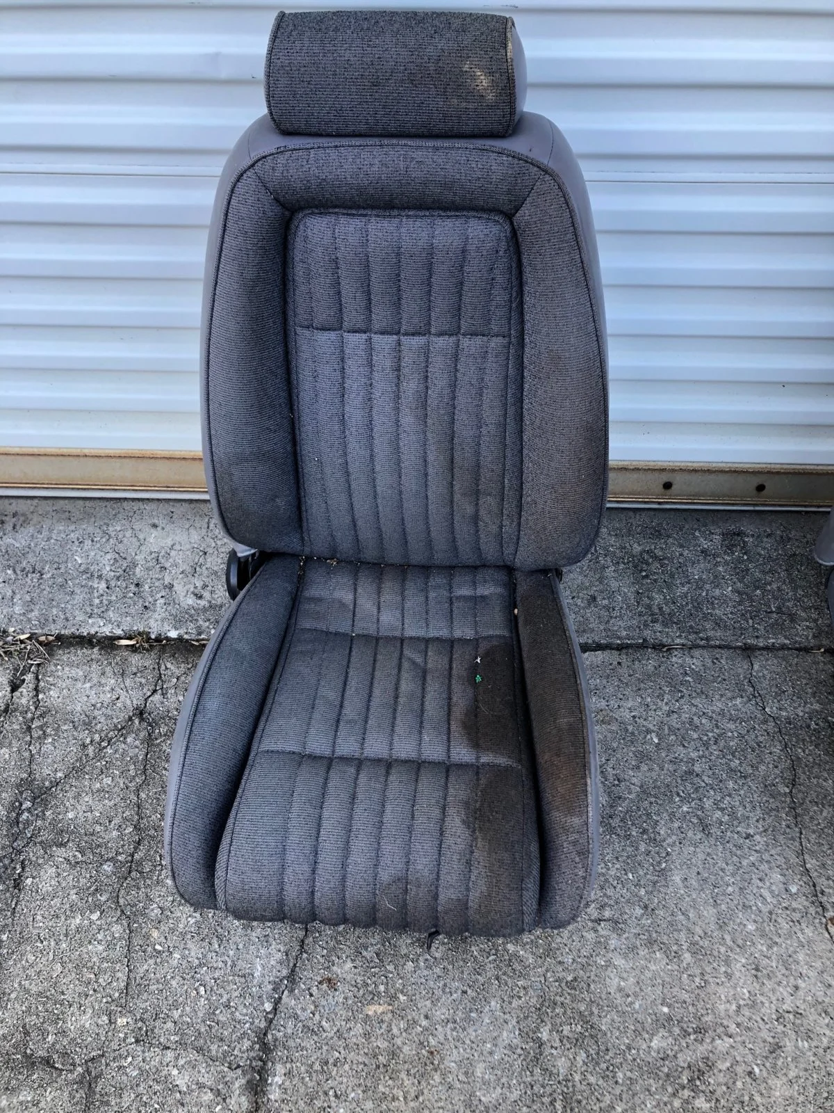

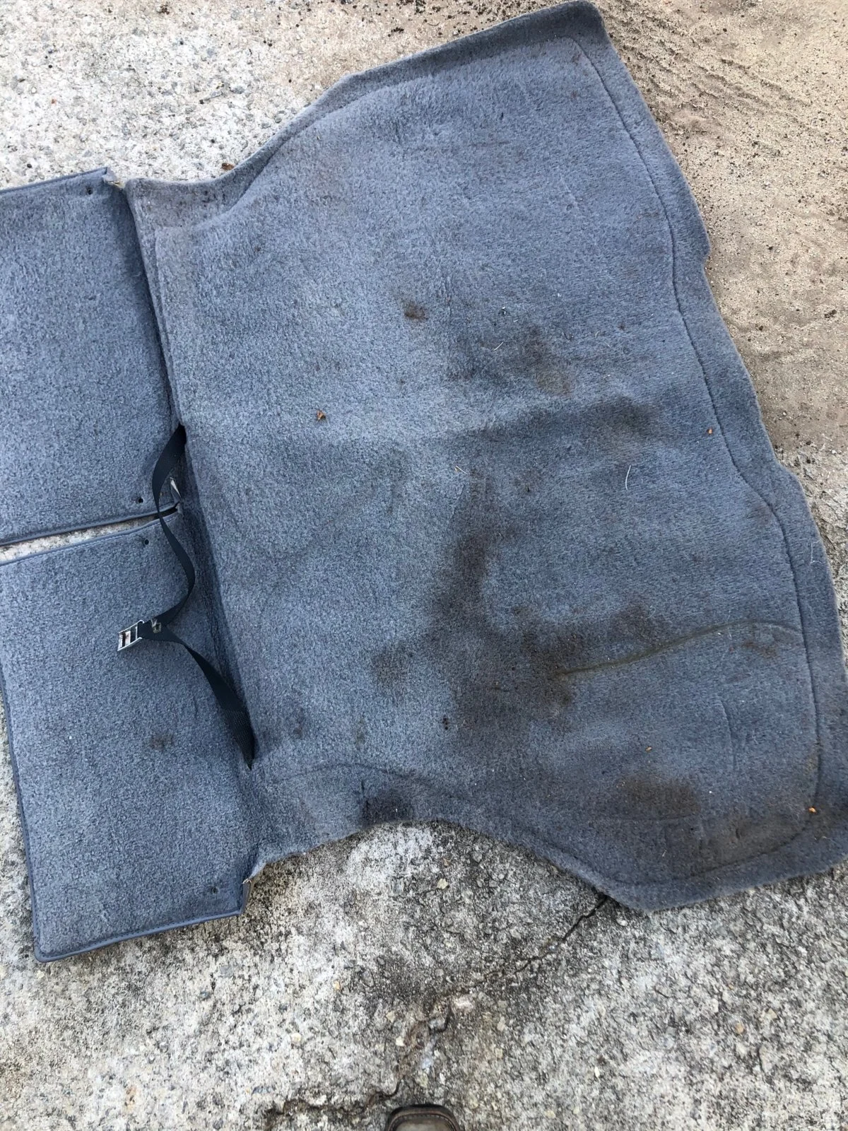

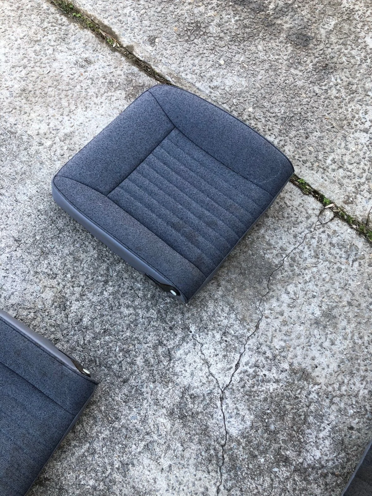

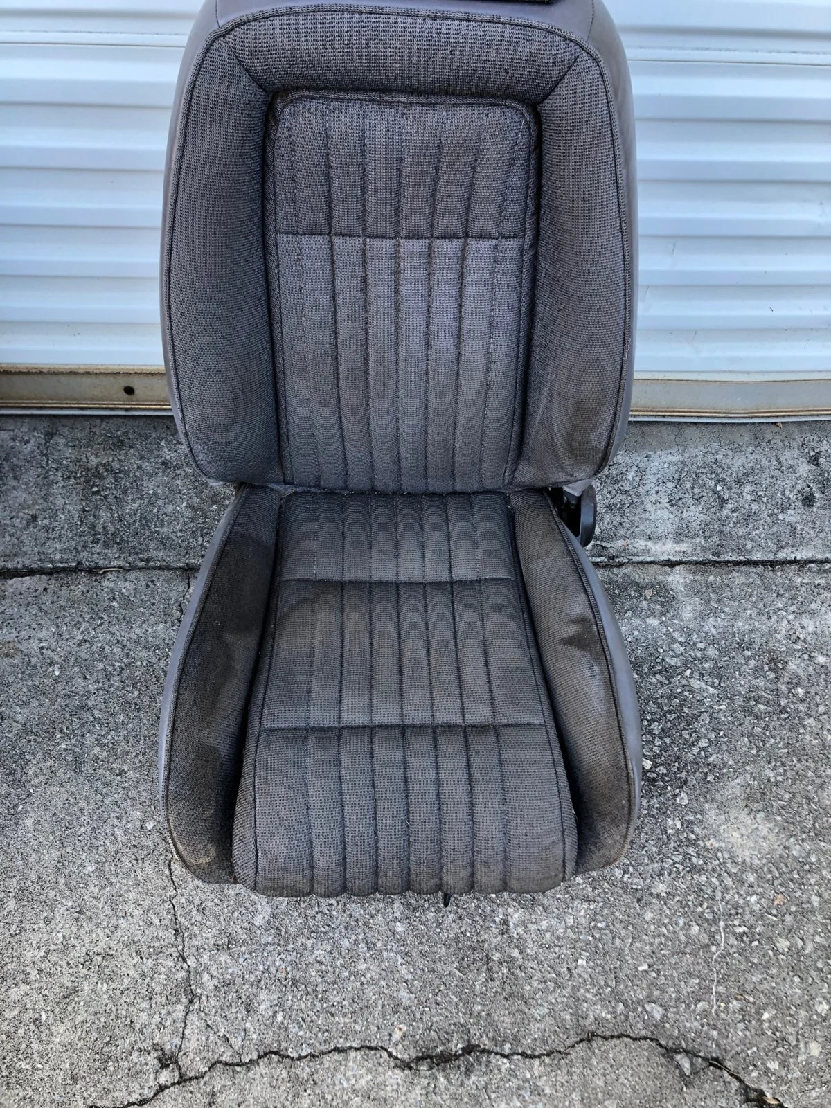

I got a chance to start on the seats/carpet yesterday. Here are some before pictures, this is going to be a process so hopefully I can get the after pictures up by this weekend.

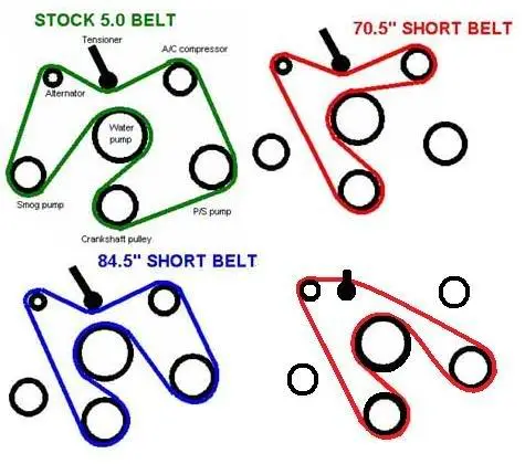

But if your cars are gone (or you are running modern cats) you can just yank the pump and all associated plumbing. Your belt will get rerouted like the blue diagram (ignore the belt length, you should measure on your own). In fact, do this first, then delete the pump once you have your accessory belt sorted
