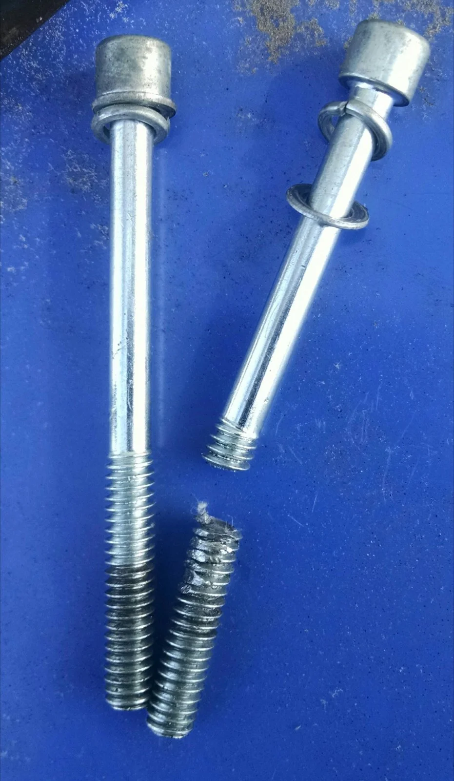

no they are weird, the shaft is smaller then the threaded part

Sigh,..they're just long assed SS 1/4" socket head bolts. Exactly like the ones on the Monster, exactly like the ones you can get at any nut/bolt house in your city.

They are just skinny in the center to make it easier for China to skimp out on the amount of metal used and save money. Worst case, get some 1/4 20 (I think) all thread and some nuts and make your own.

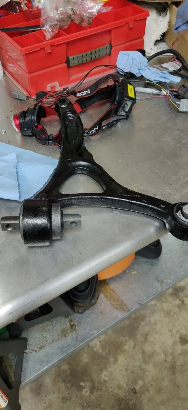

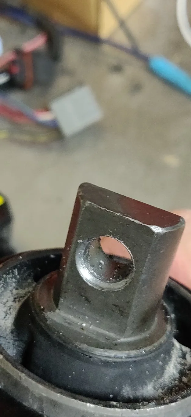

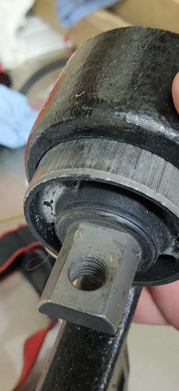

I started writing this last night and the PC crashed. Anyway, worked on my son's 2005 Volvo XC90 over the weekend. I already had put a new balljoint and lower control arm on the passenger side, but due to the fact that it took all damn day to figure out how to get the new ball joint in the spindle, we had to postpone doing the driver side. The V is backward from everything I've worked on. The ball joint is pressed into the bottom of the spindle. Volvo makes a special $150 driver to hammer it in. The big Atlas tools ball joint press at Autozone is not supposed to work. After dicking with it all day, I got up Sunday and said WTF and got it and got it in pretty much trouble free.
Fast foward to this weekend. I have all the tools out, start getting stuff apart, use the back joint tool in an all too sketchy manner but again it works with no lost fingers or even any cussing. I tell my boy to replace the control arm while I replace the tie rod end. It's a weird design with a cross bar with two bolts in the front going thru the frame horizontally and one bushing in the rear that is oriented vertically with one bolt thru it. He keeps fussing and sighing and says I give up...can you get this one bolt started. SO I make fun of him and get under there.....and start cussing. I say give me my glasses. I look for a minute or two then realize one of the bolt holes is NOT TAPPED. WTF! I guess that's the game of buying things in the economy listing at RockAuto.
I've got the correct tap, so take it off and try to tap it. Obviously that cross bar is hardened and it's harder than the cheap ass Chinee tap set I have. I tried to ream the hole to get the tap started and about the time it finally started to cut a thread, the tap broke!! Then it took me another hour to get the old ball joint out of the control arm. With the volvo setup you have to have a pickle fork or ball joint spreader tool to get it out. There is not any spring force on it to do the regular loosen it and hit the control arm with a hammer. So I had to go to Autozone and rent the spreader tool.
Finished up with a home grown tape measure alignment. It needs tires, so I said it's close enough and we're going to PepBoys Wed to get it aligned and new tires.
But then last night he texts and says the Service Anti Skid System message has come up. No check engine light and I don't think a regular ODBII code reader will tell anything. The only possible correlation is I removed the driver's side anti-lock sensor from the spindle and put it back in. I double checked the wire wasn't being pinched between the strut and the sway bar end link. So I don't know if it is just a coincidence or if I did something and broke that sensor.
The interwebs say the #1 cause is the steering angle sensor ($300+) in the steering column or the vehicle yaw sensor under the passenger seat. More $$$$ freaking money pit. My ex bought this for him without consulting me. I was going to get him a good old Ranger. So happy high school graduation present to my box. 4 new ground grippers and an alignment.

FYI, I was able to get the bolts from Holley. Apparently they are identical or a china knock off of there sniper valve covers
