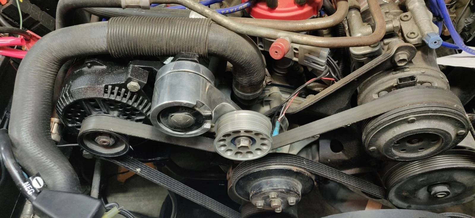

You know when you do something really good and it turns out as least as good as you thought? And then because it looks so good, you realize how nasty everything else around is?
Yeah, that's me. I took off the billet low mount alt bracket and sold it. I cleaned up and painted my stock bracket and alternator black. I also remembered in my stash is a polished tensioner. I put all that on and the rest of the crappy pulleys look 10x worse now. I have to move that big ass piece of ribbed tubing back over...I just now noticed how far out of place it is.
Reactions: 90sickfox

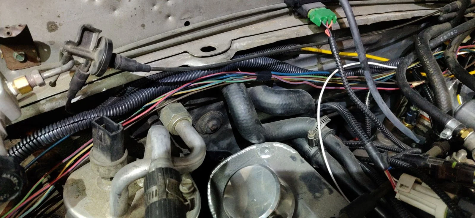

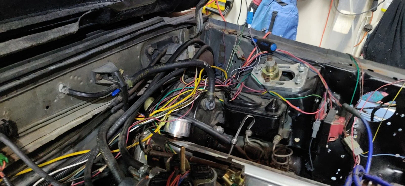

Ok, so the engine just turned over for the first time in what, 3 years. The Holley computer and ignition aren't wired up though. BUT, I need an Ed U Ma Ca Shun. Educate me.
I am tucking the wires and doing a lot of cleaning up and removing wires I don't need. I've wired in headlight relays. I am getting ready to wire in the TFI coil (I have TFI with the Holley C950). The underhood connector that the factory coil connections come out of, along with the oil and temp sending and some other stuff, is roasted, so I am going thru all of that. Red/Light green is coil +. But if you trace it back, it goes to a splice and connects the Red/Light green wire to a brown/pink wire. I thought, cool I can get rid of the splice and have 2 wires hot in start and run.
WRONG!
I tested each wire. It's hot in key on/run position. Dead in crank. Each one individually.
BUT if you hook them together, it has battery voltage in crank. Obviously, this is the way it was and it worked, but I am CORNfused!
I've got a EVTM and the wiring schematics. Both the R/LG and B/PK wires go back to the ignition switch.
What am I missing here? :lcoff:
Any who, I am rewiring the connectors for my digital cluster and I am pushing forward. I'm sure the gas in this thing is sludge...maybe just maybe I'll need to go get some fresh gasoline tomorrow and try to crank it.

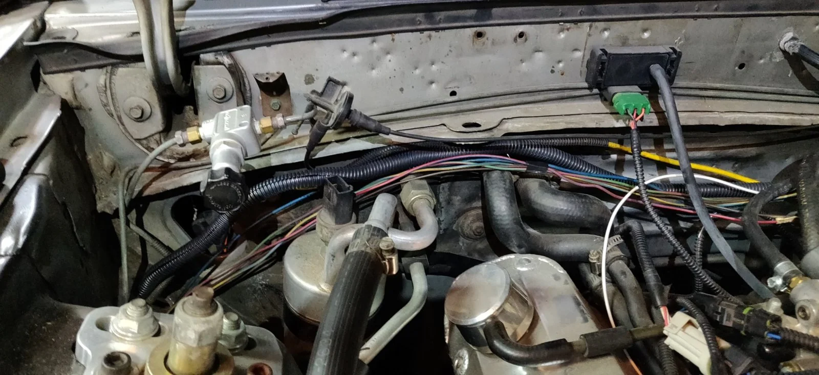

So a little progress tonight. Rerouted most of the wires that run to the passenger side, including the alt. harness. Looks like a TINY harness. I got them all in the fender well and will put some braided wrap on them. Just have to put the A/C wiring in there, in case I want to make it work.
The driver's side, however, will require some astro lube.

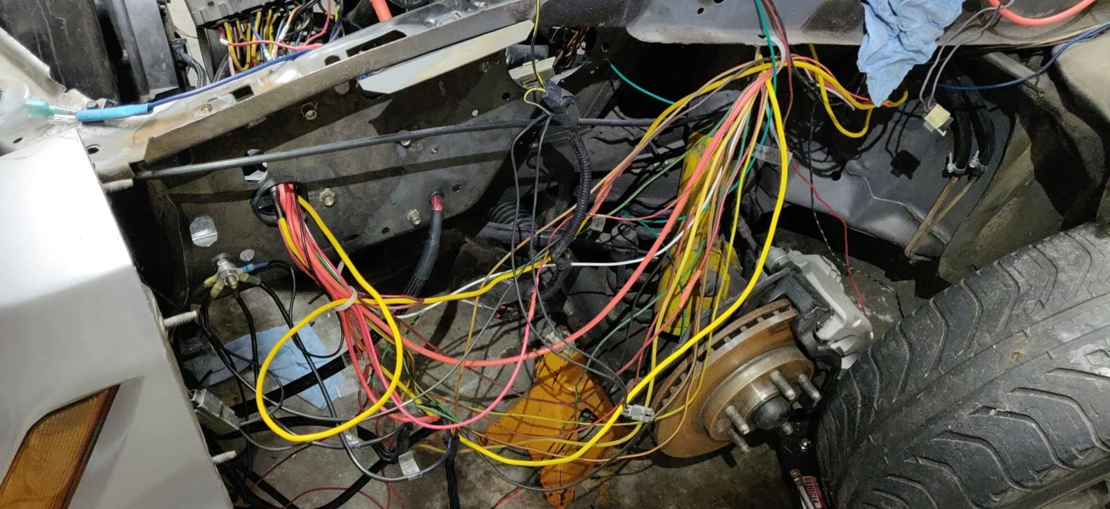

This is what is going to cause the fire!
It's no wonder you dread working on this thing..Whatever came over you to decide to do this? Is this some re-wire kit from a manufacturer like Painless, or did you just happen to have a whole bunch of yellow and pink wire laying around?

I was high. Actually there is one yellow wire that is the factory rear defroster. I only had the other 12g wire in yellow. I have wire labels on all this crap and am making a diagram for myself or someone else. This is largely the mess of factory wiring. There are STILL unused wires in there that went to pollution controls. I think there's more wiring in this factory carb'd car than there is in a 86 EFI car!!!!
The red (or pink because of my led headlamp) wire will be run inside the car, to the fuel pump. I think right now it has a 16g wire feeding it, so I wanted to bulk that up. Or actually feed to the relay then from the relay to the pump.
Actually, this is hopefully, preventing the fire. When I initially unwrapped the rat's nest of factory wiring over by the solenoid I was shocked. The entire bundle of fusible links and the alt feed came together with a load of splices and ended up that ONLY ONE 14 gauge wire was connecting the 130amp alt to the solenoid AND feeding power to the car. I've still got the rat's nest...I'll take a pic of it and show you @CarMichael Angelo .
