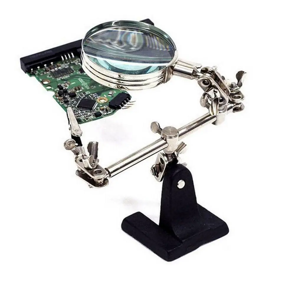

They got something like that at the shop, coat hangers glued to a magnet with a couple clips

General karthief said:
That's a cool 'roach clip' holder. Lets see a pic of the entire set up

That's so cool!
I had to be careful how I worded that, I like my ct.

Blown88GT said:
Yep, I use one of those to "help" in soldering the dashes. You can get them cheap at Harbor Freight
Helping Hands
Amazing deals on this Helping Hands at Harbor Freight. Quality tools & low prices.
That's exactly what it is...except I don't use the magnifier....even though I can't see that good anymore. I put the thing in the vise because it's so light, the wire moves it around. I got mine on Amazon for a couple of bucks.

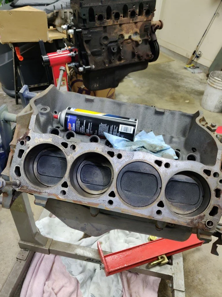

Since I've decided to play with this:
By putting it on this:
Tonight I sold this to raise funds:
What, my sheet metal brake? Yeah I know...but some dude wanted to use it as a 351W shortblock for the F100 he and his 11 year old are building for the 11 year old's first car. Pretty neat.
Anyway, I went to buy this 2 or 6 years ago and got the old guy down to $300. I sold it tonight for $350. What is this voodoo? We all know you can't get more money for parts than you paid, but it happened. I'm running to by PowerBall tickets!

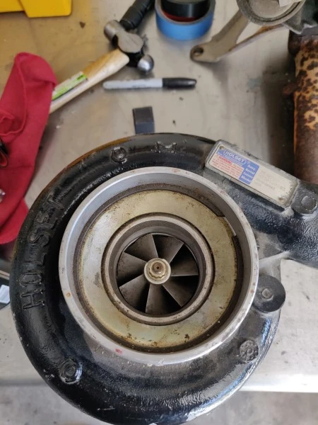

The plan is to buy or make a twin scroll header and bolt the (rebuilt) HX35 on it and see how much boost it takes to lift the head! If I can't sell the car or trade it off somehow for another car or roller, I will sell the engine and T5Z out of it and stick the 2.3 and a toploader (unless someone gifts me a TKO) in the 85 and go to the track and see what I can get it to do. I guess if I want to actually bracket race, I should think C4 with a brake. I do think there's several contraptions that will catch the clutch when you push it down and work like a trans brake....but I'm not made of money. C4 with a brake will probably be cheaper and easier on parts.

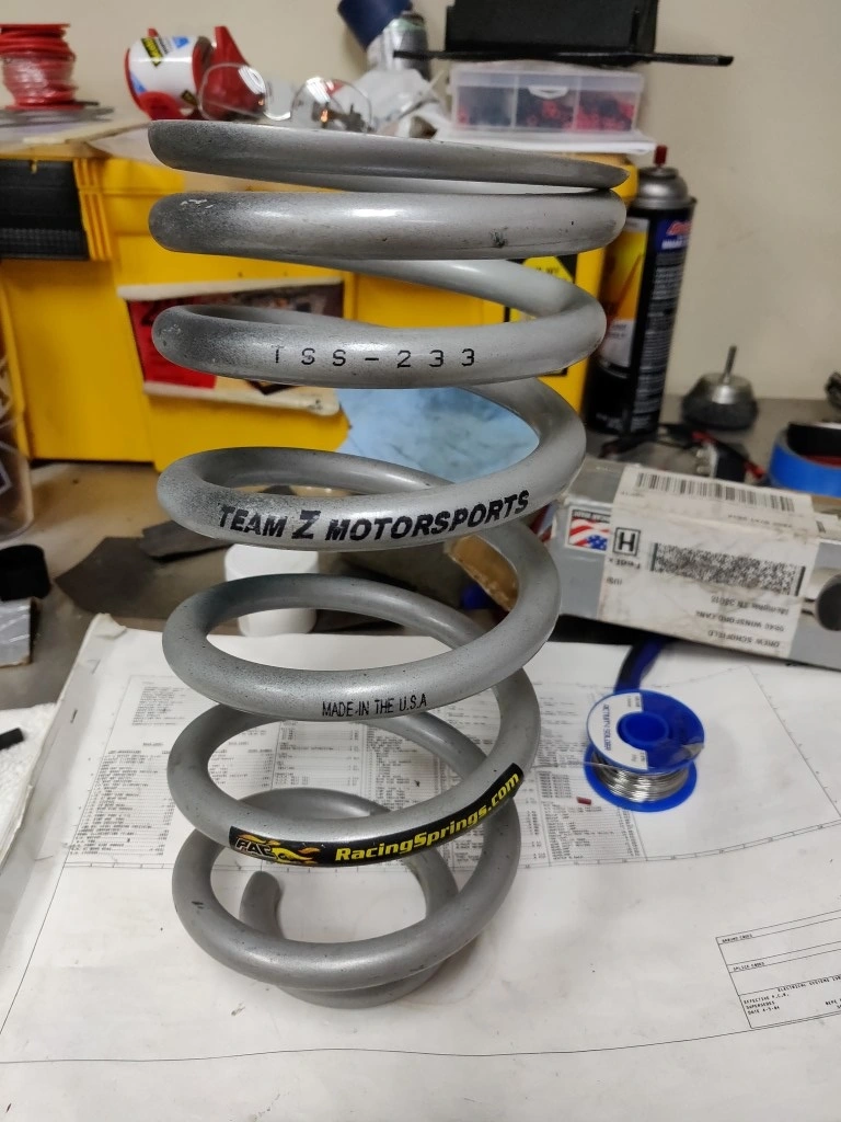

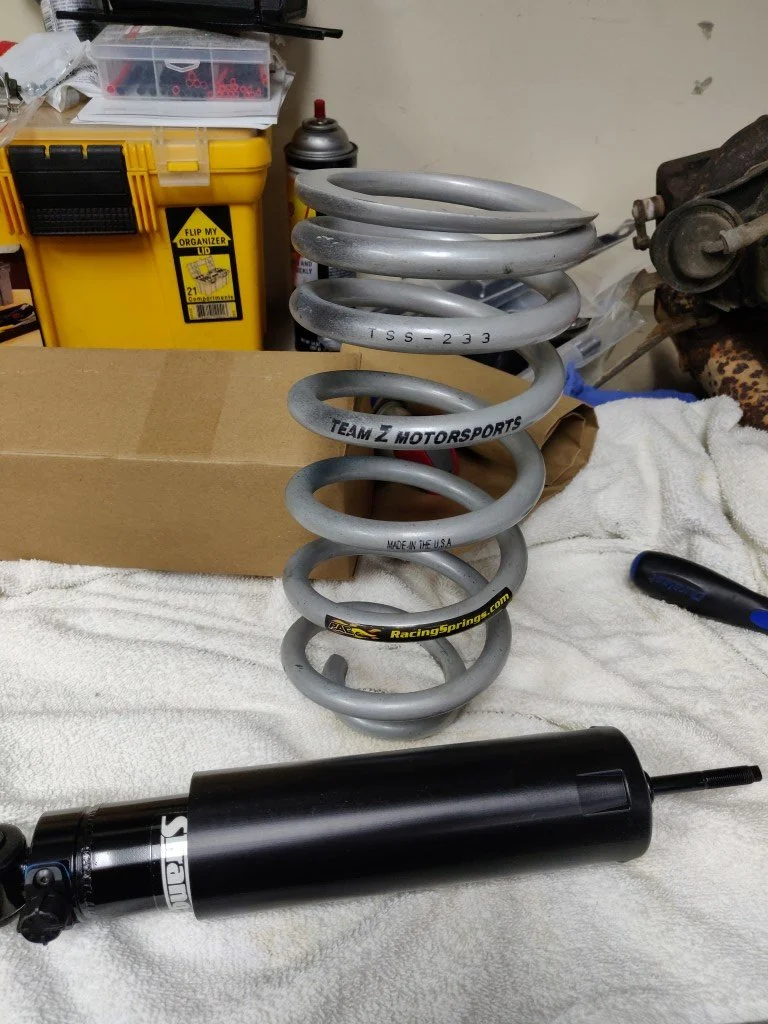

Saw an old local friend today and picked up some Team Z rear drag springs. He upgraded to coilovers because he couldn't get his fox low enough. I have weight jacker lower control arms, so we'll see how the ride height and control arm geometry comes out. I ordered a Strange front coilover kit with 12" 150 springs. I decided to leave the fender off til that comes in and I swap to my Strange struts. I got my wiper tank in I got from Ebay and tested the pump...it works. All the wiring is tied up, wrapped and tested.

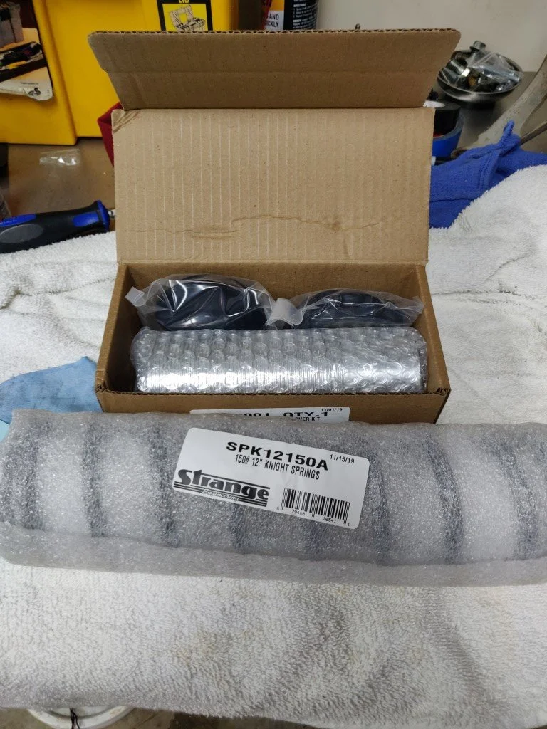

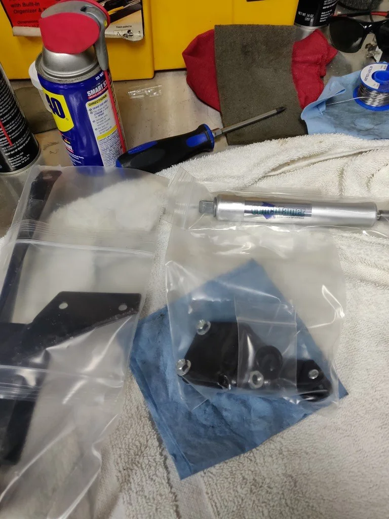

I didn't even realize that my coilover kit came yesterday. I got Strange 12" x 150lb springs. It took me a bit to decide if I wanted to try 12" or 14" by 150, but the consensus seems to be 14" rub on the coil adjuster and some people say they can't get the front of the car low enough. Springs are cheap enough anyway and when I get the 2.3 in, I probably need to drop to a 130 or even less. I also got in the clutch tamer. We'll see how that works out.

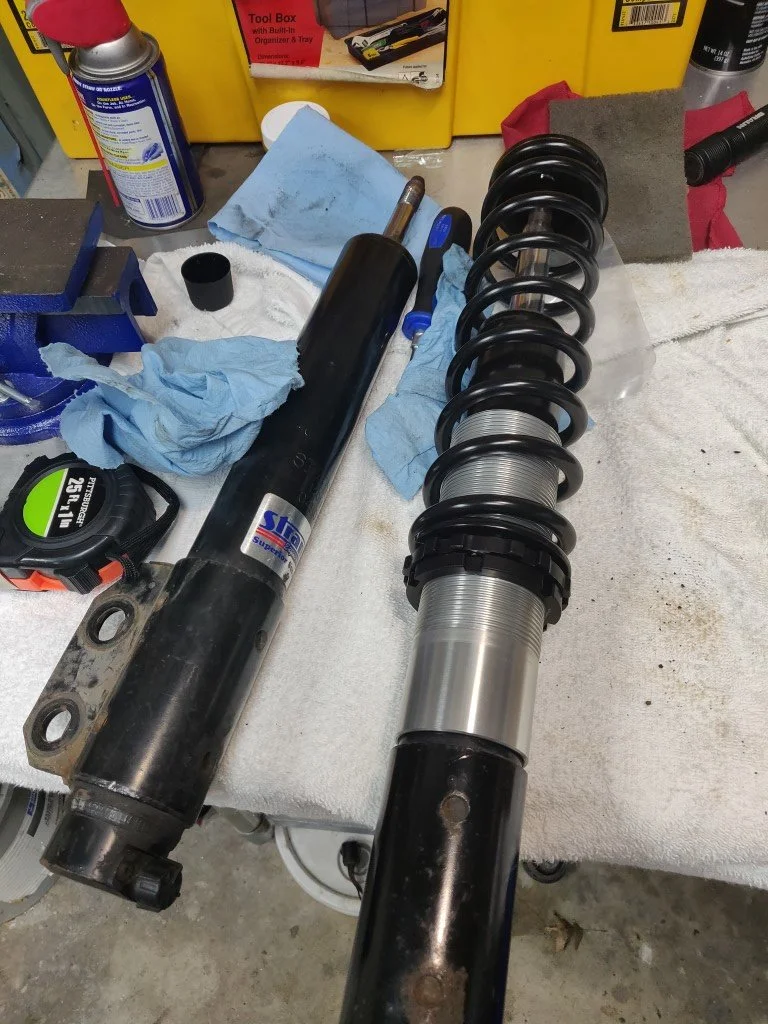

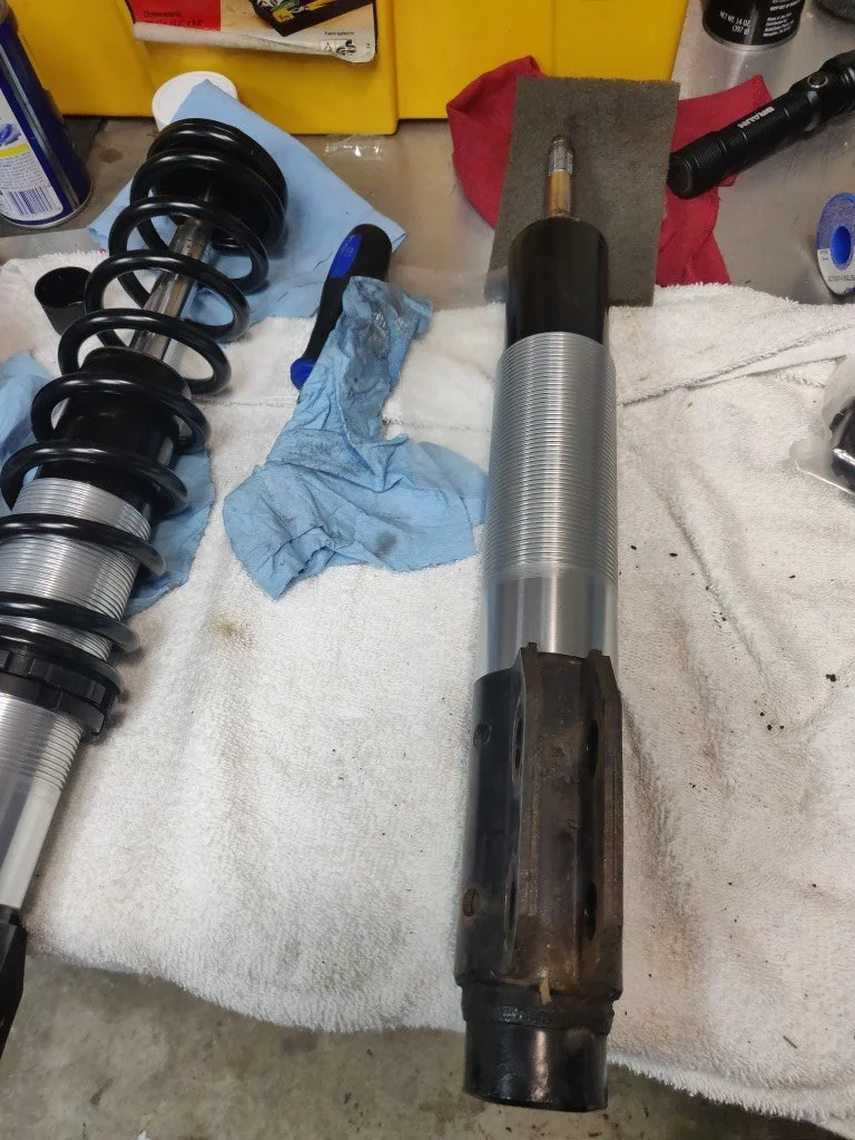

I started to assemble my used Stange struts and coilovers. I need to get new bumpstops and see if I can get dust covers for the struts from Strange, then put them in.

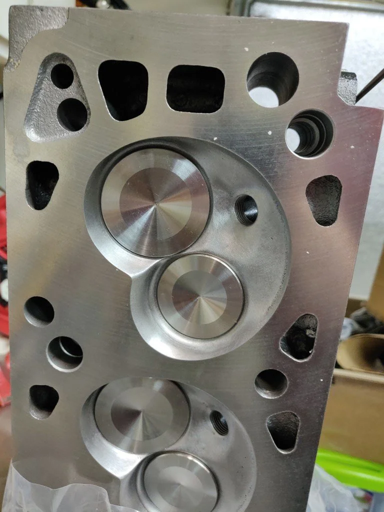

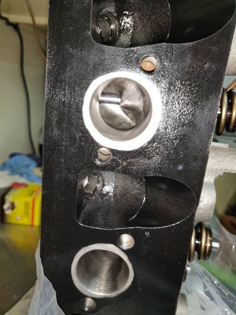

So this happened. I was sucked in by a Bo-Port Black Friday sale. So the whole low buck part of this is kinda going bye bye.
And then with my procrastination to tear into the 85 any further to make it more of a drag car must have been for a reason. I got it approx 10 years ago from the 3rd owner in Knoxville. He emailed me 2 weeks ago out of the blue and touched base. Then asked if I was interested in selling it. The friend of his that he bought it from, was given it by his dad as his 1st car in high school. His dad passed away from a brain tumor and kind of wants it back.
We talked a bit about the whole deal. So he just wants it as a roller. I was under the impression he wanted to restore it back to stock 85 GT. Until he said, no I just want the roller and stick my 418 stroker in it.
So one of the things we have talked about is before his dad passed, he had bought of all things....a 79 Fairmont Futura. And was planning on turning it into a drag car. So I could keep and use a lot of the parts I have been collecting and the 2.3 will go right back in. So there's a possibility we work a trade roller for roller somehow. That would be ok. We'll see where this goes. Maybe I can get it and paint it orange and name it the Iguana or some kind of reptile or something. I heard someone somewhere did something like that.
