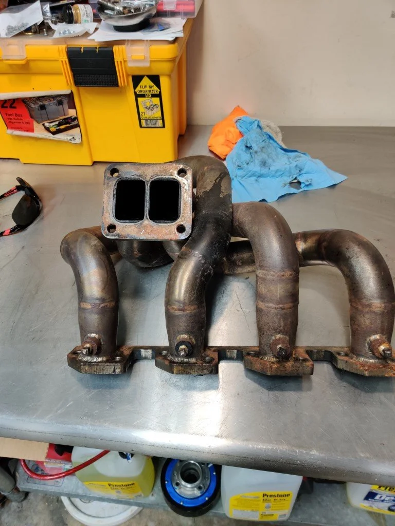

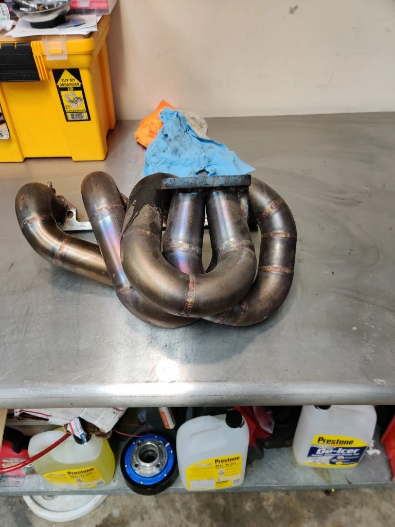

Seriously...I can put some gasoline in the tank and fire this mother up. Before I put the 1 3/4 longtubes on it, I had it dyno'd and it made 275/275 at the rear tires. It ran 9.13 in the 1/8th. After I put the longtubes on, I haven't had it dyno'd but it ran a 8.51 in the 8th. Best passes were both with about a 2 60ft time.
Why is it time to sell it you ask? Well, a box came in yesterday.
Well, besides what looked like a ing brown recluse......that didn't like drinking brake clean from a fire hose.....

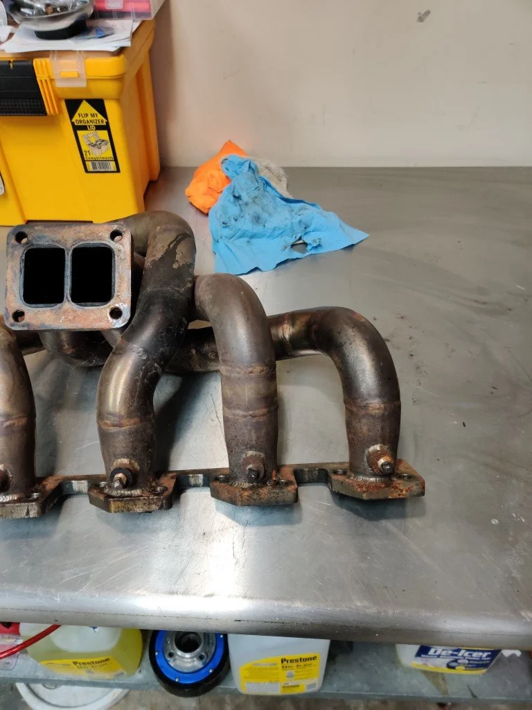

A Beanman SS T4 2.3 header. Well, Drew, your HX35 is a T3. Yeah, bummer. I guess I need more turbo!!!
Or an adapter. But I'm making all kinds of cool turbo and BOV noises in the garage right now!!!!
I also picked up some ARP head studs (which were half price and I didn't realize they were brand new!) to hold all this boost in.
Dude that wants the 85 back is building a house, so that's on hold. But I am going to put the 2.3 in the 85 and go to town, save for any cutting and welding on the car. I think the Futura has grown on me....and I've been steadily snapping up more Fox suspension stuff. About to make an offer on manual rack and brake setup that's local. So I'm going to reach back out to dude and see if we can work something out on the Fairmont. He has a bunch of stuff that I may not want, but could sell to recoup some cash and he wouldn't be out any cash.
Big things were a fully built C4 with brake and about a 5000 stall converter and a Fab 9 housing with no ends or brackets. I could use the C4 but it wouldn't be as fun as driving a stick.
But if I want to bracket race this beotch, that's where it is at.

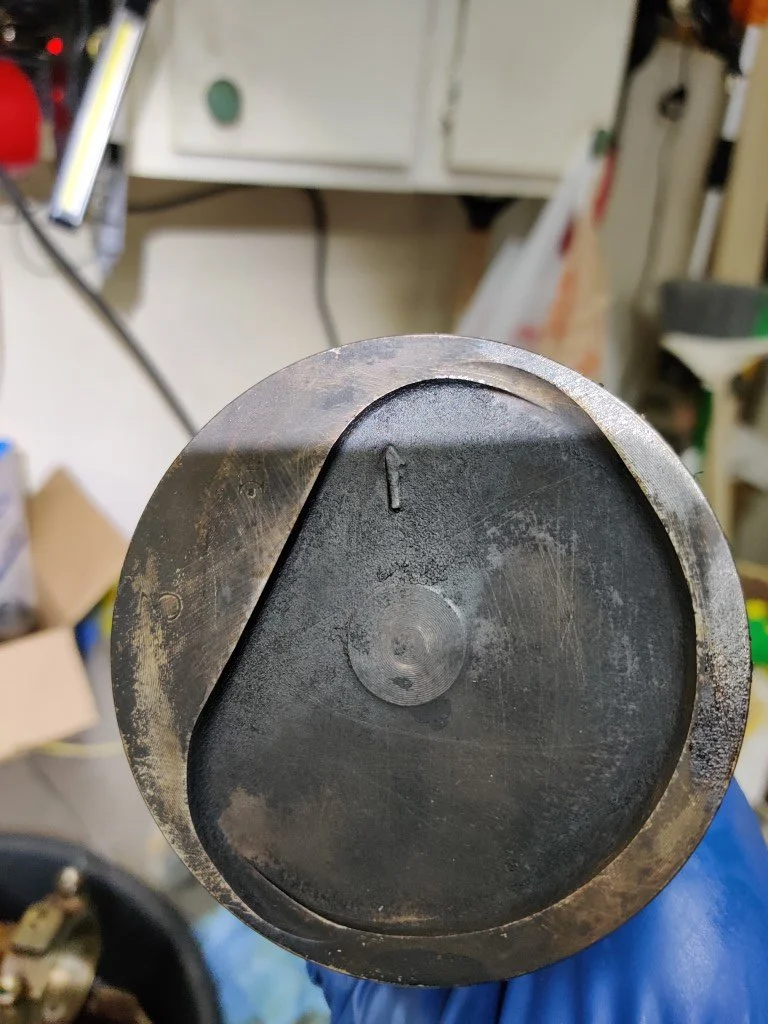

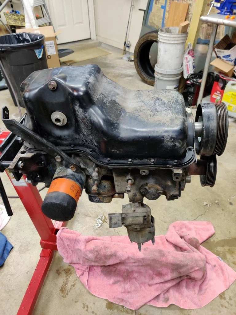

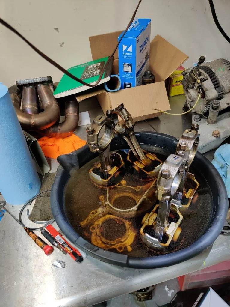

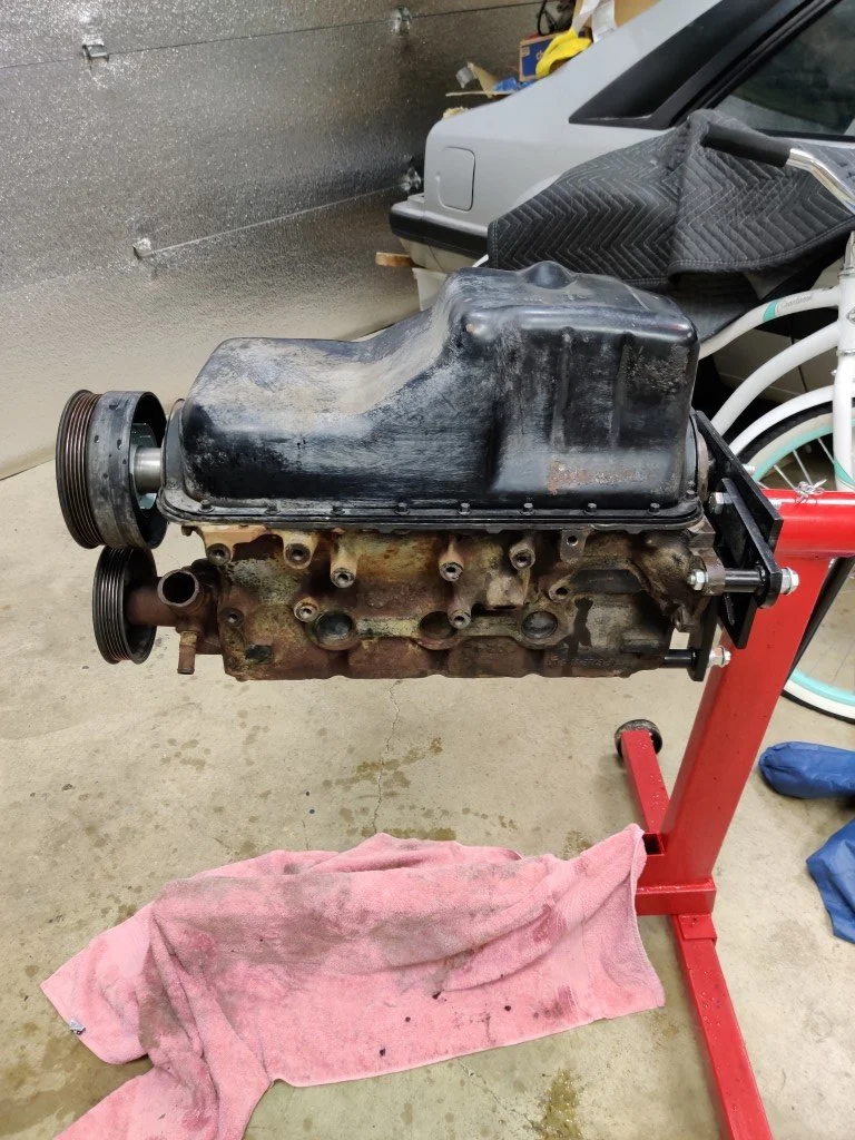

Since I haven't done since November when the weather cooled off, I figure it's about time to get started again and sweat to the oldies! I think I am pulling the 302 and selling it. I'll put the 2.3 in the 85. If the guy comes back to me and still wants it, we'll work out a deal. Time to start figuring out the plumbing. Even if we swap and I get the Futura, all the plumbing will transfer over.
I've seen a lot of guys on the 2.3's take the upper intake, cut off the flange and rotate it 90 to it faces forward to make plumbing the intercooler easier. I've been thinking about making an adapter for the lower. It's basically the same opening size as a 4150 with a wildly different bolt pattern. So I was thinking, make an adapter then use a standard 4150 style throttle body elbow. The elbows are pretty cheap and so are big throttle bodies.
I've paid $100 to get the lower ported. S'posedly it's good for 500 hp. If I exceed that and decide to stay on the 2.3 path, I'll fab...well, I'll get my brother to fab an intake.
So today, time to clean this dirty pig. 2 cans of Gunk spray cleaner later and it's workable. I'm stopping to eat lunch and then I'll pop the pan off and see what is inside. Yes, 4 rods and pistons and a crankshaft. I need to buy or borrow a press so I can swap pistons onto these other rods I bought that already have been resize with arp rod bolts and polished. Pick up some rod and main bearings, check the clearances and put it back together.
I'll probably dingle ball the cylinders and get a new set of rings. I've debated making a kickout for the oil pan to get a little more oil capacity since I am going to fill the block to about 1 inch of the deck and know it will run on the warm side. But Speedway has a couple of circle track pans with trap doors pretty cheap...so rather than deal with a leaky homemade pan, may just buy one. We'll see when I get that far.

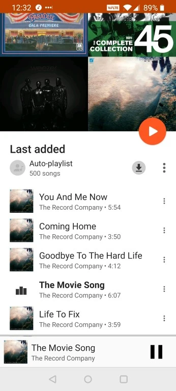

Also, if you've never checked out the Record Company. Do so. Now! I had never heard of them and saw them in a club in Nashville 2 or 3 years ago and was BLOWN AWAY. 3 piece band that rocks their asses off.
Yes that's a bath towel. I prefer the soft scent of Downey on all of my engine parts!

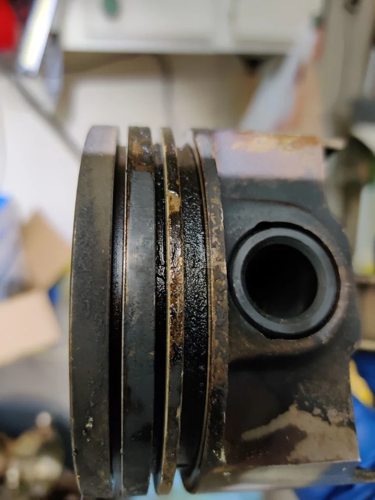

Yeah, the Folvo seems pretty easy to do. I've spent more money on this than I ever planned when I fell into a Black Friday hole and ordered a ported head from Bo-Port. BUT, it was on sale.

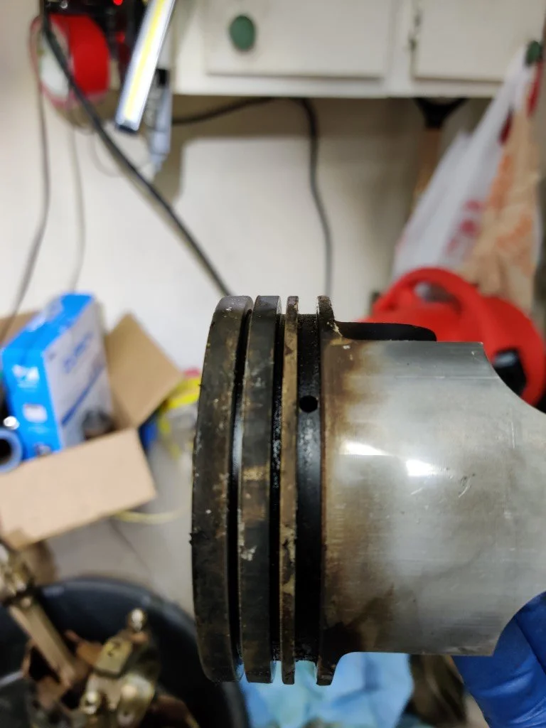

I'm guessing someone was into this before and decided if a little top ring-ring gap is ok, A LOT is better! It has about .040 top ring gap and .020 2nd ring.
I couldn't find my bore gauge last night and I was tired. My Mother in law arrived from LA (Lower Alabama) yesterday. My wife drove halfway to Scooba, MS to meet her sister and make the trade. MeeMaw has some mild dementia going on and the sister n law and her were about to come to murder. So Meemaw is with us for about a month. Pefect time to make a trip like that...in the apocalypse lockdown. She was calling all of her peeps up here and trying to get someone to take her to church today. I guess she didn't believe my wife or the sister n law who told her, when you get to Memphis, it's on lockdown. Churches are cacnelled. No one can get out unsless it's to the doctor or store. So she had to sit here last night ON SPEAKERPHONE yelling to all her peeps. I went and worked in the garage with my Chinee AirPods in.
I might just spend some more money on this. I found a 2.3T shortblock that's got less than 1000 miles on it with a fresh bore, forged pistons and aftermarket rods. He wants $500 for it but it's been listed for at least 7 months. So if I can get him down under $400, it will probably be mine.
I guess it's time to get out in the garage before MeeMaw gets up. But she's like a teenager...she stays up all night watching tv and sleeps til noon.

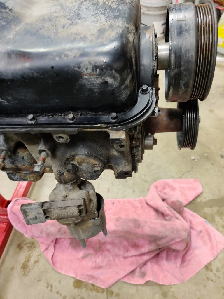

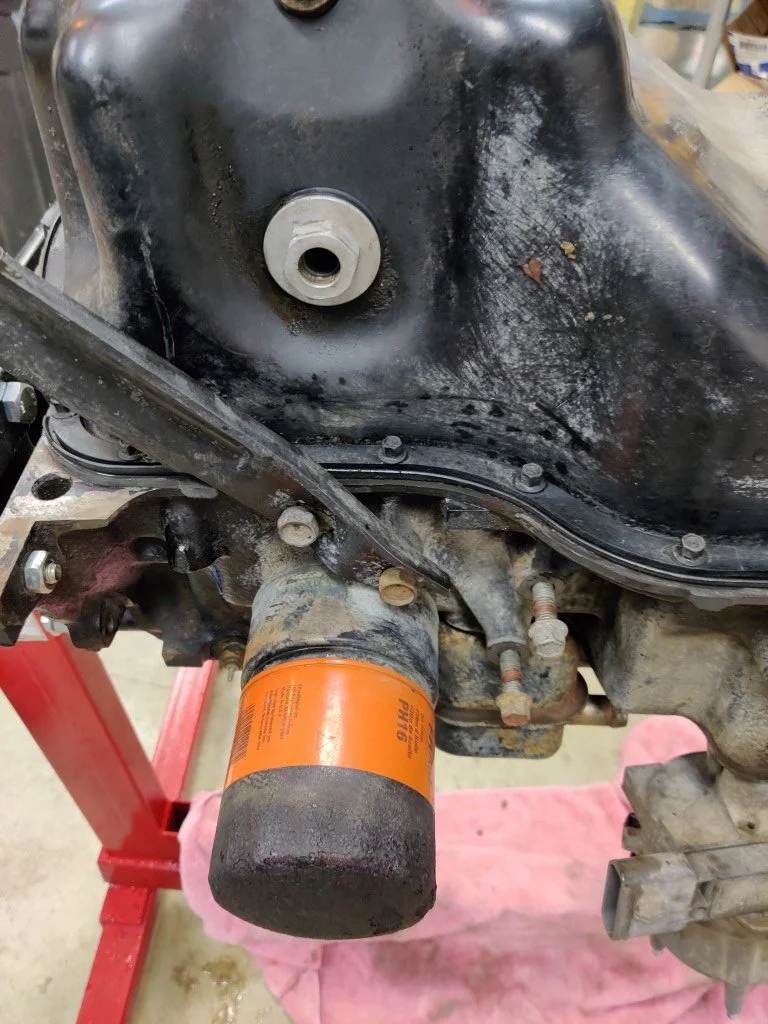

Fresh shortblock is in Maine or Mass now. Oh well. This one is in good shape. Original Ford rod and main bearings in decent shape. Some minor scoring on one of the rods. Number one piston is sticky on the pin. I've got to clean the pistons up, as the rings were a bit carboned up. Looks like maybe some cheap oil or extended oil changes. Other than that, the bores are great. Dingle ball, swap the pistons to the polished/ARP rods, new rod and main bearings and snap it all back together.
AFTER I get the damn crank gear off. I'm trying not to damage the aluminum front seal holder, but the cut off wheel is about to come out. Good excuse to get rid of the stock one and go with a round tooth belt and adjustable cam gear.
I'll get it apart tomorrow, remove the oil pump and wash the block again. Order some rings, bearings, gaskets and put the shortblock together.

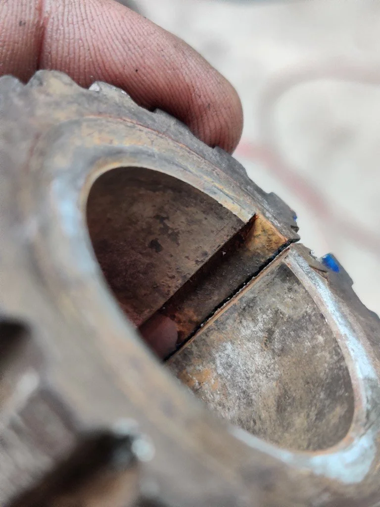

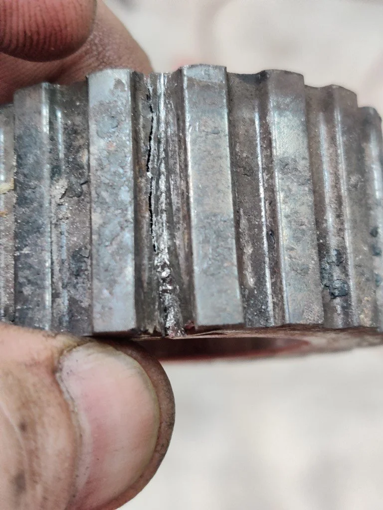

Monkeytrucker....the crank timing gear was a total beotch to get off. If you're not familiar with the Ford Lima Pinto 4 holer power terrorizers, there is an aluminum plate the bolts on the front of the block and holds the front crank seal. And it totally prevents any useful tool from accessing the timing belt sprocket. Of course Ford had a special tool for it, but I don't have it.
So I finally just go the 3lb sledge and a cold chisel and bent it to my will. Several (dozen) hard wacks and it cracked and fell off.
I gave the block another good bath, WD40'd the cylinders, and tapped the head bolt holes. Tomorrow I'll chase the waterpump and some other holes. I ordered rod bearings, main bearings, and the aux shaft bearings, a gasket kit, and some misc stuff from RockAuto. Need to bust down to Harbor Freight and buy a little press to swap the pistons over and see if number 1 is salvageable. It's sticking on the pin.
Today it was all about beating the out of that gear until it (literally) cracked under pressure. As good of a reason now to upgrade to an adjustable cam pulley with a round tooth belt.

Wasn't a pretty sight...and I've got big hands

The one in my ranger slid right off. Good thing you thought on you toes. I would've never thought of that.

I tried putting a wide flat screw driver in between the block and gear then driving a chisel in, but that didn't work and I was worried about marring up the crank snout. I can't take credit for the splitting idea. I read it on Turbo Ford. It said they usually can be persuaded to pop off with a little penetrating oil and maybe a little heat. But one guy said he had been a Ford tech and if that didn't work, just split it with a chisel. Evidently that gear is pretty hard and brittle.
Also, damn, the camera on the OnePlus 7t closeup mode FTW!

Anyway, I bought the little 12 ton press at HF today so I can swap the pistons over. But they are pretty carboned up. I don't have any of the good old toxic, cancer causing carb cleaner to soak them in. So I looked on good ol Amazon and saw this stuff called Piston Kleen. We shall see tomorrow if this is a great name or false advertising.
I am soaking the pistons, the aux shaft seal plate, the crank front seal plate and the aux shaft. I threw the other stuff in mainly for more mass to get the level as high as the entire piston.
Also, I really love RockAuto. If you're not dead in the water, the savings they offer on name brand parts is staggering. I ordered a wild array of parts this week: main bearings, rod bearings, aux bearings, 2 head gaskets (might as well have an extra when I send ALL the boost), gasket set, oil pump, oil pump drive shaft and a water pump. The prices were awesome and the shipping was cheap too. But I can't help but wonder if having all these warehouses costs them money.
