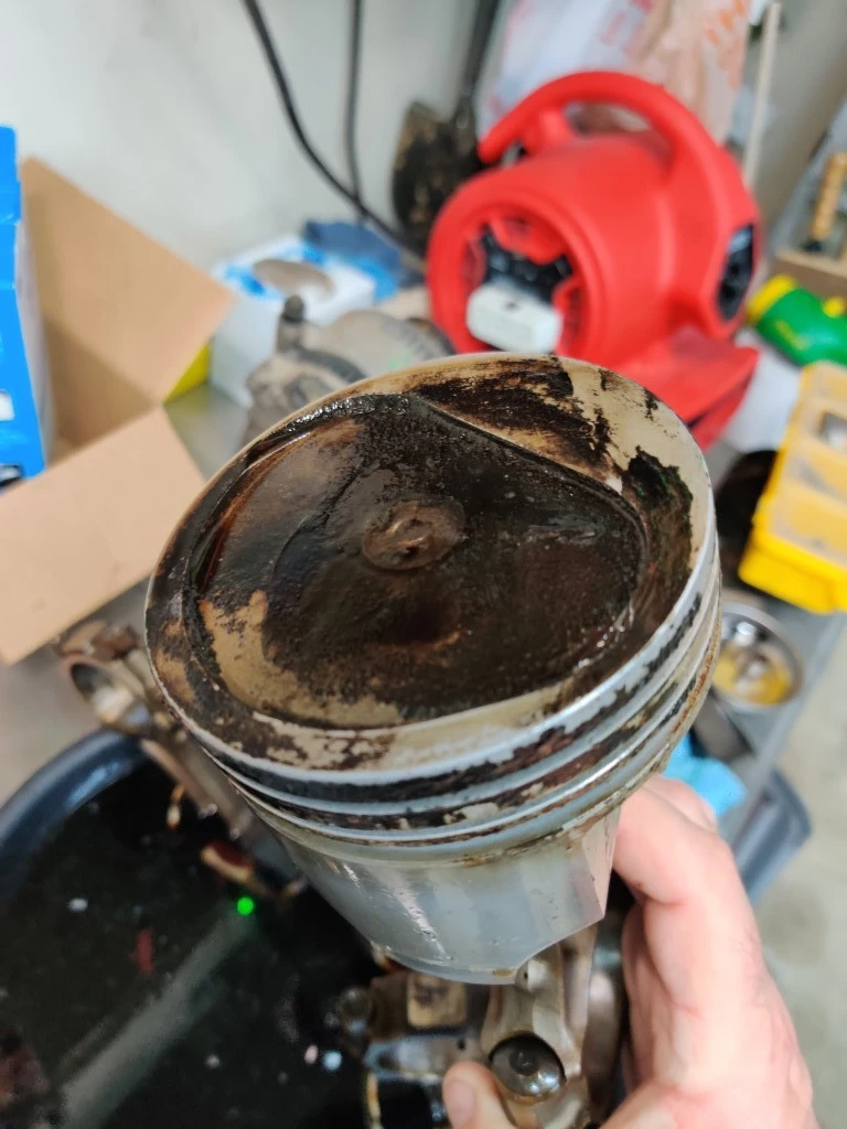

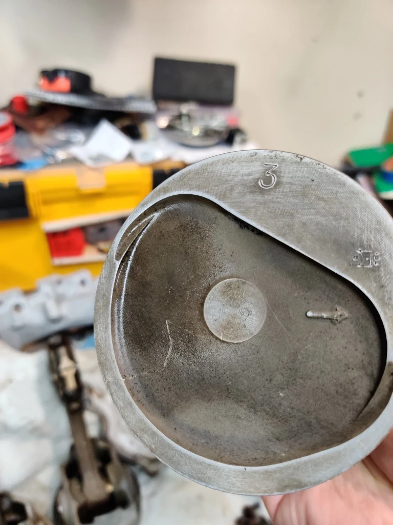

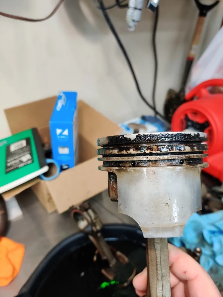

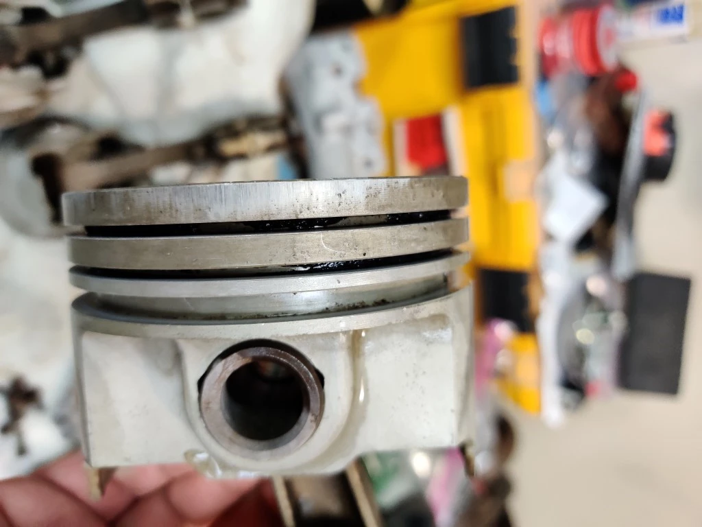

Well, kiss my ass, this biodegradable stuff does work. This carbon was pretty crusty. Soak it in Piston Kleen for about 14 hours and it pretty much just wipes off with a soft nylon brush. I then washed them off and pressed the rods off the pistons. Some of the pins were a little discolored but I took some 800 and 1500 grit paper and polished them up. I dunked the pistons back in to get them a little cleaner and to clean the ends of the pin bores where there was some build up. I'm guess cheap oil and/or long change intervals. This will be good enough to press onto the reworked rods for 2.3 version 1. My 12 ton HF press worked like it should, went together like it should, so I can't complain there.
Amazon brought me a ring groove cleaner this week, so I will get the last bits out once this second soak is over.
Let's see some testimonial photos, shall we?

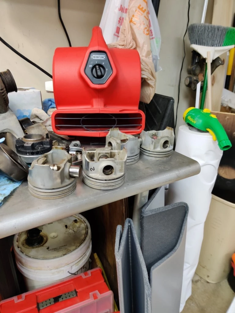

A boosted engine needs forged pistons, so I am reusing the stock ones. BUT putting them on a set of resized/polished rods with ARP hardware. Great idea 1.
When you give an engine ALL THE BOOST the ring seal is important. If the cylinder walls flex you lose seal and power. So you fill the water jacket with Hard Block or concrete. And then you machine the cylinder in case there is any hydraulic creep of the cement when it hardens. Nope, I'm got my super accurate ( ) chinesium Amazonian bore gauge and will measure with a high degree of inaccuracy if there's any change in the bore when the concrete hardens. Great idea 2.
But I did spring for a Bo-Port stage 3 ported head. I'll be getting a Bo-Port stage 3 cam and already have the beehive spring upgrade for the cam. I've got a HX35 turbo and recently got the dual scroll header, but it's a T4 flange. So I am going to have to use an adapter. I'll keep the T4 flange so when I realize the HX35 won't supply ALL the boost, I can step up to something huger!
I'm sure I'll do more things with the right intention the wrong way.

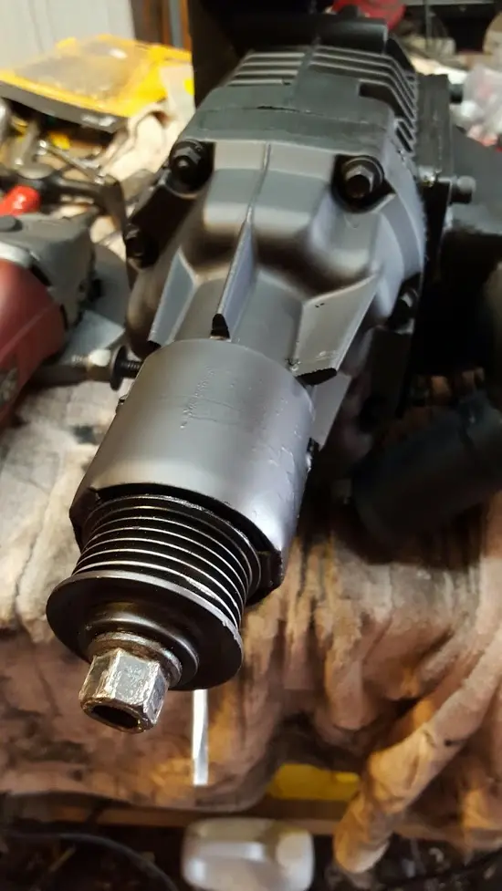

I have a heavily modified m90 you can have. Pay shipping.
Feed the m90 with the turbo.

I always took a stock ring and twisted it around and used it to clean the ring lands.

Yeah, I actually finished cleaning the ring lands with the old rings. They clean better than the tool designed to do this.

droopie85gt said:
Color me intrigued. I've seen over on TurboFord where that guy was actually using an M90. And then I went here and read til my eyes bled and my brain hurts:
https://www.eng-tips.com/viewthread.cfm?qid=174690
Seems to be a good way to go if you can handle the math, logging and testing. My effort will be a drag car, but I am kinda dreading the fact that it will be a turd of about 140 hp until it spools which may be at 4000+ rpm. I wouldn't mind tagging and driving the thing but what a dog on the street it would be. BUT a blower fed by a turbo.....got pictures of that thing and what you did to it?
And what it would cost to ship to 38018? What's another box to stack in or on top of the Mustang.
Let me get some pictures of the monstrosity, the snout did end up getting damaged so I had to improvise by making a quick collar sleeve for it. you could easily replace it cheap. The case was cut apart and epoxied to make the inlet as large as possible, if you followed my build thread this thing was feeding a 5.0 before I moved up to a m112 off a jaguar. oh and I have a slew of pulleys for it you can just have.
I found this one on my pc, ill get more if this does not scare you

Doing wrong things the right way. The piston pins were really sticky and notchy in the pistons. I don't really want to spend $1000 bucks on rods and pistons and get the engine bored. So I wrapped some 600 grit around a deep socket and basically lightly reamed out the pin bores. They are good to go now. Looks like this engine was run hot, low on oil, or long interval oil change. I've got the pins labeled and put in the freezer. When it's time, heat up the rod and pop the pin in quickly. Filled the block up to the temp sensor hole with Moroso block fill. When it sets, I'll get out the bore gauge and see how much, if any bore change there is. If it is too much, I'll bite the bullet and buy a set of pistons...and rods..if I am going to spend $400 or $500 on pistons, plus have it bored, I'll get some aftermarket rods and build a 550hp capable bottom end.

What size crank pulley does that engine run? With a 6.625 crank and a 1.6 pulley on the blower the m90 was capable of 10psi on a 5.0
