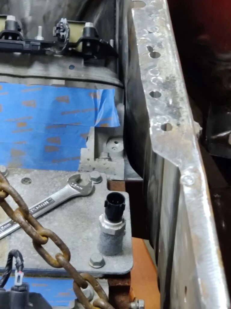

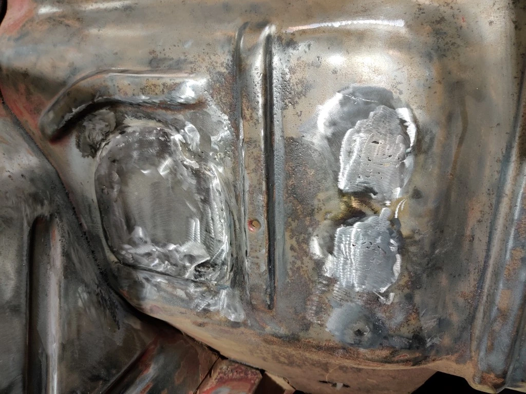

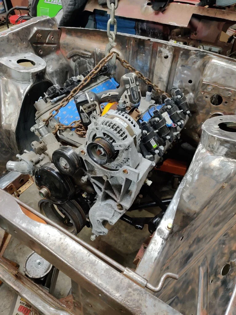

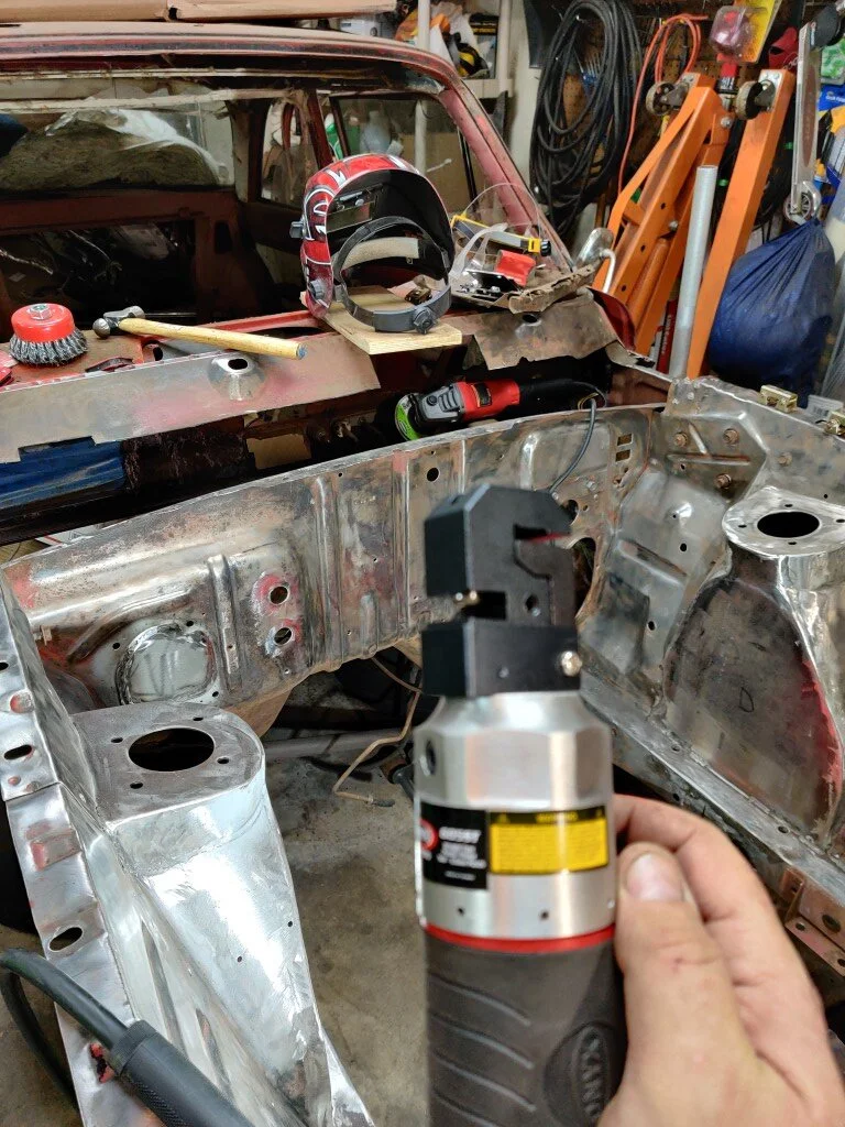

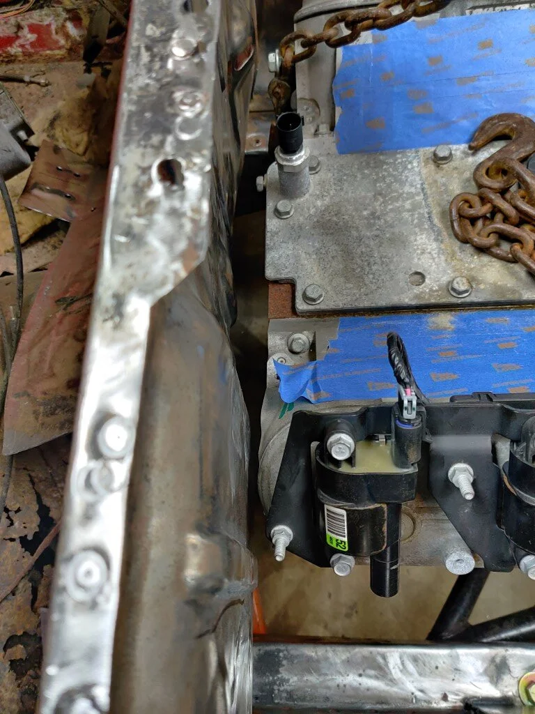

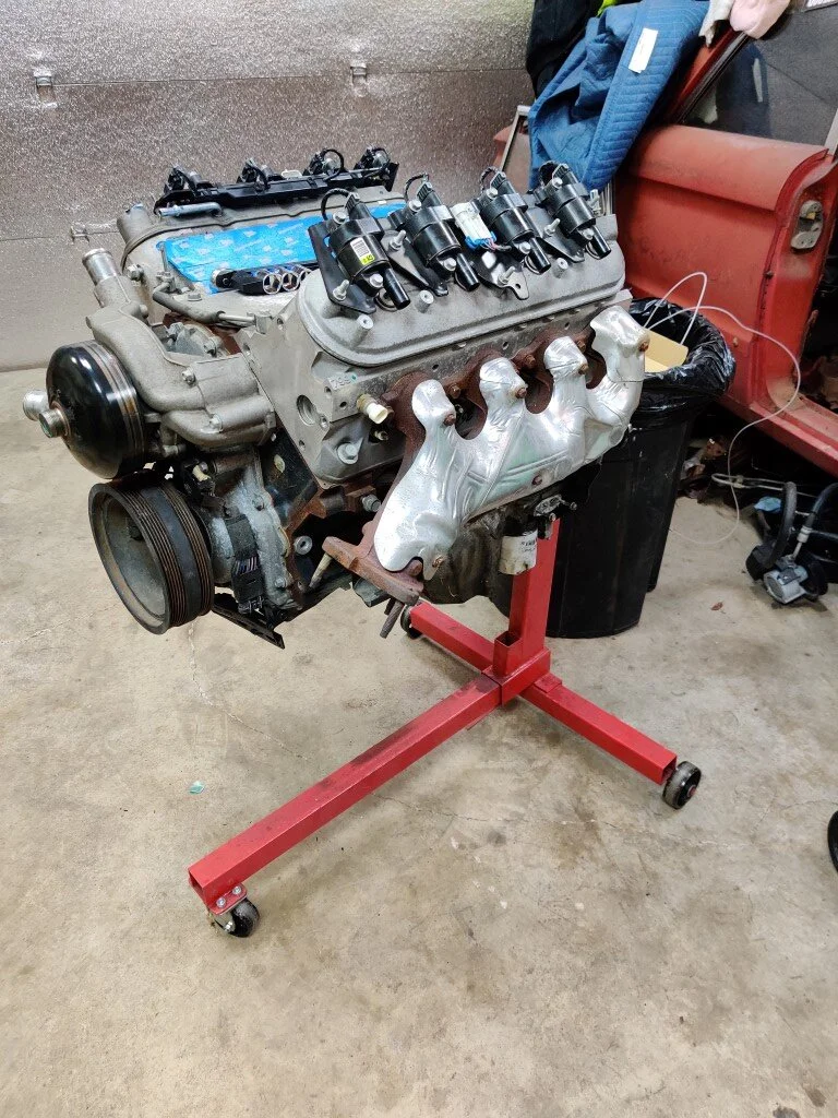

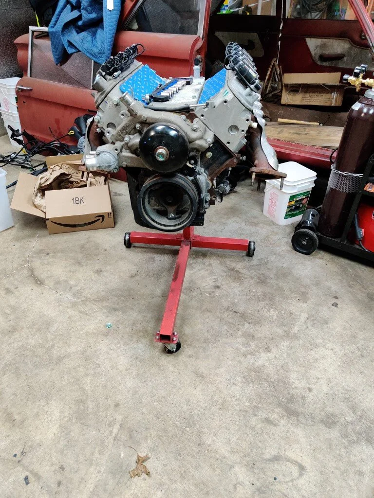

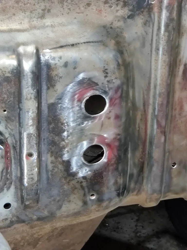

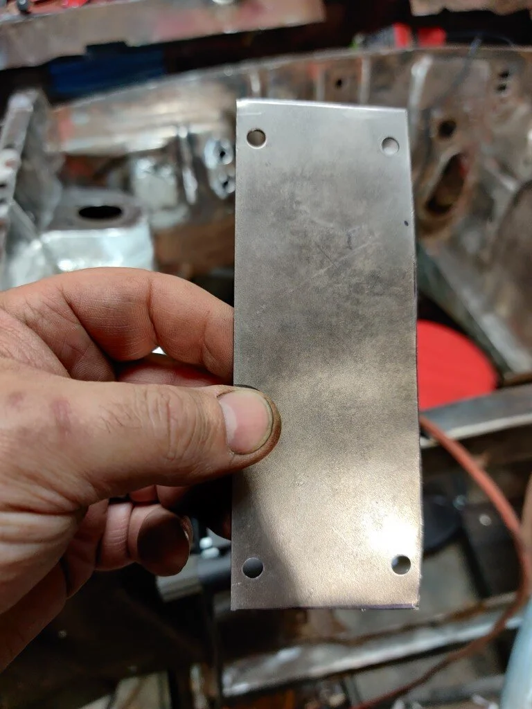

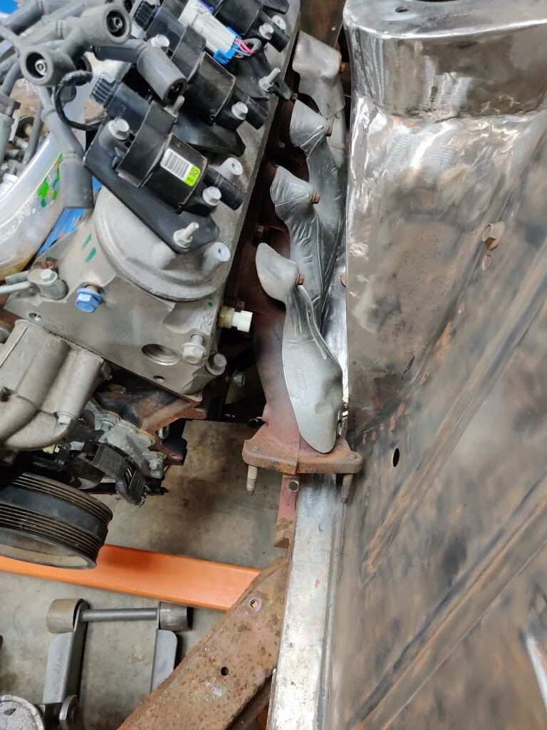

I was off yesterday and my brother is already texting Wed night when am I test fitting the LS. I said, well I'm off Friday so I'll prime the engine bay, but then I realized I still had holes to fill on the heater area. So I ground off the 'nipples' sticking out for the heater hoses and made a backer plate. I used my new hole punch/flanging tool. Punch holes, rotate the head make flanges. I figure that will come in handy for the floor pans and if this beotch is getting a 4L80, it's going to have to have tunnel surgery too.
I probably should have made backup pieces for the larger holes that held the blower motor in, but I just used a copper spoon and filled them in. I used a grinder with a flap disc and an air grinder with an 80 grit 2" disc to get in the tight spots, which is still hard because of the ribs and the raised area the blower motor mounts on. It's not perfect....my grinding technique needs more practice, but the air grinder really helps. My Kobalt compressor barely keeps up with it. I may look for either an empty tank or another cheap FB compressor to hook in series to help out.
I finished the night with (maybe more than 1) ice cold draft Modelo Especial!
Today, I plan to put the K member back in and test fit the engine before I prime it. I figure swinging the engine in by myself I may beat the engine bay up, so I'll wait to prime another day...maybe tomorrow.
