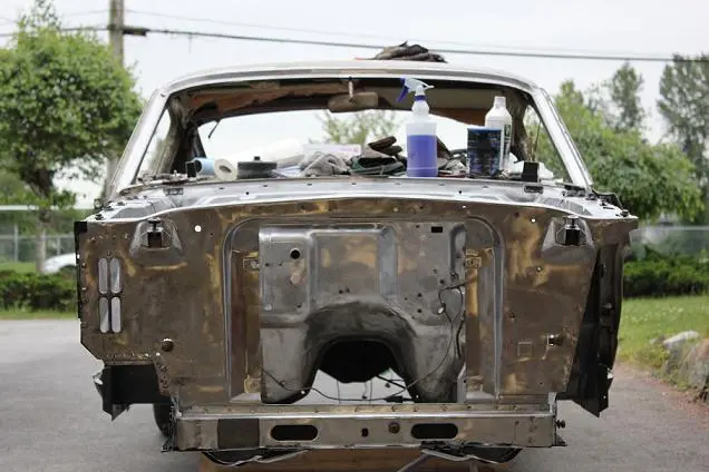

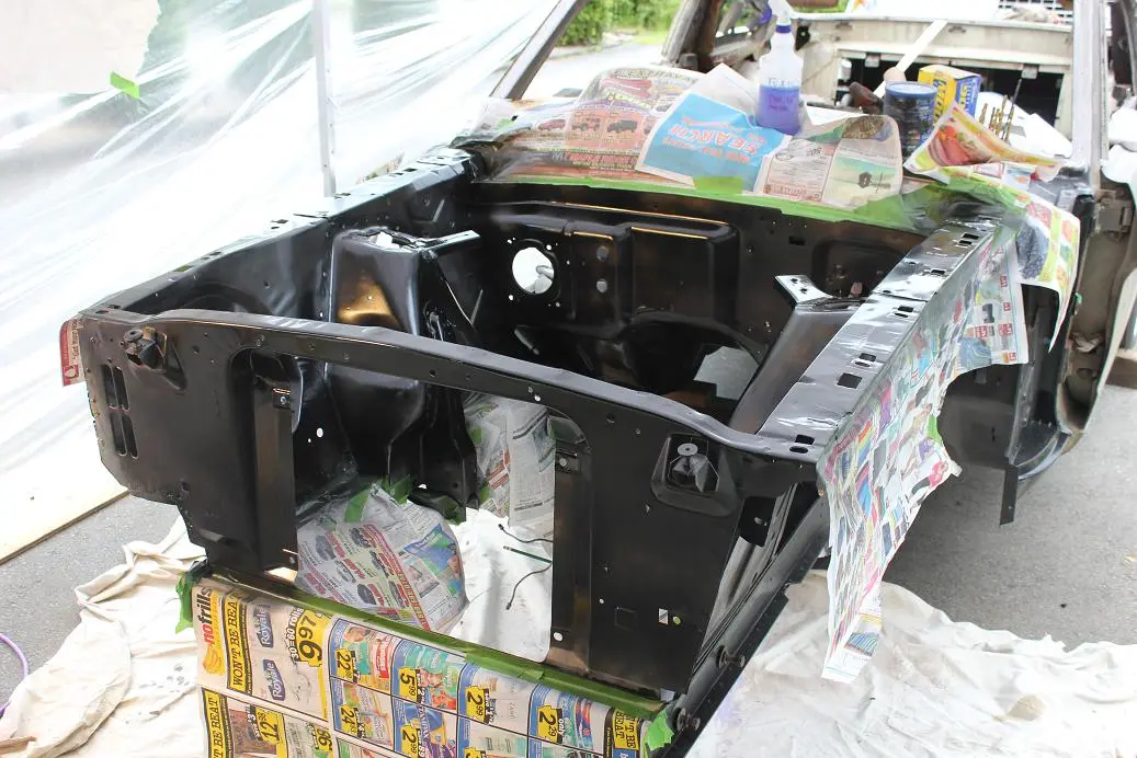

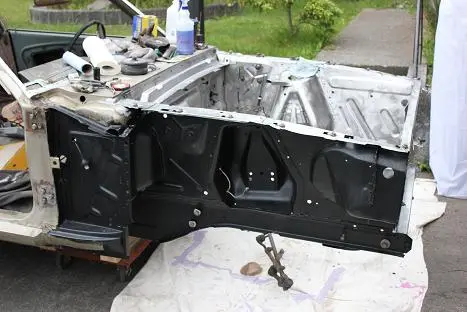

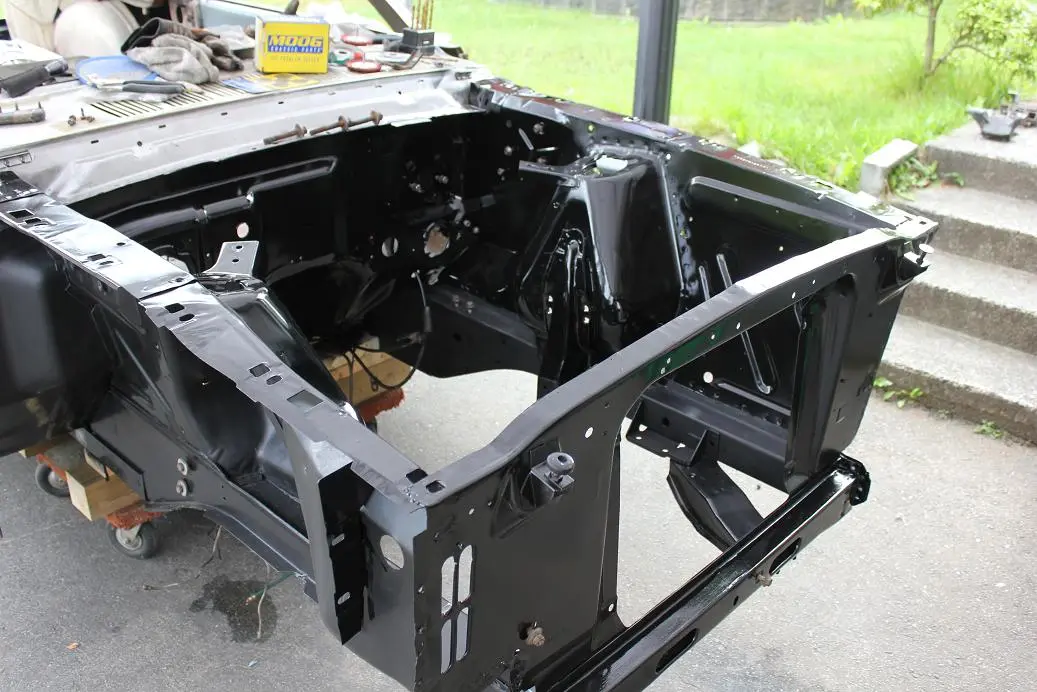

I'll post some motor build pics as I start building it. here's the front end when I was prepping to spray the engine bay. Before and after. The whole front end is new including disc brake conversion, quick ratio steering box, upper control arms dropped 1" like Carroll Shelby used to do on the early GT-350's, 1" sway bar, 620 coils, everything new or rebuilt.
