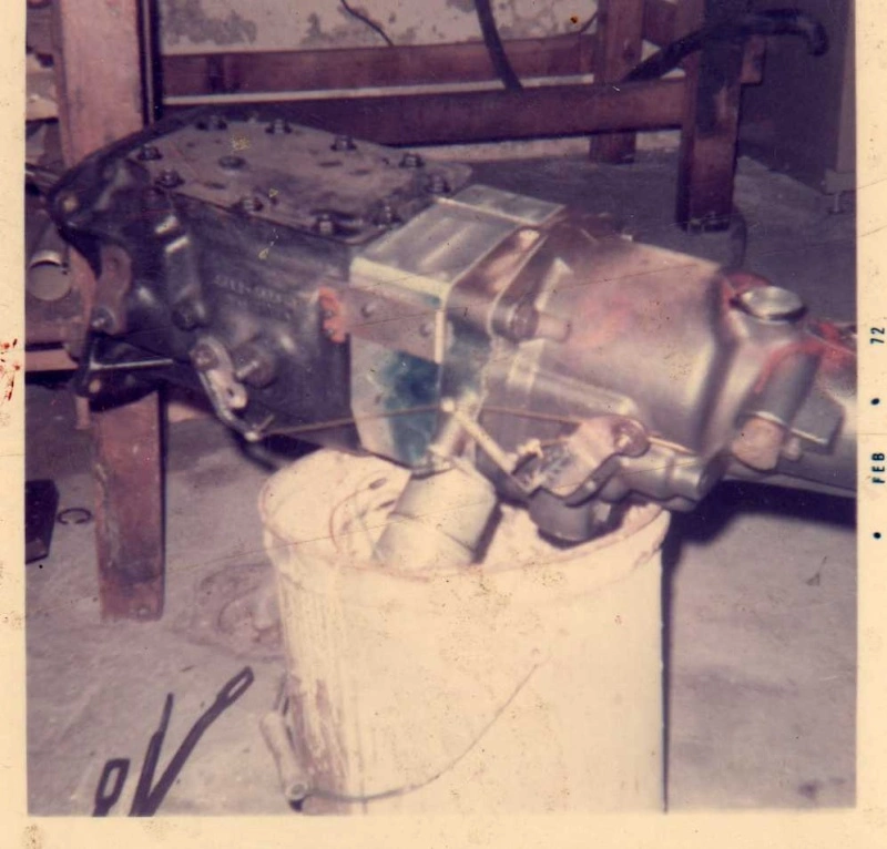

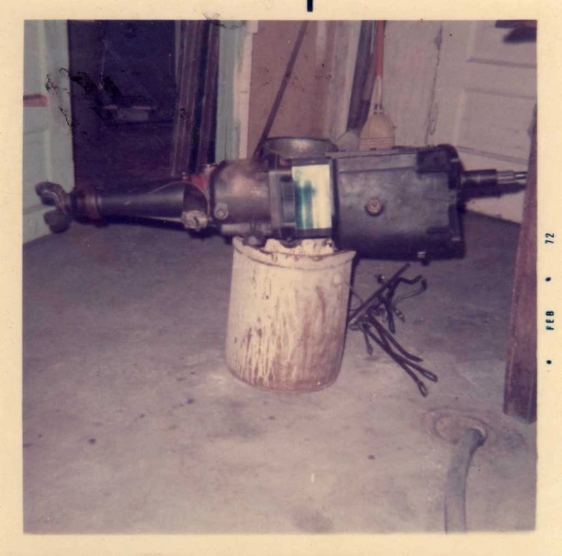

Gosh, if ONLY the T-5 had been around when I spent all the time and effort to adapt a Borg-Warner H.D. Overdrive to my Ford Top-Loader 4 Speed:
This was ca 1968 or so, the combo went into my '65 "K" car, bought new. Most difficult part of the "transfusion" was mating the Top-Loader output shaft to the Warner input. Pulled it off with a welded-in sleeve of high-alloy, having bought an output shaft from Ford, wanting to not destroy my original, just in case. Worked well. Crossed the US with the beast many times. imp
