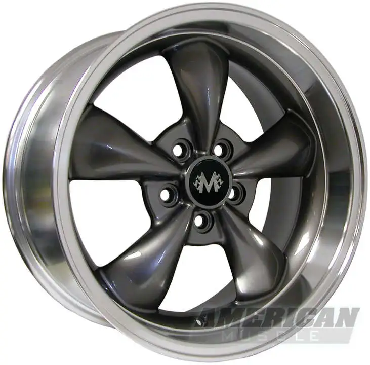

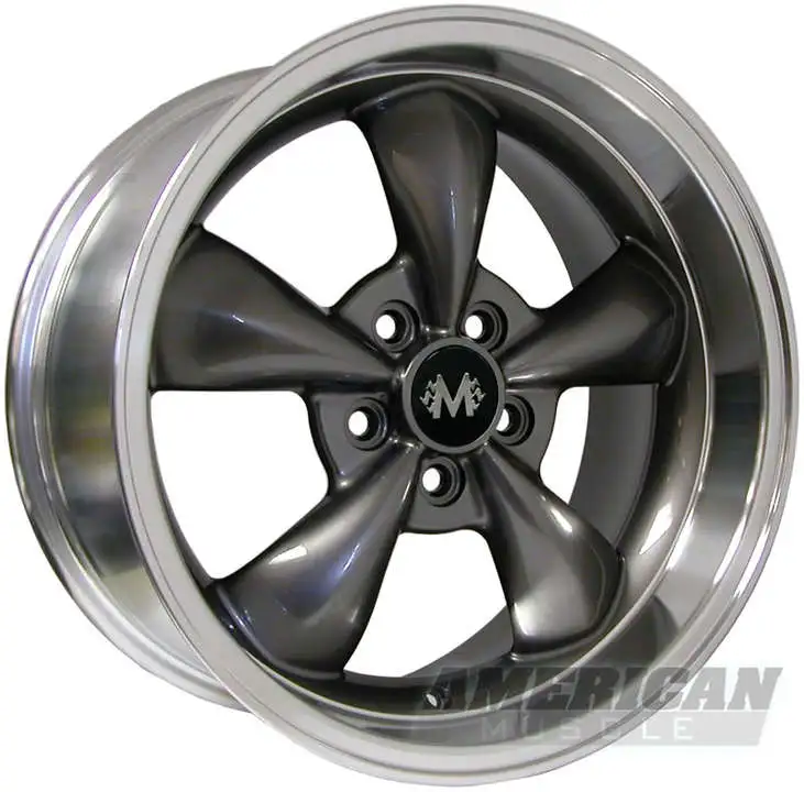

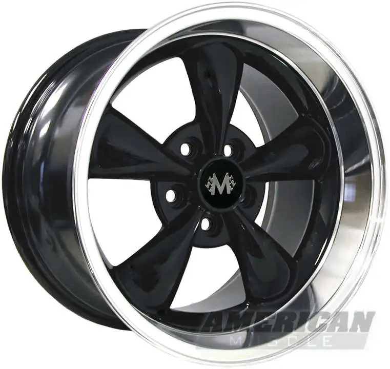

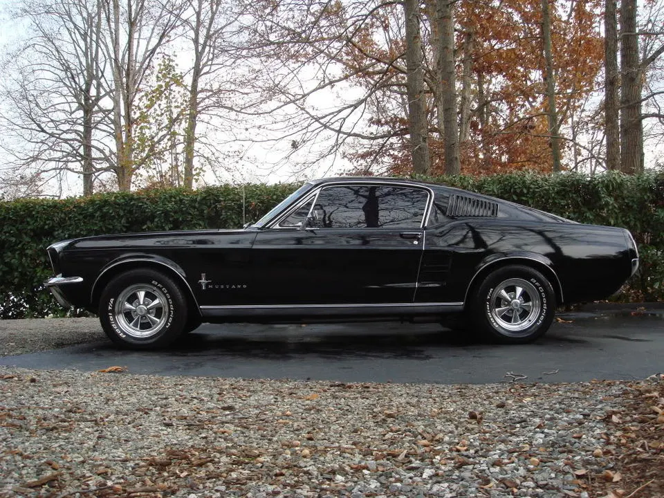

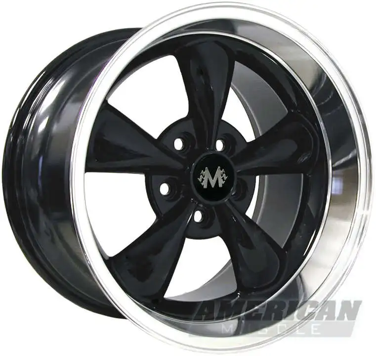

I plan on doing 17x8's in the front with 245/45-17 tires, and 18x9's in the rear with a 275/35-18 tire.
However I am stuck between these two wheel colors, so if you guys don't mind helping me pick which of the two would look the best on my car.
Thanks,
Wheel 1:
Wheel 2:
I'm not sure if there will be a huge difference, but then again the devil is in the details. I'm definately partial to the bullits with the dark centers. I think I'm leaning towards the black, maybe there are some photoshops wizards that could photoshop each wheel on your car.

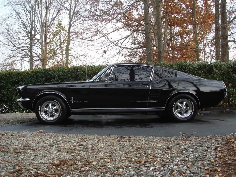

Oh no! You should keep the Cragars! Anything bigger is cartoony! Everyone at the retirement home agrees with me!

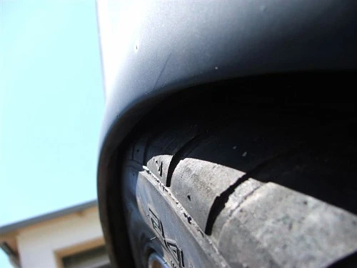

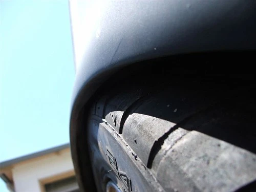

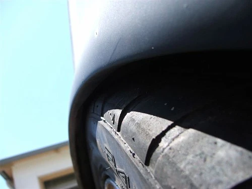

Now that we have that out of the way, what backspace are you getting? 17x8 and 4.75" backspace with 245/45-17 will get you this much steering angle before it rubs:
I couldn't even fit a sheet of paper in there, and that's with rolled lips.
Oh yeah, black car + black rims = hot.

Thanks for the replys and the voting guys. I was leaning more towars the black centers and now that I am some reasurring feedback I think that is the route I am going to go.

Damn thats close.
The backspacing on the front 17x8 wheels is 5.72 and I will be running a 1 inch spacer.
Umm what suspension does the front of the car have in that picture? It looks like it is pretty low.
