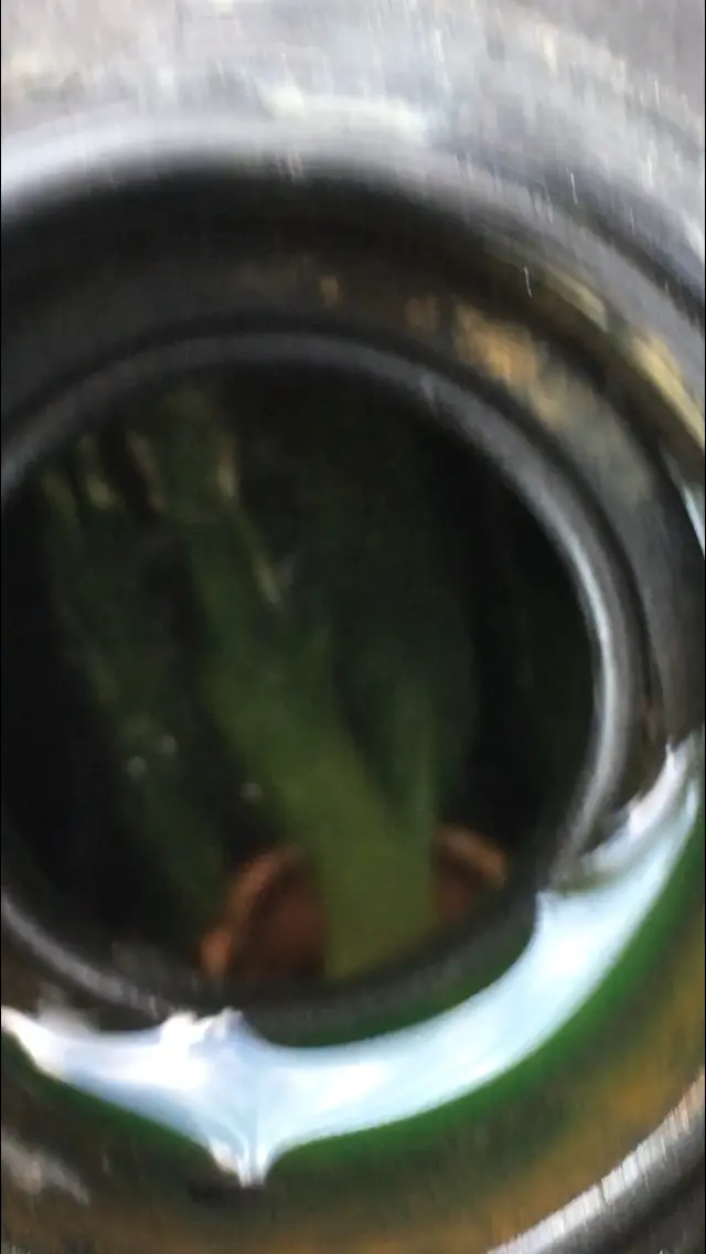

Will find out this afternoon how she runs after the cleaning - the power of the flow leads me to believe the water pump is good . The only thing I did not verify is the inner cooling chambers in middle not clogged and flowing proper. I could take some temp gun readings on various spots of outside of radiator to see if any cool spots not circulating . I hope I am not being OCD on these water temps though . I am going off of what others are saying ( they probably have different heads that flow water better ) several people said their car runs at : 188 , 200 , 210 ect... my car being ALL OEM is a bit different ( most people with a stock car don’t have a mechanical temp gauge either , so it hard to get a comparison on the cars actual temp )

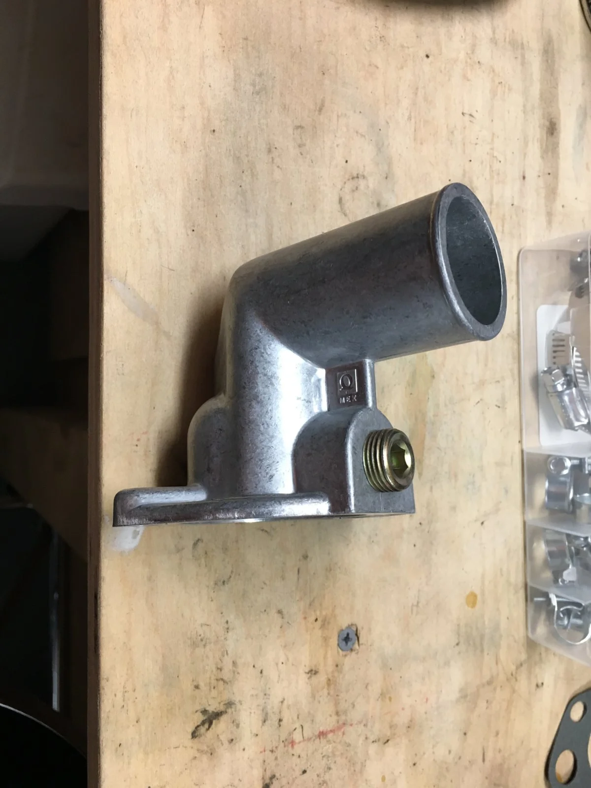

I’m about to replace my thermostat and housing. My new one came with a nice bleeder plug. I realize it’s not the highest point, but I’ll give it a try when I refill.

I think that is not a 'bleeder plug' , it is still too low I think. Most use it for an aftermarket gauge, on older models it had a vacuum thingymabob on it for the old thermactor emissions stuff.
i just jack up the front end as far as I can and squeeze the lower hose several times to pump the air out. Works every time.
Makes sense. It seemed like it was not the ideal spot to bleed from...... with the rad cap being a few inches higher.
Yeah you’d definitely not have a good day if you tried running with that plug cracked open. Technically it would bleed...coolant...everywhere
Agreed with squeezing the radiator. Jacking up the front or parking on an incline isn’t a bad idea, not a requirement though.

I hate those damn plugs. Fought a leaky one for a long time.

I’m convinced..... I’ll seal it up good and bleed it the old fashioned way.
