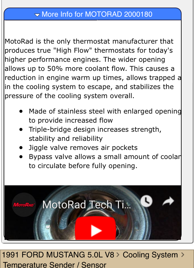

I am going to try a high flow 180 Tstat by Motorad - it claims to have a jiggle pin to remove air ? But says it also flows more coolant with bigger opening - I can’t be sure the previous owner actually changed the stat ...

High performance (high flow) t-stats have a slightly larger opening. There are many different ones, mine is a Mr. Gasket.
Mr. Gasket 4364 Mr. Gasket High Performance / High Flow Thermostat - 180 Degrees
Mr. Gasket High Performance Thermostats are designed to resist large variations of coolant pressure at high RPM (revolutions per minute). This allows them to fully open at correct temperature consistently regardless of engine RPM. The design also provides the high flow that engines operated a...

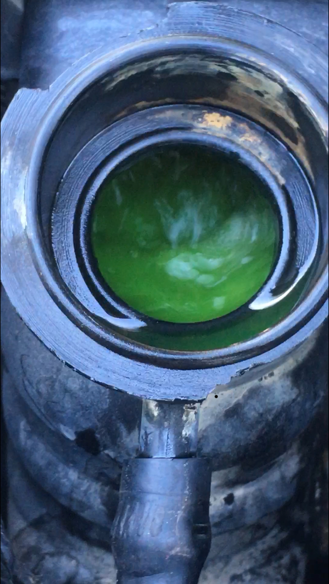

After some troubleshooting and testing - I believe the thermostat was changed recently ( some clean sealant around the joint is visible ) I don’t think it was sticking closed , I think some air pockets formed an obstruction and did not allow good water circulation thru the heater core . May have had some air pockets near thermostat to give a high false reading for a brief time as well . So I parked car idling at 180 degrees . It pointed nose up at very steep incline and I opened cap after tstat opened ( before boil point ) tried the heater ( it was 100 degrees, luke warm at best ) coolant level was at brim , revved up and level dropped about 4” and brief bubbles , filled up to brim again and repeated a few times . Then capped it . Drove it in to work today 45 min drive - cruised mostly and brought revs up harder on going up some hills and down some hills - temps stayed between 195-215 - heater blowing 130 degrees - also did some heat gun testing - when temp gauge in car was 185 and circulating of coolant these are heat gun readings : top of radiator 190 ; middle area 160 ; top rad hose 165 ; bottom hose 135 ; tstat housing 165 - fluid circulates strong in radiator from inspection in the cap opening . After the heater core circulated the coolant was not at green ( the heater core probably still had straight distilled water from the rinse after the cleaning flush )

45 min drive home in 87 ambient air: most of ride was 190 - ended up at 215-220 with some hard throttle here and there , city drive : did another burp on incline when home produce some bubbles , but only small drop in fluid ( heater running strong and hot ) - top hose temp 230 ; bottom hose temp 190 - so far I am comfortable at these levels - car seems to run smoother and more responsive at 220 btw
