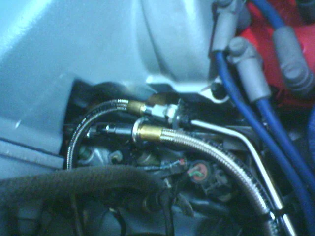

I just installed my T-trim this weekend and I thought the directions weren't very clear about FMU fuel lines. It says to remove the return line at the lower right side of the block, but the fittings aren't right to do that.
I had to leave both chrome parts of the fuel lines, just disconnected the return line at the manifold and connected the corresponding line from the fmu to the end coming from the FPR and then the other line coming from fmu back to chrome portion of return line to tank.
confusing... here's a pic...
btw, HOLY CRAP!!!! It freakin kicks a$$!! I have some pretty hard tires on there now and it just smokes 'em. I'm also blowing alot of black smoke when I hammer it. Stock injectors- could it be FMU setting too?

Hmm.. which line of the FMU is going where is my question. theres one line going off the bottom and one line going off the side
