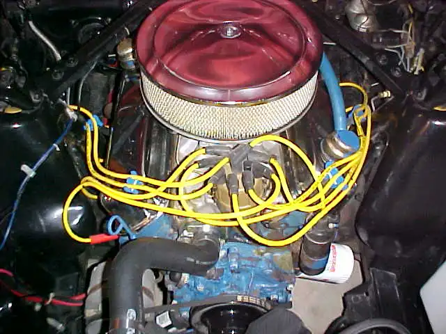

heres a front of engine pic

Depending on what the "lots of other stuff" is, you might be getting 390hp at the crank, but NOT at the rear wheels. On that car, you'll be losing about 20% through the drivetrain.
On your leaking problem, either get a cast housing or get a quality chrome housing. Either will work fine if you use a proper amout of RTV sealant (I prefer black for this, but blue works fine), and tighten the bolts at the same rate.
GET A FAN SHROUD! Its hard enough to keep a 289 cool with a shroud, but if you're bored .0060 over, it is critical to keep it cool. You have almost nothing for a cylinder wall, before you hit the water jacket.

sixtyfive... looking at your mods there is no way you could have 390 horses. To do that with a 289 requires aftermarket heads and/or forced induction. Now you may indeed have 390 horses, but if so there a few big mods missing from your siggy. Don't get me wrong, you have a sweet car. Ask the P.O. if he ever did any headwork to the car. A blower or nitrous setup should be relatively obvious :) (and i don't see any in the pic).

About the fan shroud im told that i basically dont need one because of the flex fan and i have a 180 degree thermostat or some better then stock kind that gets it to cool sooner and faster And if i did get a shroud it would have to fit the larger fan, ive also run this car for over 3 hours and not had it get near too hot while gettin on it a little bit.
Not really true. A stock fan and shroud will cool way better than a flex and no shroud. Without a shroud you are mostly blowing the hot air in your engine bay around with little or no direction, the shroud ensures that you are actually sucking the cold air from outside straight thru to cool everything off. The only efficient way to do this without a shroud would be to switch to an electric fan mounted to the radiator that would either suck or push the air thru in the same fashion. This can also free up some more horses but most opinions are split as to whether or not electric is in fact better than stock.
BTW, I still can not see the heater hoses from your front on pic, is anyone else noticing this? Can you get a close up so that all the spark plug wires are not in the way? I still suspect some unusual bypass may be a potential culprit for the leak. Do you know if your heater is working at all?

Here, I'll post up a pic of my stock looking engine bay. See the two red hoses that go from the housing to the firewall? Those are the heater hoses, they basically just route the already hot water thru the heater box so the fan can blow the heat into the passenger compartment. It then cycles right back to the radiator. Mustang heater cores are notorious for springing leaks and since now a days most folks only drive their cars in nice weather, many have over the years yanked their bad heaters and run a bypass. The bypass simply elimintes both hoses going in and out of the firewall and replaces them with a 6 inch piece of hose that connects from the topconnection directly to the bottom connection. As you'll notice, below your big hose is actually a small 3" l shaped factory bypass set up and this simply creates another one. Because I can not see a bypass in place of your missing heater hoses, I am theorizing that perhaps the previous owner just stuck some plugs into the holes or something like that, and that cvould be the source of your leak.
BTW, no, you would not necessarily appreciate any horsepower gains from the shroud, only an electric fan set up. I know you have not had any issues yet, but traffic lights in August with a .060 bore is asking for trouble in my opinion and you will want to take advantage of every cooling trick in the book you can, trust us.

Geez, I just noticed something lese too. Either I'm blind or it is the angle, but I don't see any heater hoses or a by pass in it's place. Is it possible that a PO blocked it off and that is what is leaking? Can you get us a front on shot of it?
Well, the connection to the water pump is staring right at you, has a black rubber cap and a hose clamp. The car probably has a rotted out heater core. He might want to pull back the carpet in the passenger front floorboard and see if there is any rot.
It's a nice car, has chromed '68 Styled Steel wheels on it. But it probably doesn't have the 390 RWHP that he thinks it does. I'm guessing it's in the 225-275 range at the rear wheels at most, not knowing the cam that's in it.
