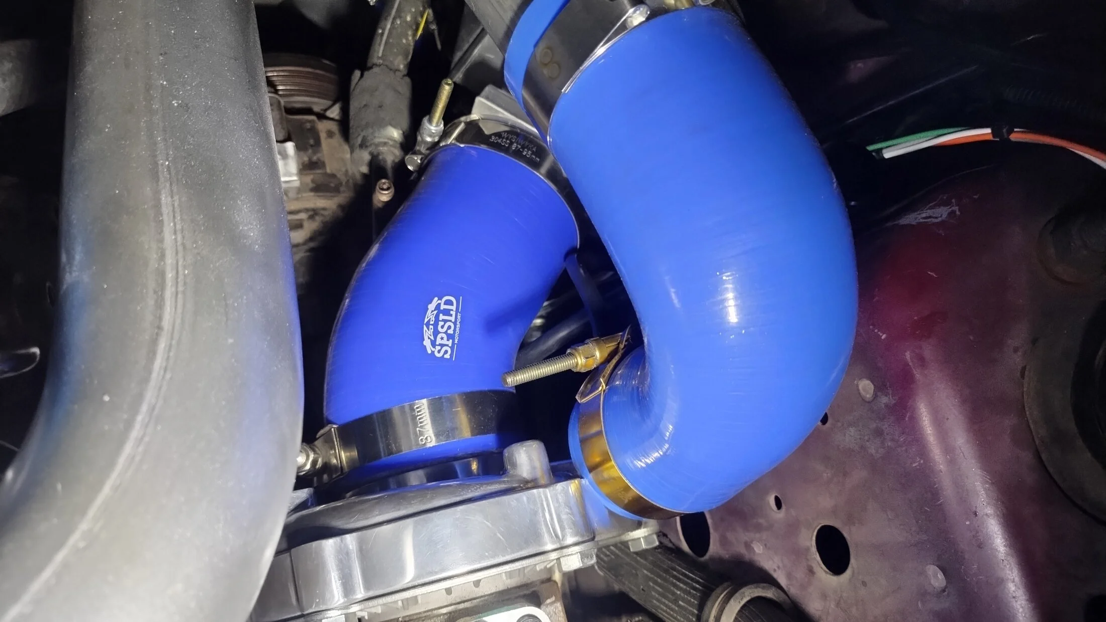

Guys, im afraid of this new motor. Its not my N/A 2.3 im used too. Im afraid to trust it, partially because i blew a head gasket goosing it, and partially because im not able to see my information while im driving, yes i got a boost guage, but im not able to focus on that and drive at the same time, atleast were i have it taped, its insanely loud because i dont have an exhaust yet, cool, but a lil excessive, im learning a new beast, and this beast is, well, a beast. I got some kinks to work out, but i wish there was just a green light that came on saying your not gonna have any issues as long as you just do this. I know i did evreything right, it sounds bad ass, it feels bad ass, and it makes me happy. It just also spooks me, im not as familiar with it as my N/A 2.3 i guess ill have to learn to trust it the same way.

Here's a video of my issue, i fixed my rubber intake hoses that were collapsing under vaccum, got everything plugged in, but my check engine light comes in and makes the car run like doo doo, i thought fuel pressure, but it goes off and the car runs good, so, what do you guys think? Bad vam? Throttle position sensor? O2 sensor? Fuel pressure? Spark plug gap? (Somone tell me proper gap, my hanes manuel dosent have it listed for the turbo 2.3) Let me know what you think! And yes, i have no exhaust and its loud af, i got a down pupe that comes out by my tranny crossmember and thats it, so im not too worried about back pressure. I also tried hooking up my blow off valve, it works! But it stalls the car and never closes once it opens
