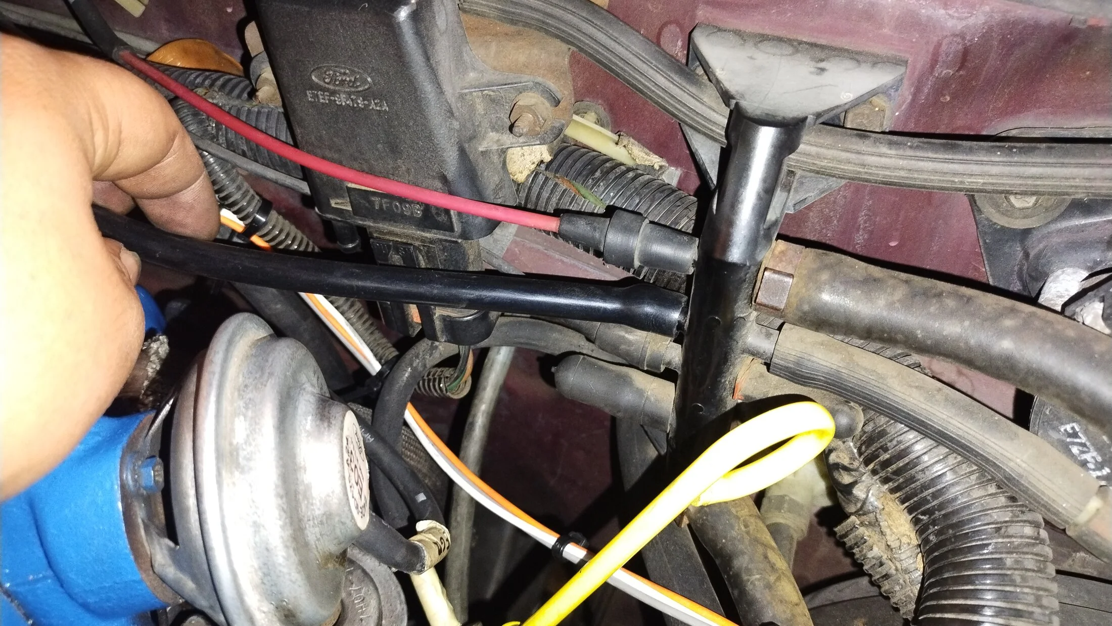

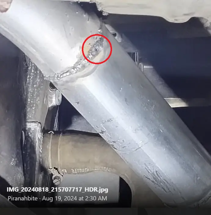

This looks like a hole:
hmm... indeed it dose.... ill go pressure test it!

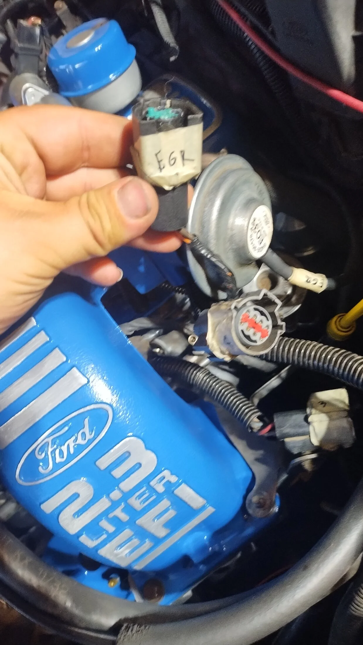

Hell, i need pictures, im assuming the position sensor is the one connected to the egr valve, wich is on the pipe?
The egr vent solenoid.... Wut da hail is that, and were do i find it on my harness?
As far as my vam harness, i got a new one from stinger, ill check to make sure the colour's match
I have no pics but looking at some wiring diagrams I have, The EGR Position sensor is a 4 prong connector with one prong blanked out. It looks like that may be the one in your pic. Check the wire colors. If it has BK/WHT, ORG/WHT and BRN/LT GRN wires, you've found it!
The EGR Vent solenoid is also known as EVR or EGRV. It should be fairly close in proximity to the EGR Position sensor. The EGR Vent solenoid connector is a 2 prong piece with RED and DK/GRN wires. Also, if you happen to get to Sacto, Pick-N-Pulls Mather yard has a '90 Mustang w/2.3 that you could verify component placement and wire colors. Should be the same as your '87 harness...........
Reactions: Piranahbite

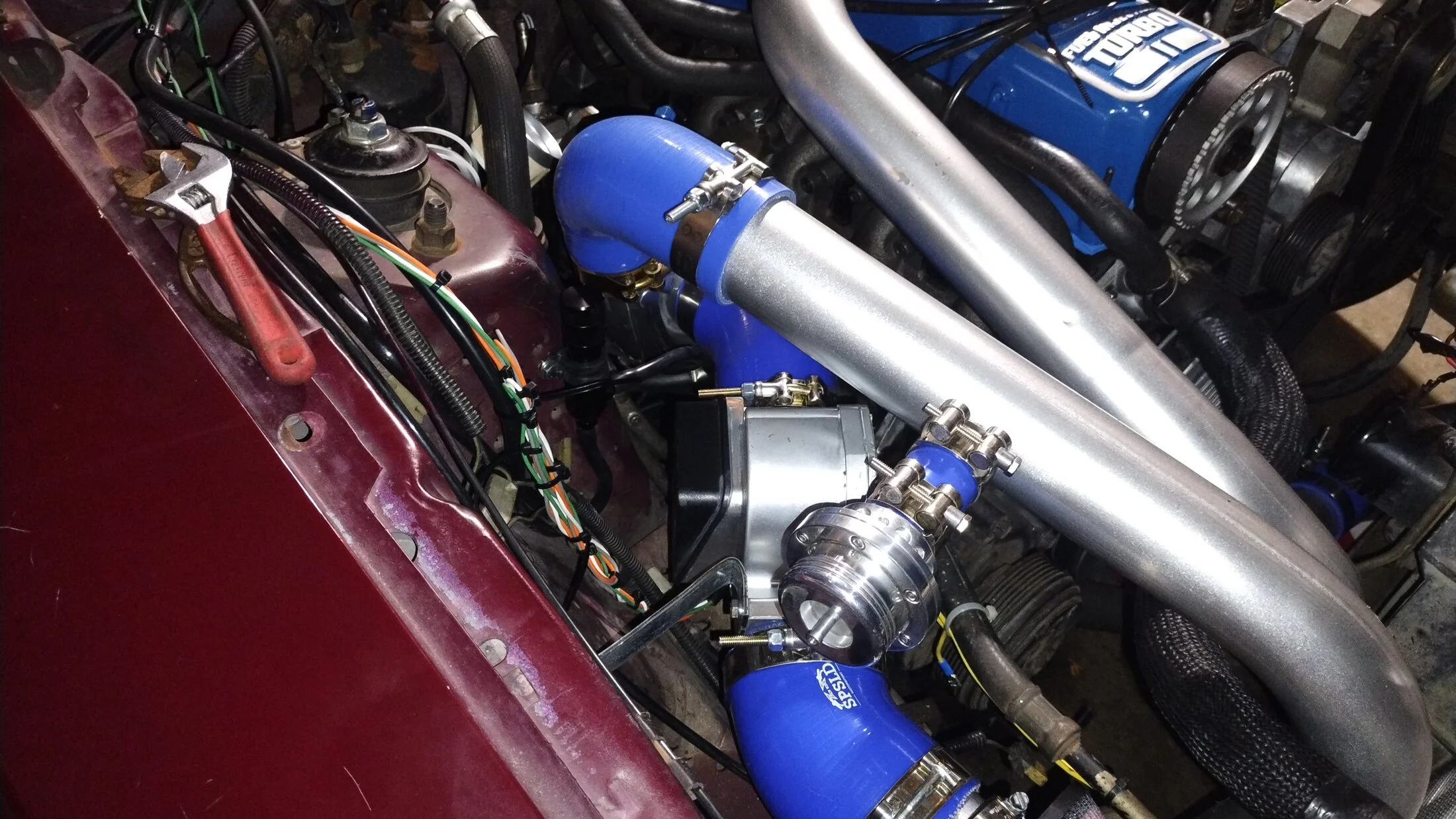

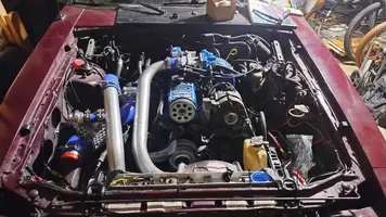

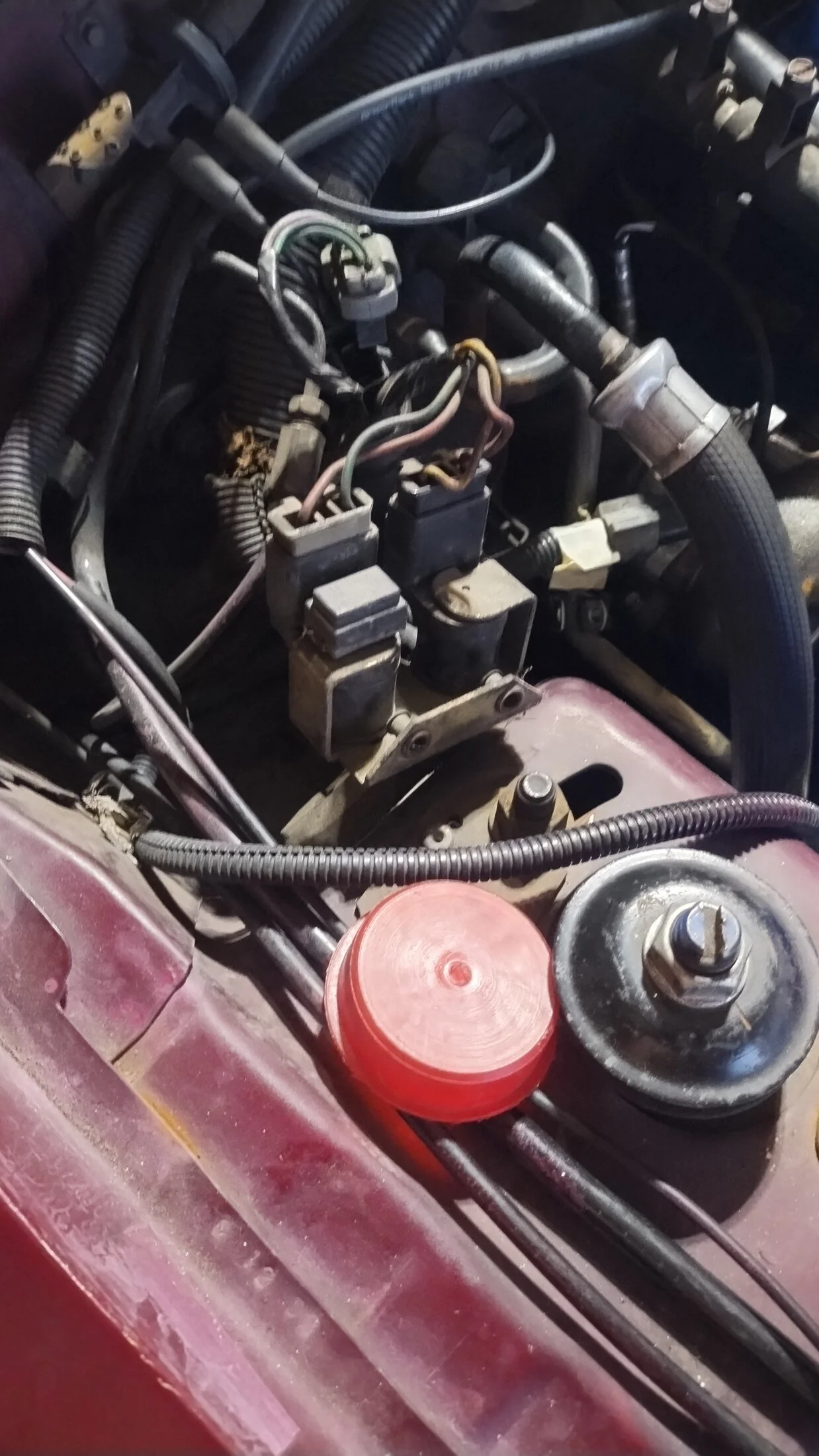

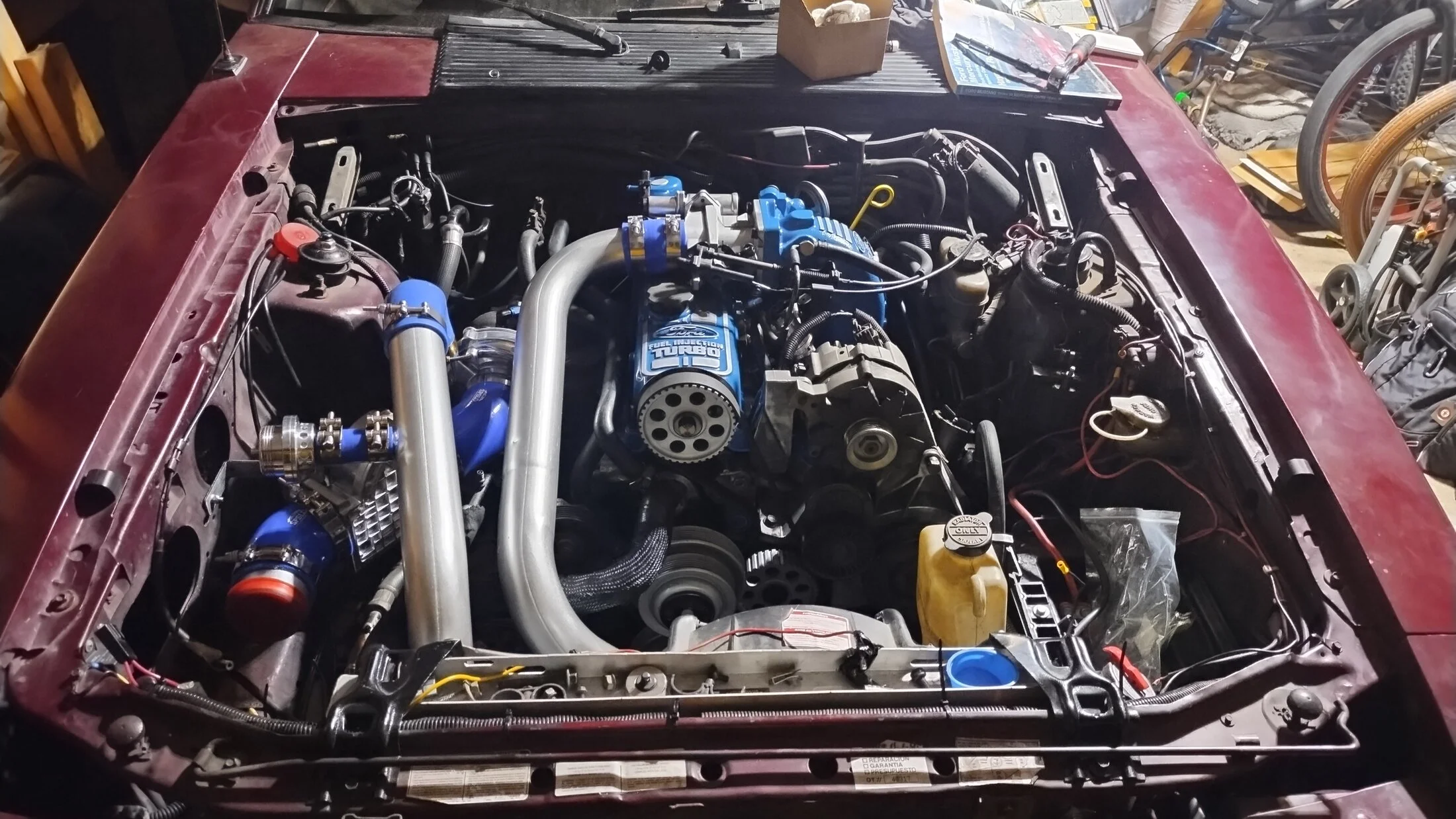

Heres my lil checklist and a quick pic of my progress! I got a bunch of little things to do, and the two and a half big things
1 being fix the ac line thats trying its hardest to get pinched between the shock tower and turbo,
2 being rout vaccum lines and boost regulator
The .5 is finishing the ecu wiring, all i managed to do was pull my ecu, im still psyching myself up for the actual snipping of the wires part, hoping to find something that just slaps me in the face about that 2 wire egr conector.
I see the three pin connector, specialy because theres nothing for it to plug into now since the egr sensor thing is gone

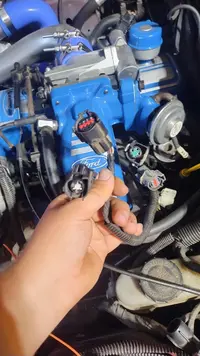

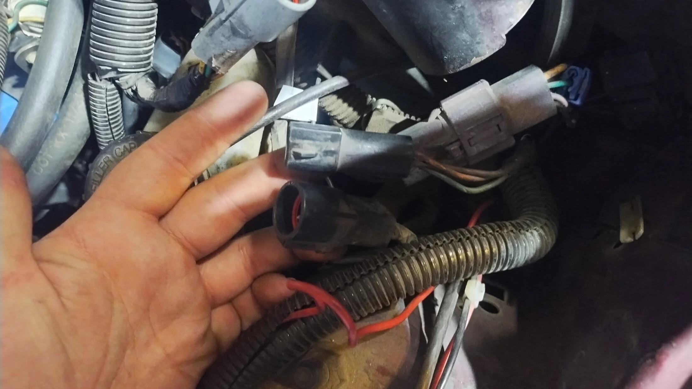

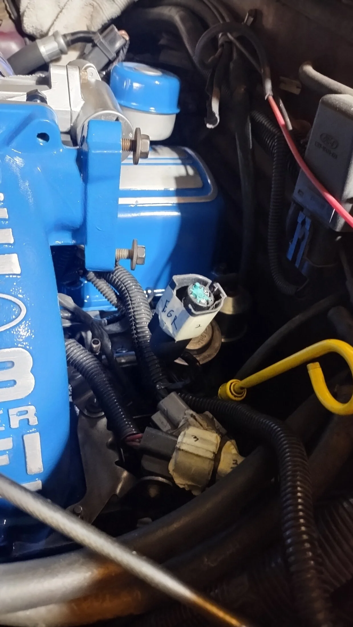

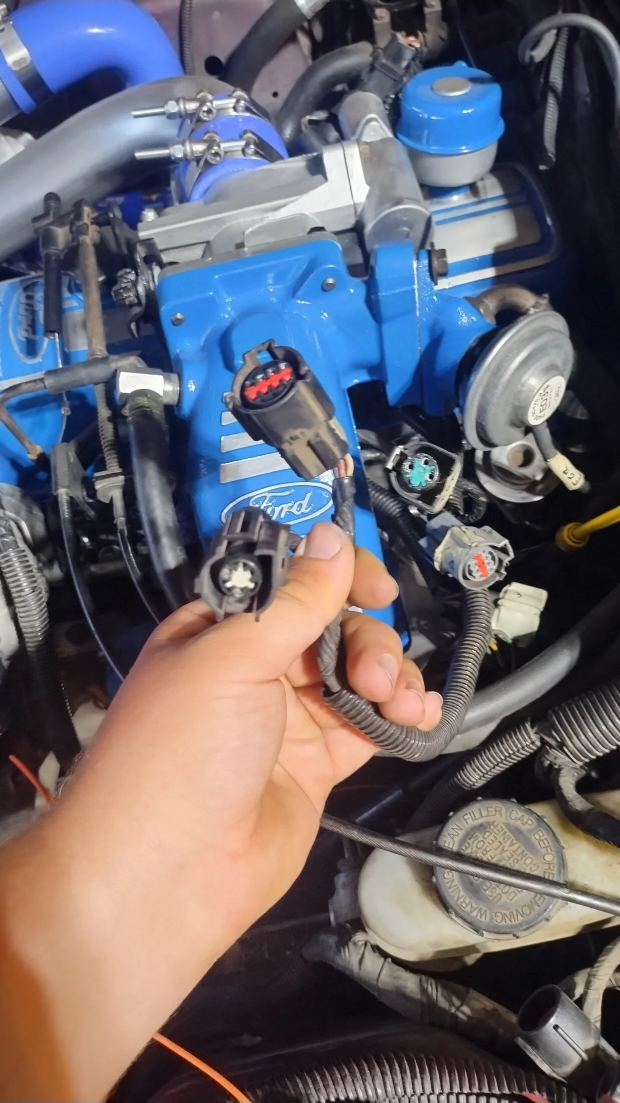

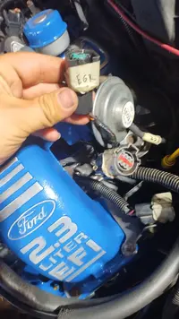

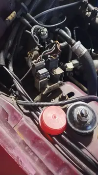

@evintho these are my egr plugs that iv ohm tested that go to the valve itself! Im assuming atleast two of these wires im supposed to connect my vam harness too, and ome of them goes to my solenoid thing behind my strut tower, right? And then the ecu stuff.

Don't worry so much. It looks like you've found the EGR Vent solenoid wiring. In the first pic, the connector on the left looks like a 2 prong connector with RED and DK/GRN wires. Clean off the wires to double check the colors, then go to your 60 pin ECU connector and make sure the same color DK/GRN wire is going into pin #33. If so, at that point, carefully remove it and insert into pin #43. Just cut the RED wire at the connector and cap it off.
I think we determined that the connector in the 4th pic, with masking tape marked EGR, is the EGR Position connector. Follow the instructions in post #341.

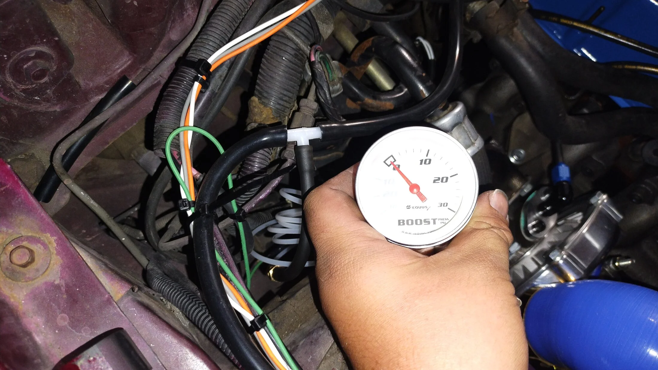

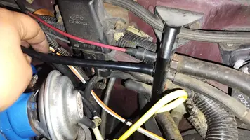

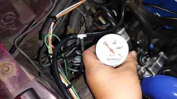

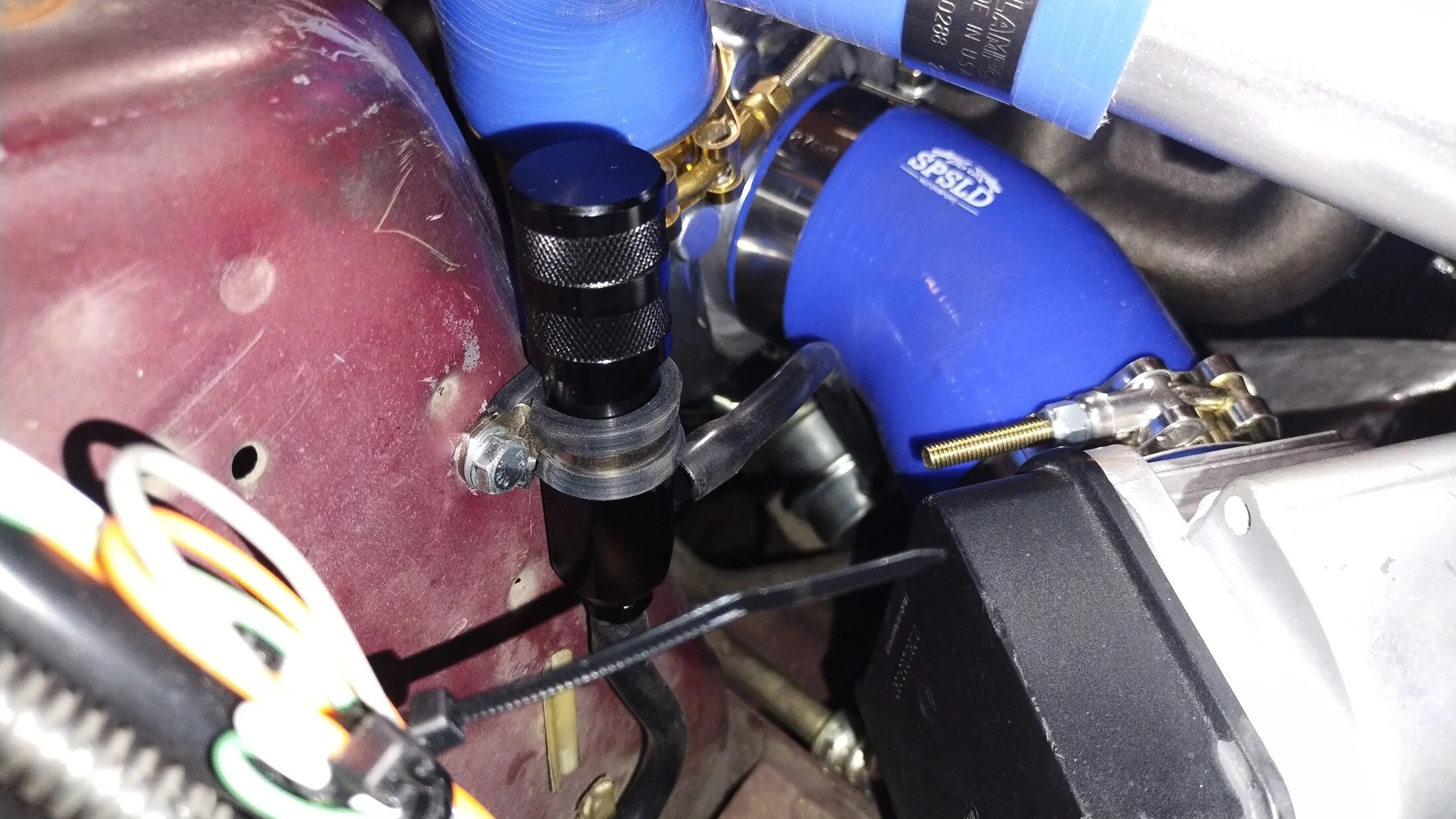

Im installing my boost regulating system.
Chip from stinger says its okay to run a line from any position (did not say were on the vaccum tree, so assuming anywere is ok) and run it to the internal waste gate on the turbo with my boost controller in between the wastegate actuator, and vaccum tree. I put a lil cheapo guage from auto-bone in that circuit, and when idling the car reads about 10 lbs? -psi? Of vaccum, revved the car a lil and it increased, im assuming if i wanted to see it show boost id have to wait till the cars under load with the hammer down, sound right?
Anyway heres some pics of my routing. In the coming weeks, i plan to drill out one of the bosses on my turbo outlet and rout my waste gate to it so i have a more responsive connection, Without all the travel. I aslo bought a dual piston blow off balve (BOV) from stinger, and plan to use it, as of right now, i dont see how to. And figure i can get by if i stick the strongest spring in it, and dont hook it up, and just use the wastegate. ( I never plan to run more than 15-20 psi for now) but i figure having the BOV would just help me, and the engine in the long run, for redundancy
