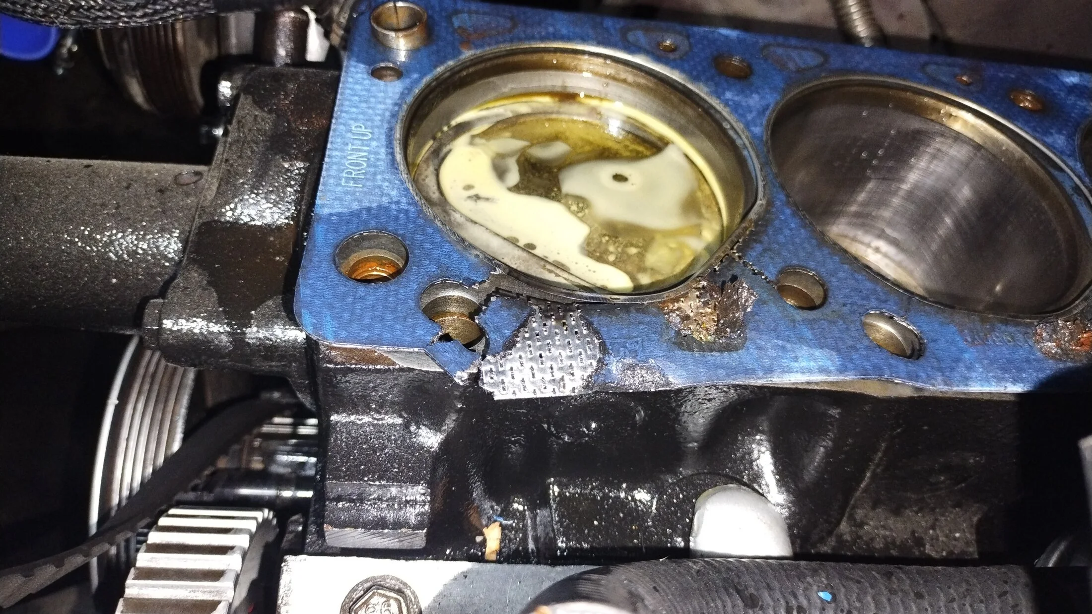

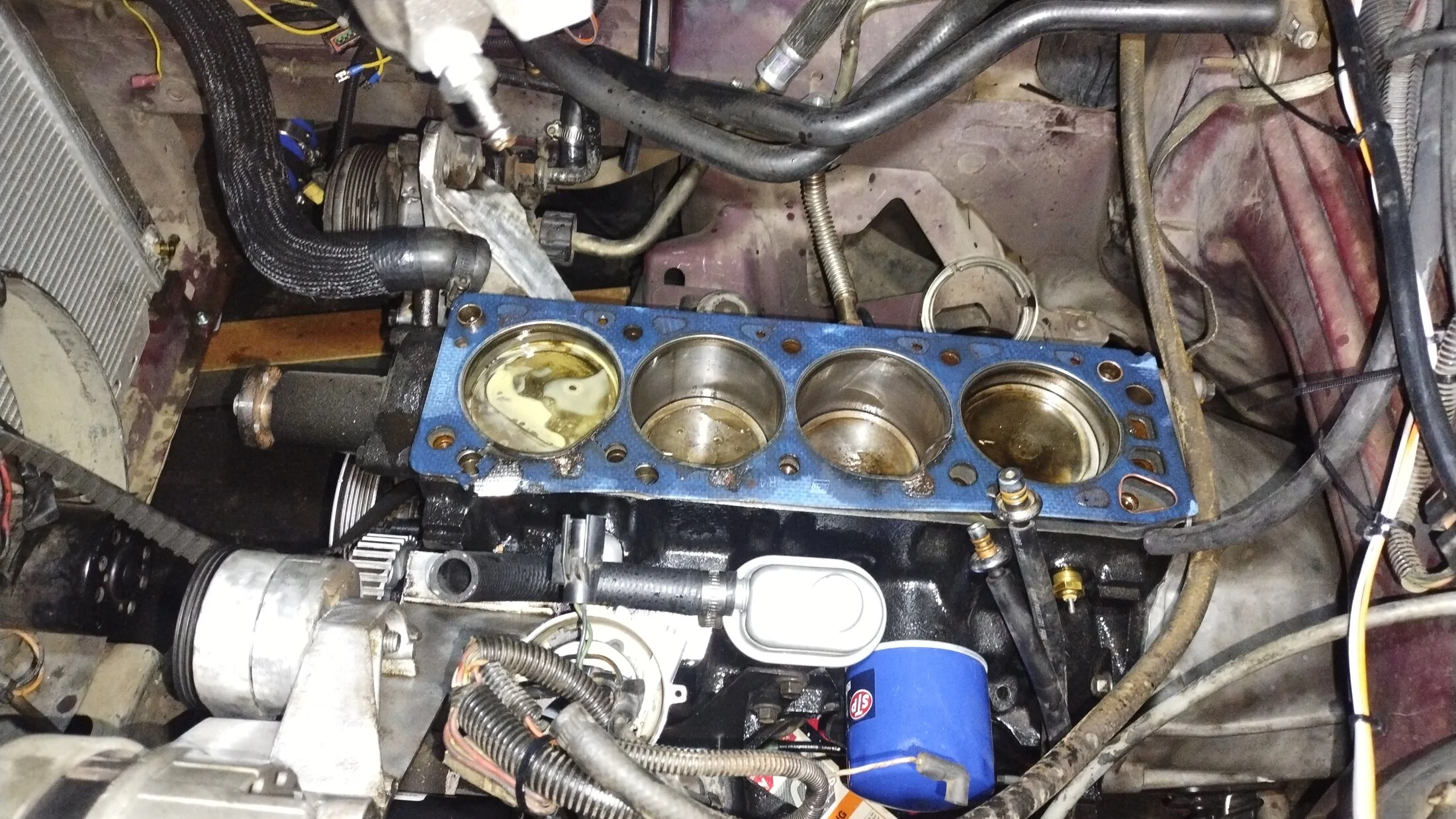

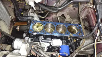

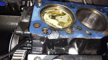

it blew up.
It ran, i fixed the vam, it was running nice, making cool noises, i gave it one good pull and ..... POP AND A :poo: ton of smoke out the back. Engine dies. I pull over, and theres milkshake all over my fender.
What caused this? Well.
1. Me
2. Cylinder head. When I got it back from the machine shop it was almost as if they ran the head through the decking machine too fast, if you dragged your fingernail across it you could feel the ridges from The cutting.
3. Improper boost control.
I had a gauge hooked up, when I did my lighter pulls, from about 20 to 30 mph, it made about 5 to 10 psi of boost, i turned my boost controller all the way out so it made as little boost as possible for now.
The way i have it hooked up may be the issue, instead of getting boost pressure straight from the outlet, its getting it from the tree, more of a delay, i also dont have my blow off valve hooked up, figued the turbo coup didnt have one, why should mine? Atleast for now
One of those three things i mentioned is definitely the cause of the head gasket popping.
Oil in the pan is milkshaked. Im pissed, im gonna go pull my head

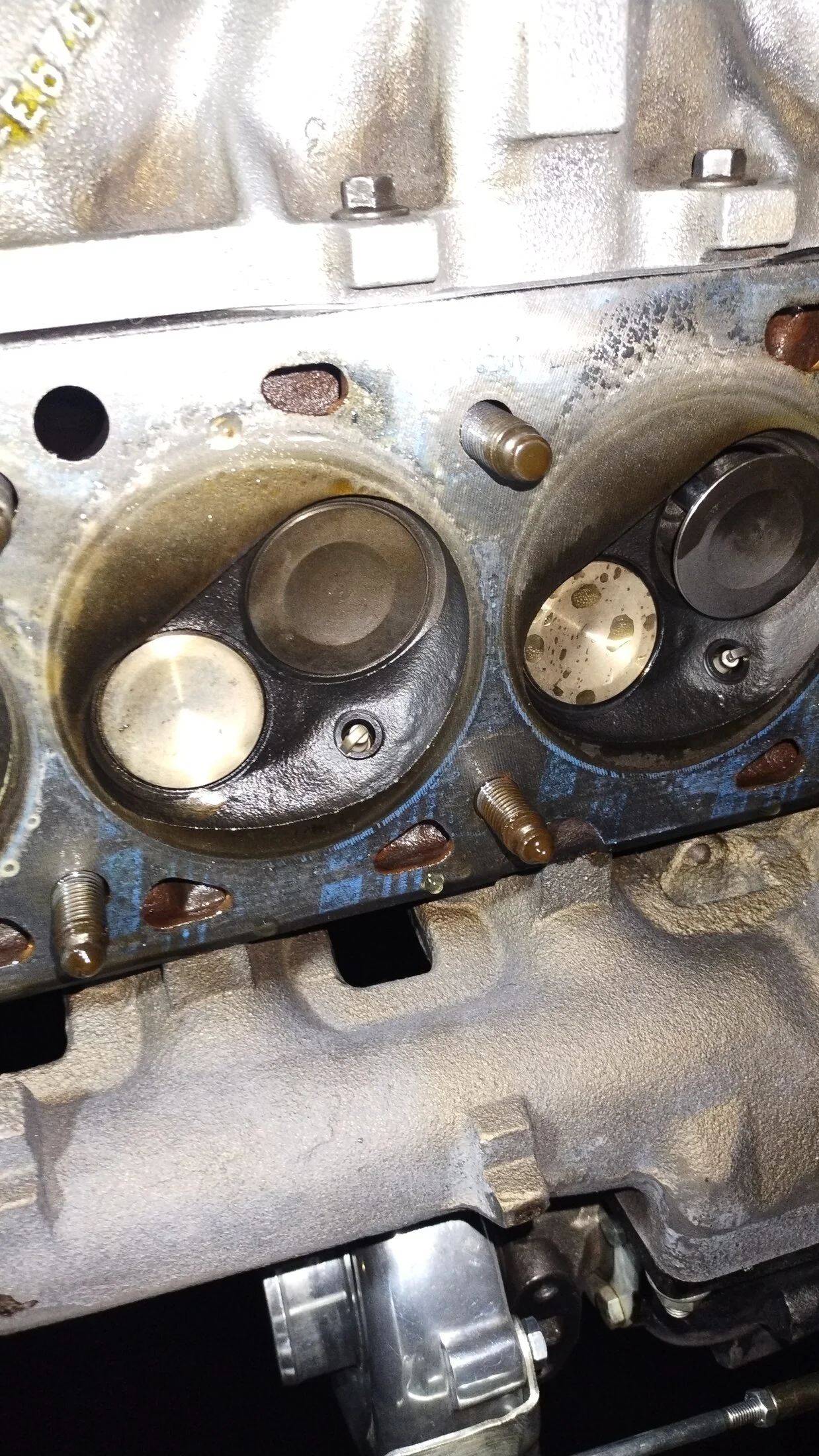

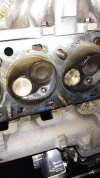

Engine went boom boom pretty good. Me and chip think i ran too much boost. Tomorrow I'm taking the head to a machine shop to get the head decked.
While the head is in the shop I'm going to figure out a more safe way to run all this boost, figure a better way to regulate it, figure a better way to not get so much.
Damn thing did rolling burnouts at 20 mph in second gear, I wasn't even trying to do that LMAO
This engines bad ass, but also scares me, when it was n/a took a while to get to 4000 rpm, with this new motor, its at 5500 like as soon as the boost kicks in, scares me

FIGURED OUT THE CAUSE OF THE BOOM BOOM.
so, the head gasket blew because of over boosting, i had my waste gate hooked up from the vacuum tree, to a regulator, to the waste gate, while i did my ecu conversion, one of the steps was to remove the map harness vacuum line, which i didn't do. i plugged it. Sooooo on my test drive, that bolt i used to plug that line popped out, causing a boost leak. because of that boost leak, i did not get enough pressure to my boost controller to open, and definetly did not get enough for the waste gate. because it was all dumping out that popped vacuum line. my engine made a crap ton of boost and blew out that gasket big time.
