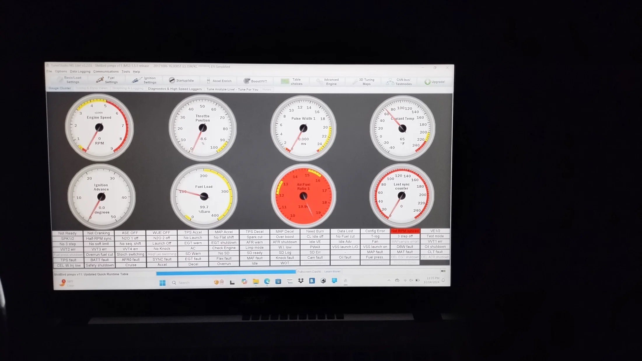

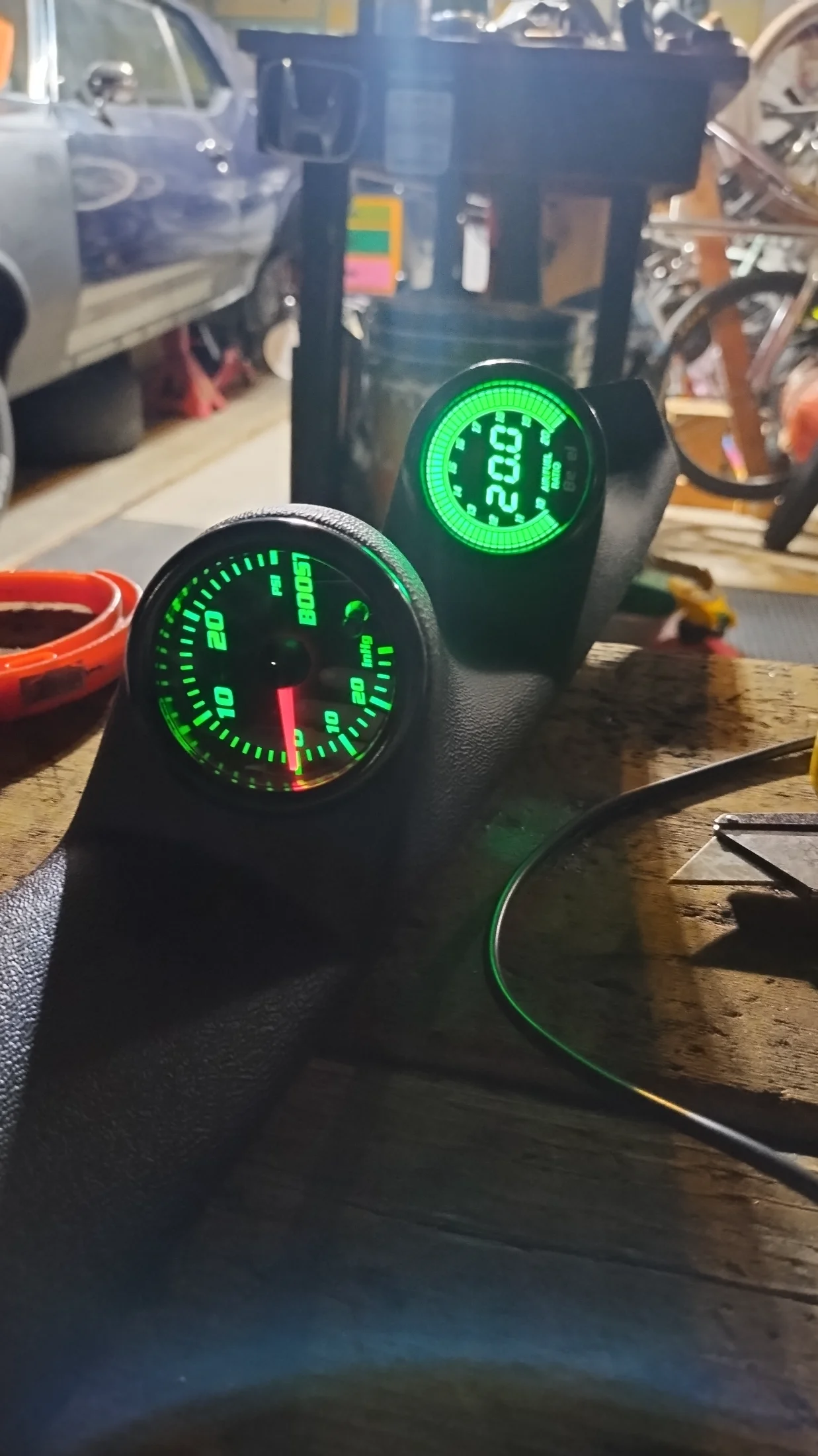

well guys, im still doin that ecu swap, i started on saturday, got the ecu wiring done, and now im on to puttin my guages in, and that parts holding me up, more wiring to do, wiring power, keyed power, then switched power to dim the new guages, and then ground. the hard part is going to be routing my boost gauges line, im not sure were to go through the fire wall, weather just drill a hole and gromet it, or do i try to go through a body gromet? but are there any i can go through on the drivers side? I'm a lil overwhelmed by this part of the project, but ill get it, i just need to apply myself better. hardest part is installing the pillar guages and then the wiring for em. I GOT THIS
As for the ecu and getting the car running? i need to verrify timing and set up my injectors, super simple with the instructions that are provided. i should have it running either in the next couple hours, or Saturday night. the software is super nice! i got to calibrate all my sensors, and its super rewarding to see everything working! AFR gauge, TPS, coolant sensor, all that fun stuff! and now i get to eliminate the VAM and old MAP sensor! the PIMPXS has the map sensor built in, and without the VAM I can hook up my blow off valve and have some more new noise! once everything is running and reliable I'm going to take it to Novato to jays muffler and get an exhaust put on.
not to get personal, but work and school have been kicking my butt, super dense homework projects, and iv done like 2 and soon to be three engine changes at work ( changing IO-360's on Cessna 172's) so, although I'm learning about engines and fuel systems, its hard for me to continue to go home and then practice more about the same thing on my car without feeling like I'm doing homework, so iv slowed down and just do a lil somthing here and there till its all done!
AFR gauge is red because engine not running and I hadn't calibrated it yet

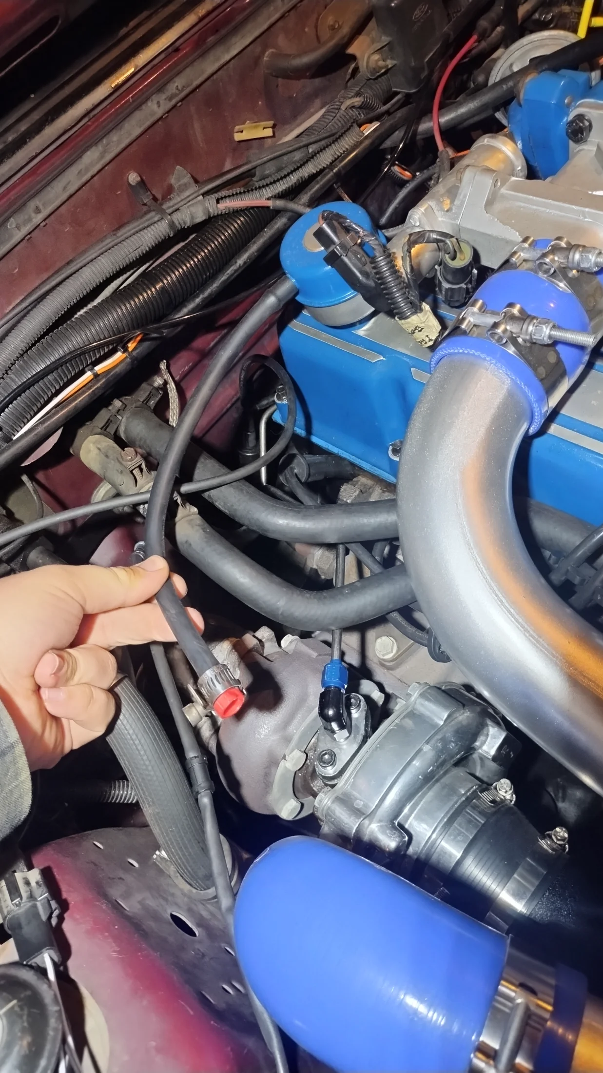

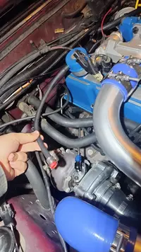

Can you post an image showing your current PCV system the best you can?
Be sure to include any oil catcher/separators.
You want a PCV system to pickup the "lazy" crank case vapors. These have had time for the oil droplets to fall while fast moving vapors will be saturated.

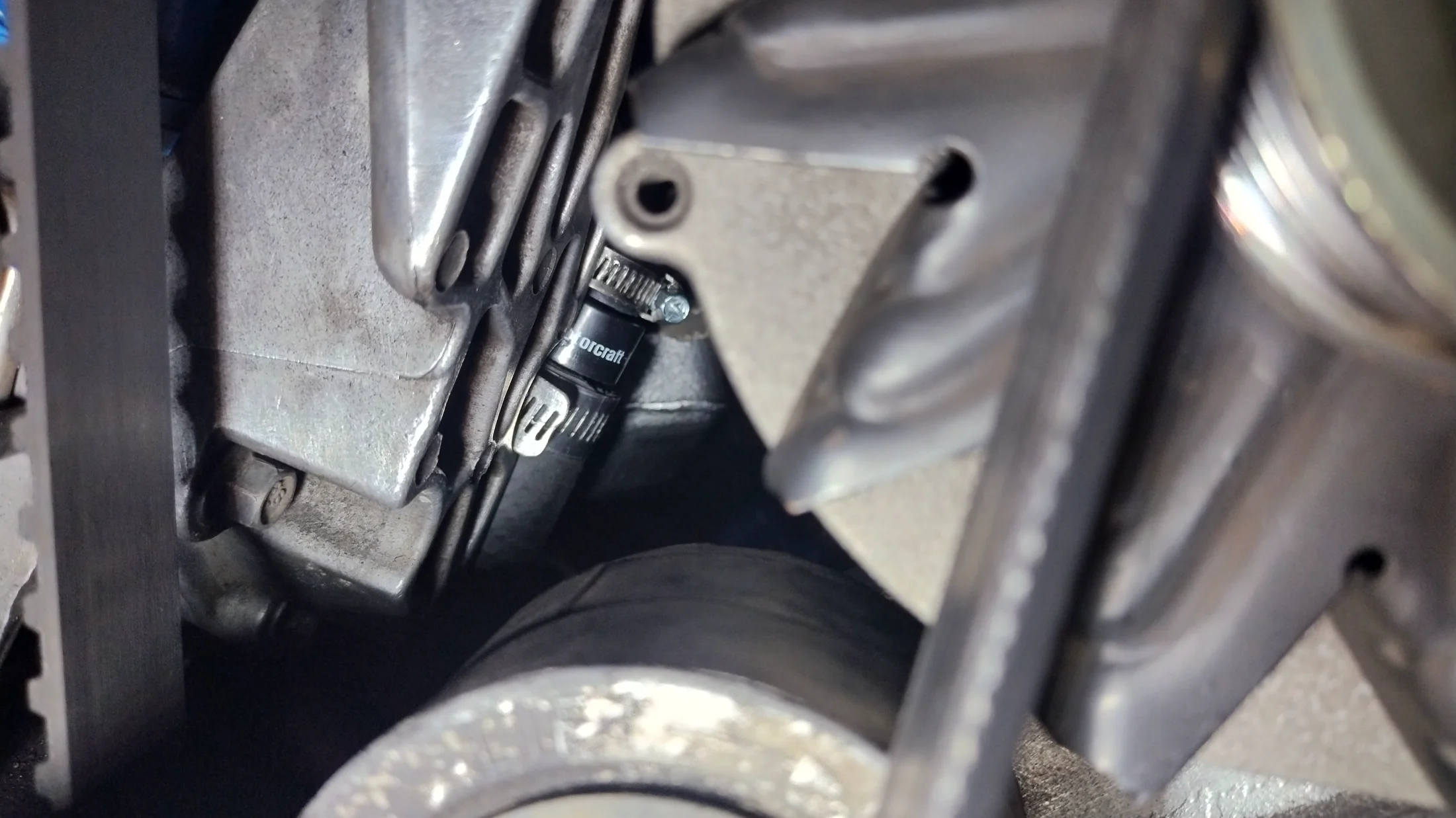

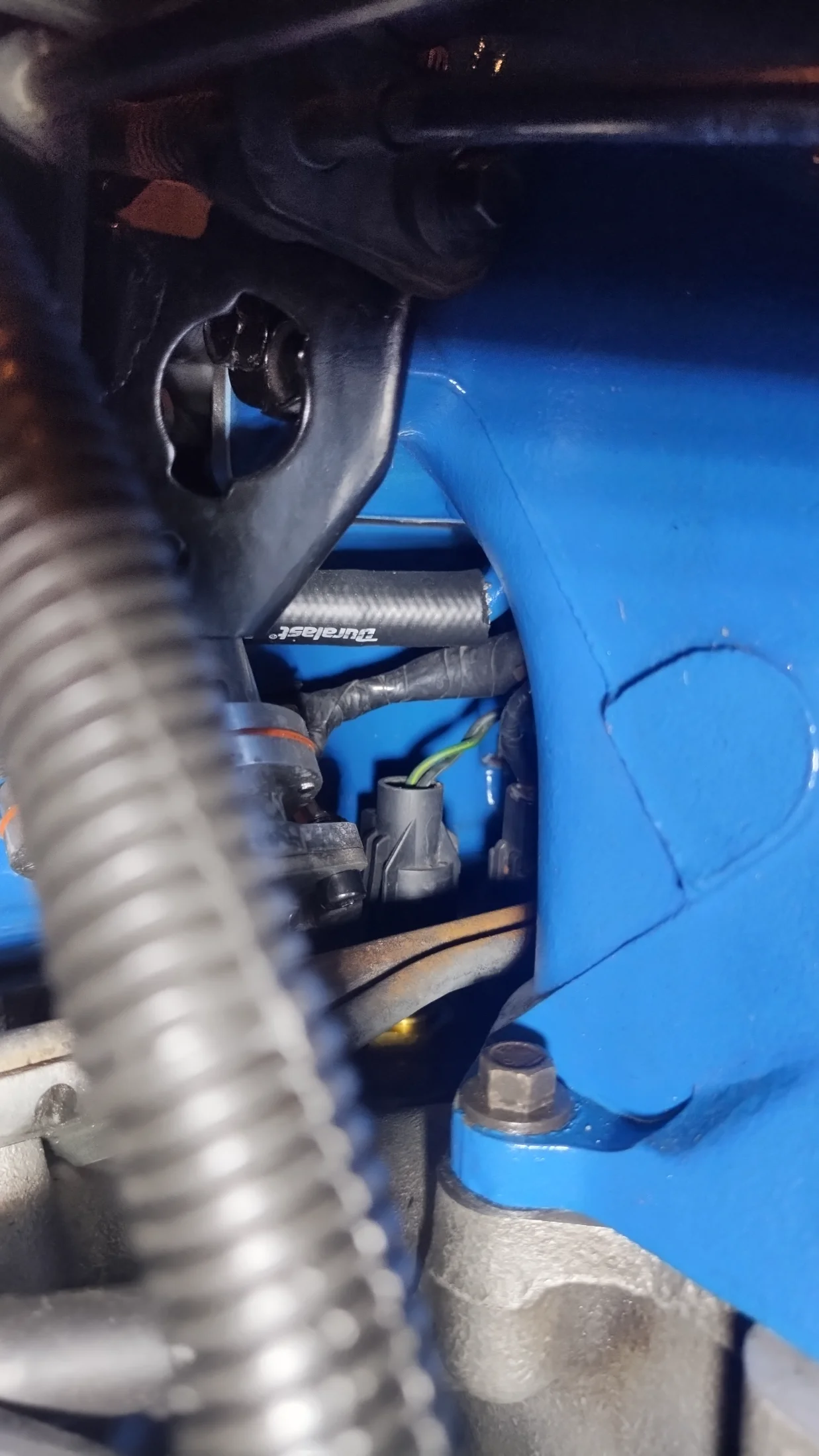

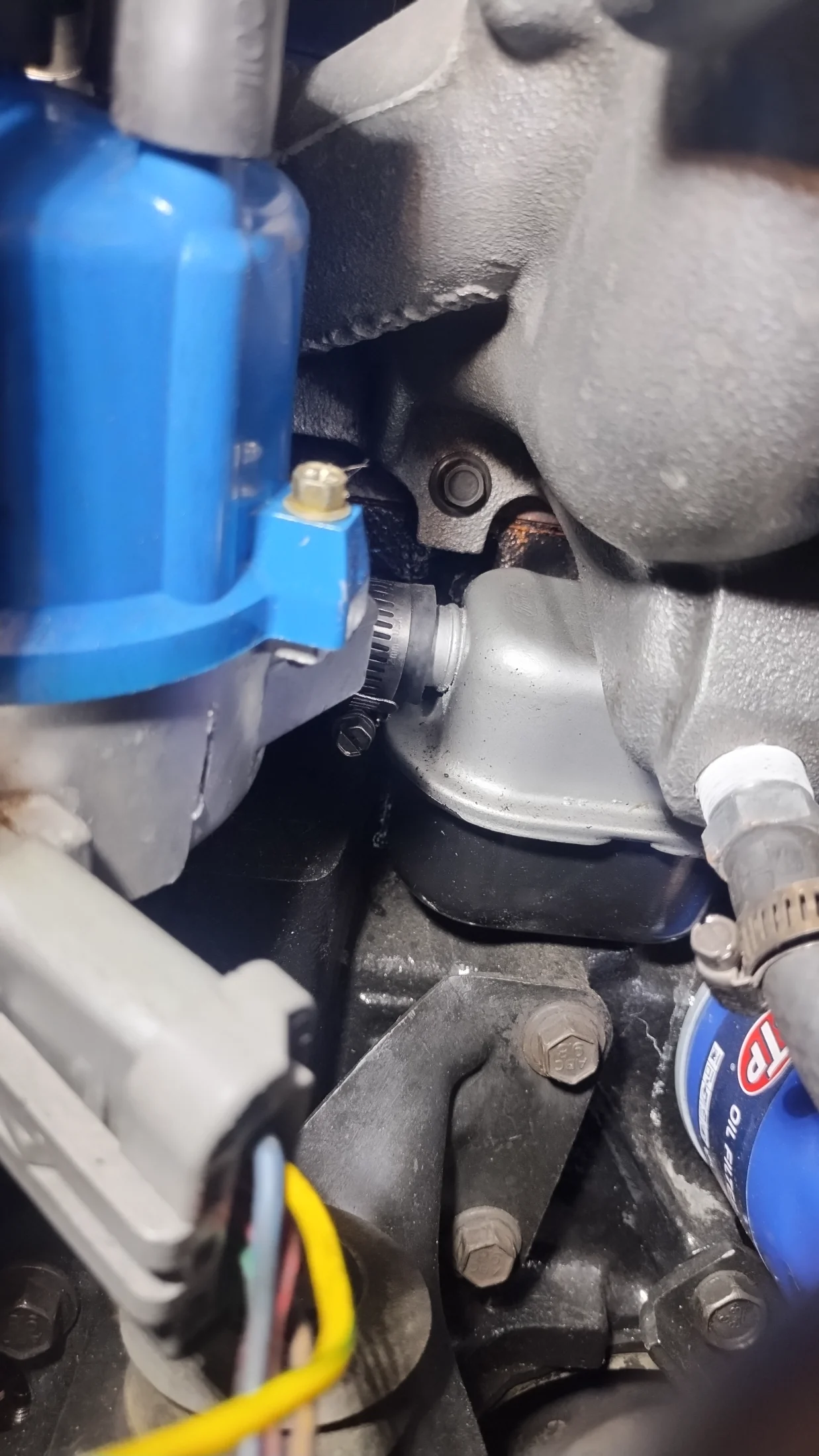

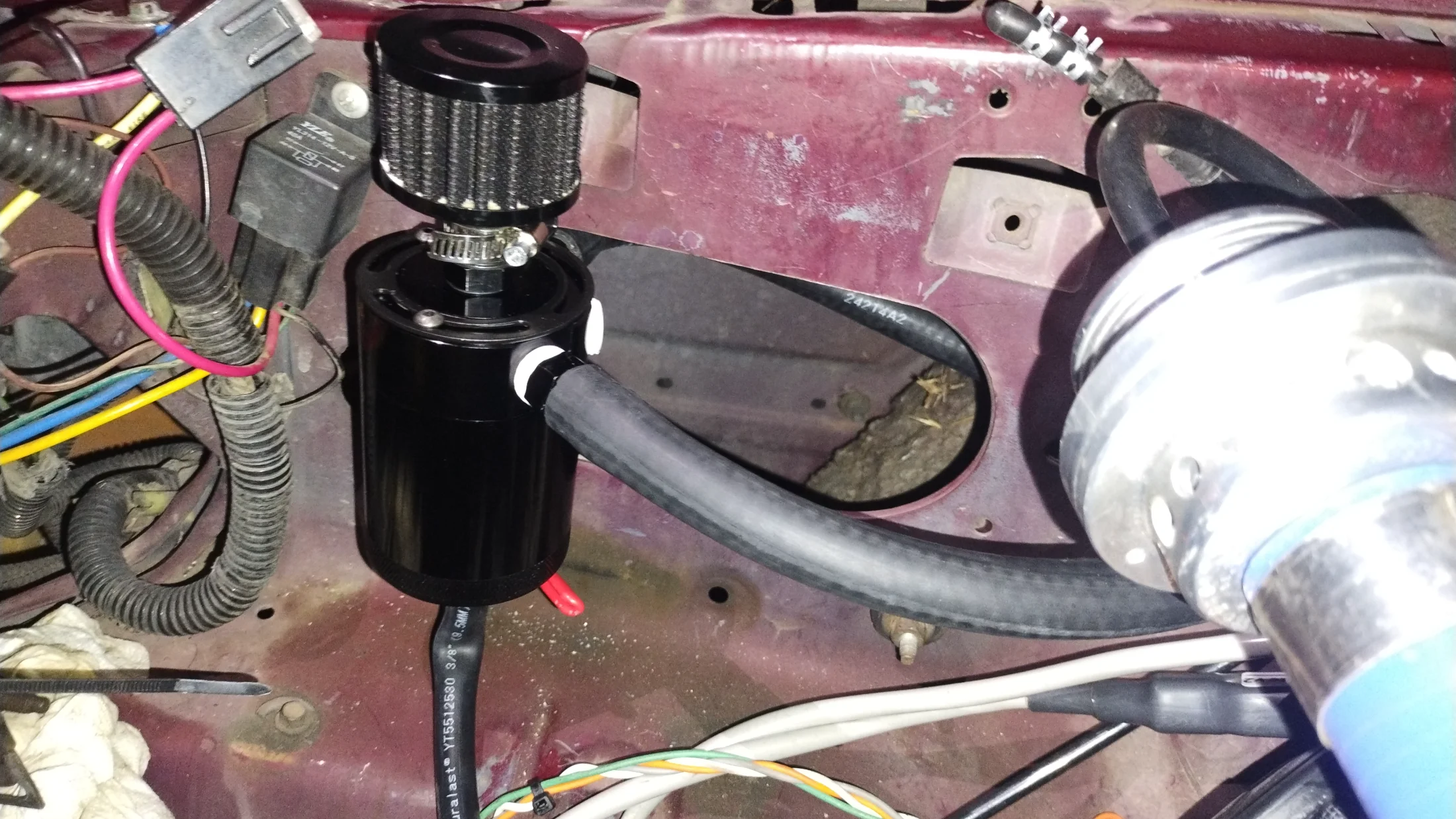

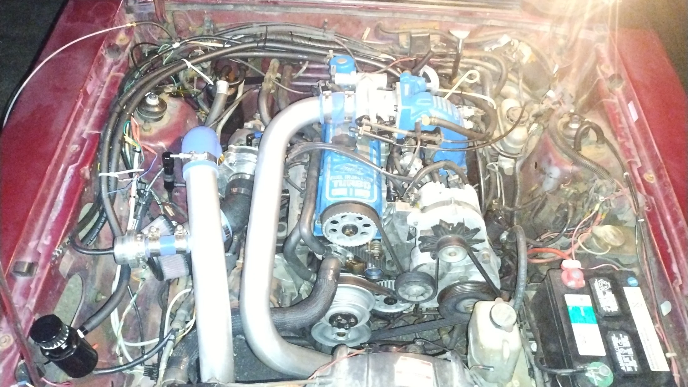

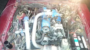

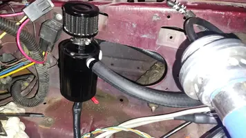

@Noobz347 heres pictures of the pcv system. Cant get the whole thing in one shot, but i got all the parts were its connected. I used hose clamps to secure everything since everythings friction fit.
The valve cover breather is plugged because it would blow all over my fire wall, im not sure were to rout it, but i dont want it blowing into my intake right? Since that would pressurize the head?

Guys. I'm back. I'm pumped to resume working on my car! I'm going to install a ventilated catch can and see if that helps my pcv problem. I think even if it's not the fix, it should be a good have as cheap insurance. I'm also going to buy a braided AN turbo drain line from stinger, I'm having too many issues with my current one I'm thinking those two parts should fix my oil leaks. and of course, ill finally be able to tell if my oil pan gasket and rear main are leaking or just getting oil forced past em under high boost.
i know its hard to tell, but i think theres a chance because the car only leaks oil under boost, and only blows smoke under high vaccum

All there is in that factory PCV baffle is a screen IIRR
Those were inadequate at best
Just replace both the rear main and pan gasket
How much boost are you running?
How much blowby you got?
Install a drag racing crank evac system with a one way valve?

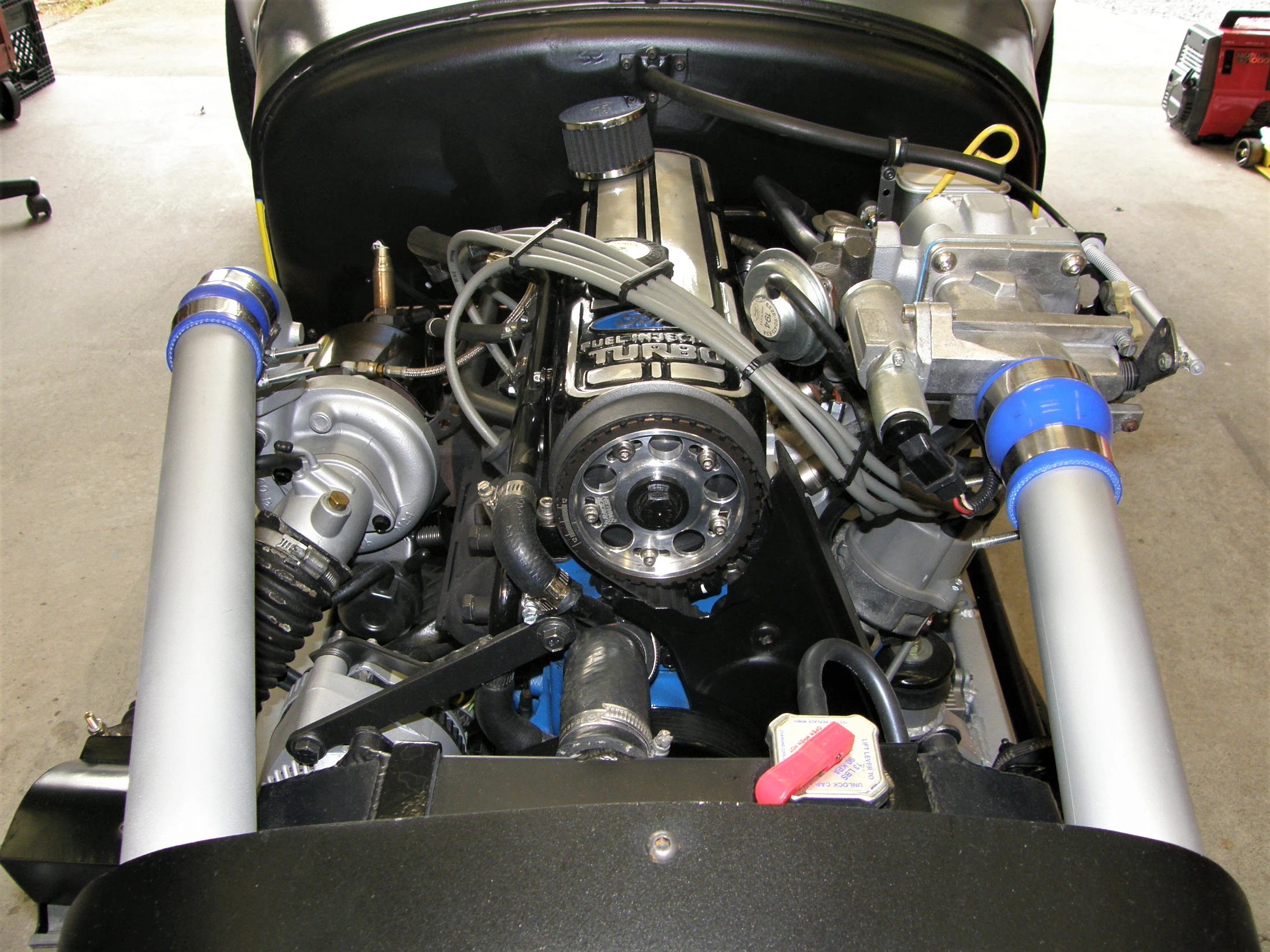

Outstanding! I knew you'd get it figured out! Looking at the first pic, might I suggest adding the factory inner and outer timing cover to the front of the motor. It'll keep all the road debris out of there. You can kinda see mine here. I cut the top circle section off to expose the Racer Walsh cam gear........
Here's the only other pic I have showing the timing cover...........
