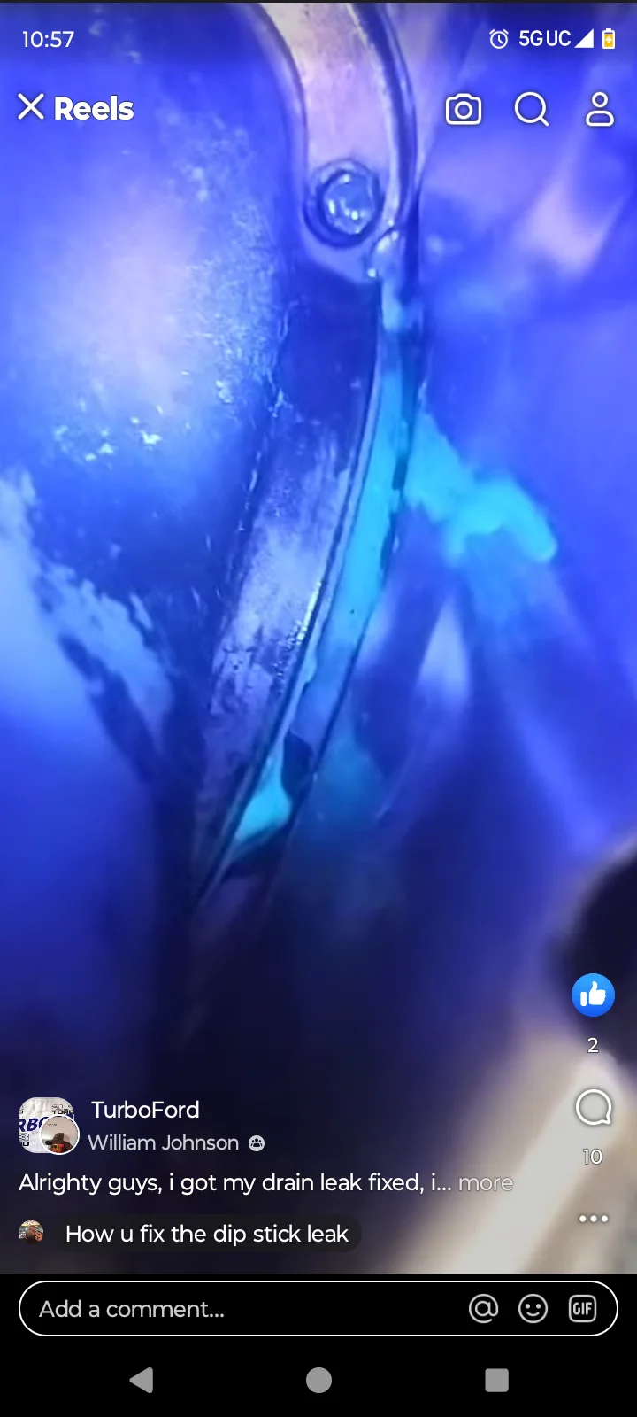

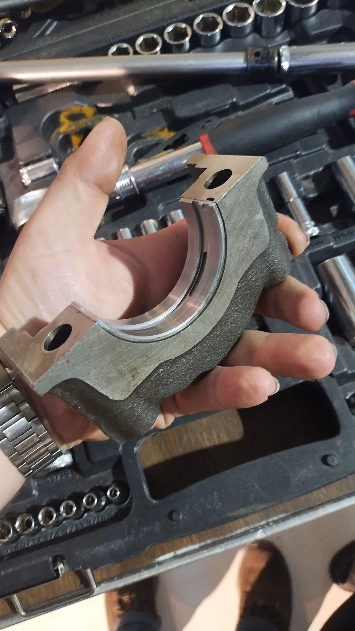

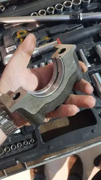

I took my UV light, shined it down by the rear main seal, the oil path follows the oil pan gasket and it looks like the rear main bearing cap. I made a post on the turbo Ford Facebook group and someone mentioned that I could have forgotten to put a smear of rtv on the rear main cap were the cap meets the block and it could be seeping through, wich explains why im getting so much oul so fast, im getting about 1 quart every 30 minutes
Attached is a screenshot of the leak, i got a UV light shining at the seal, so the oil looks white
(I know its a bad picture, im using an old phone now)
What say you guys? Im assuming nows the time to drop the oil pan, change that gasket, and possibly check my main cap right? No harm in doing it either, ill have fresh gaskets and stuff.
Only part im concerned about is how to drop the pan now that the engine is in the car, wich way would be best?

I got my oil leak fixed, turned out there was a bit of overspray from painting the engine that I couldn't see on the sealing surface of the rear main seal, so! I cleaned it all off, and cleaned up the rear main cap as well, changed the oil pan gasket and put the whole motor back in the car. and i had no leaks!

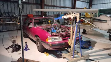

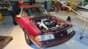

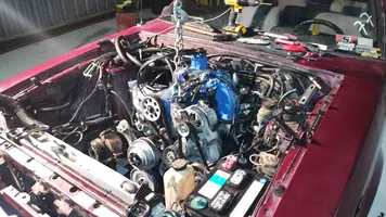

Heres some pics!

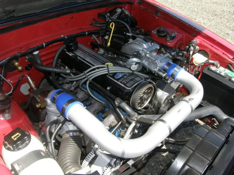

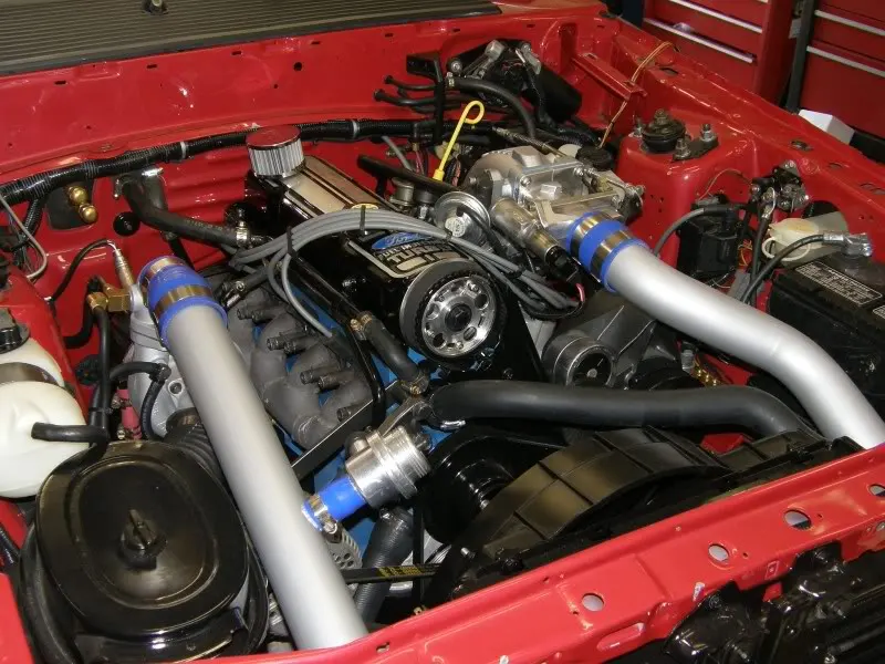

You just keep pluggin' away. Nice work, brother! If I may make a suggestion. Unfortunately, BAR will fail the car for the intercooler. The way around that is to disconnect the current I/C piping. Run 2 silicone 45's off the turbo outlet and throttle body then connect 1 straight piece of tubing between the 45's.
Here's my car with the street setup........
Here it is with the BAR friendly setup..........
I had to go around because of my rotated upper intake. You can just do a straight shot over the valve cover. That will also eliminate your BOV (another fail). Do something about the catch can and make sure you have the correct cat in your exhaust stream. Make sure your timing is where it's supposed to be and don't worry about the cam. Don't worry about oversized exhaust either because, this is one scenario where size DOESN'T matter!
Your objective is to attain one of these..................the golden ticket! Good luck!
