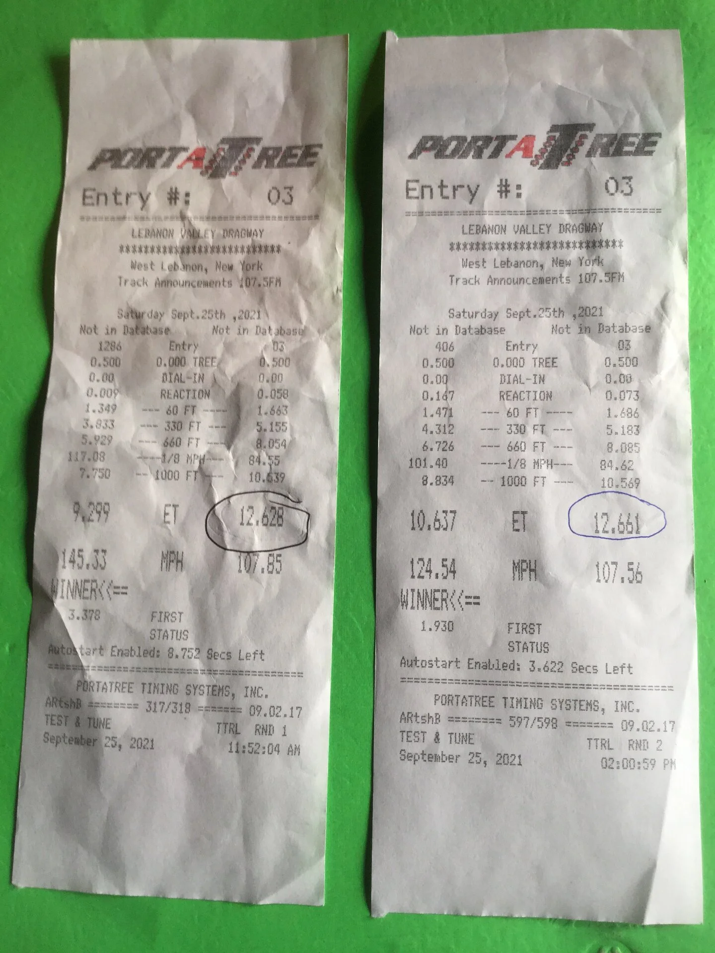

Did 2 runs last weekend trying to be consistent, not for fastest run, for up coming bracket racing events.
My tach will give me peak rpm. It was 6200 and 6250 rpm. Close to the fuel shut off.

You should be in the 12's now and the combo your fellow racer mentioned probably wouldn't gain you anything over your current setup. What rear tires? play with the tire pressure a bit, unbolt one side of your front swaybar for more weight transfer while at the track and practice.
