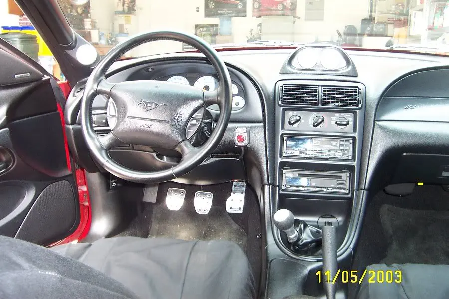

Here is a pic of the BTM red dial. It's located next to the ignition. The box was mounted over the brake booster on the plastic firewall.
Mine is mounted in the former cigarette lighter hole. I would save the money from the BTM and just get a chip burned or buy a moates quarterhorse.. The BTM is the old school way of pulling timing that they used on the older vortech kits before tuning was as easy as it is now. I honestly don't feel the BTM is very accurate and I will be getting rid of mine and just going to a regular msd box sometime soon..

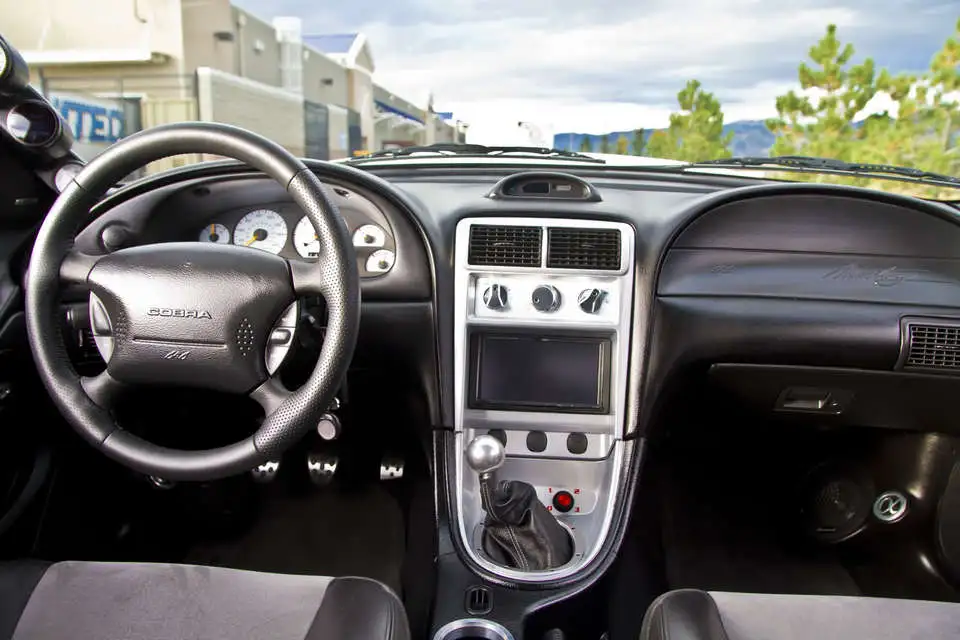

turbogt, what year is that car in the picture above? Looking at the yellow gauge needles, I would say 94-95, but those seats are newer Cobra and that center console is newer Cobra... methinks something is amiss. I would like to get rid of my Mach460 cassette player (who has/uses those anymore?) and the cd unit, but I heard that aftermarket head units aren't compatible with the Mach460 amplifiers so you have to pretty much rip everything out and rewire it all - sounds like a real pain in the arse.
