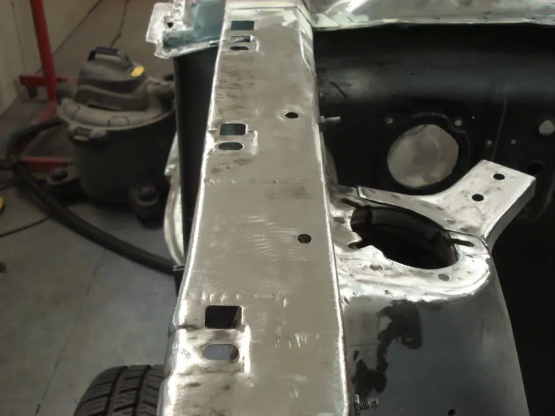

From my experience the biggest hurdle is the fit of the re-pop piece. Other than that it's just the pain of drilling out the spot welds, cursing at the mess you just unconvered and getting on with it. Mine wsn't bad enought to replace but the top of both front and back aprons were a bit of a mess. Since I'm building a mild resotmod I alse welded the aprons together to make it look cleaner.

^^^I like that, Rob. It will look very clean. Any thoughts on the best supplier for the piece?
