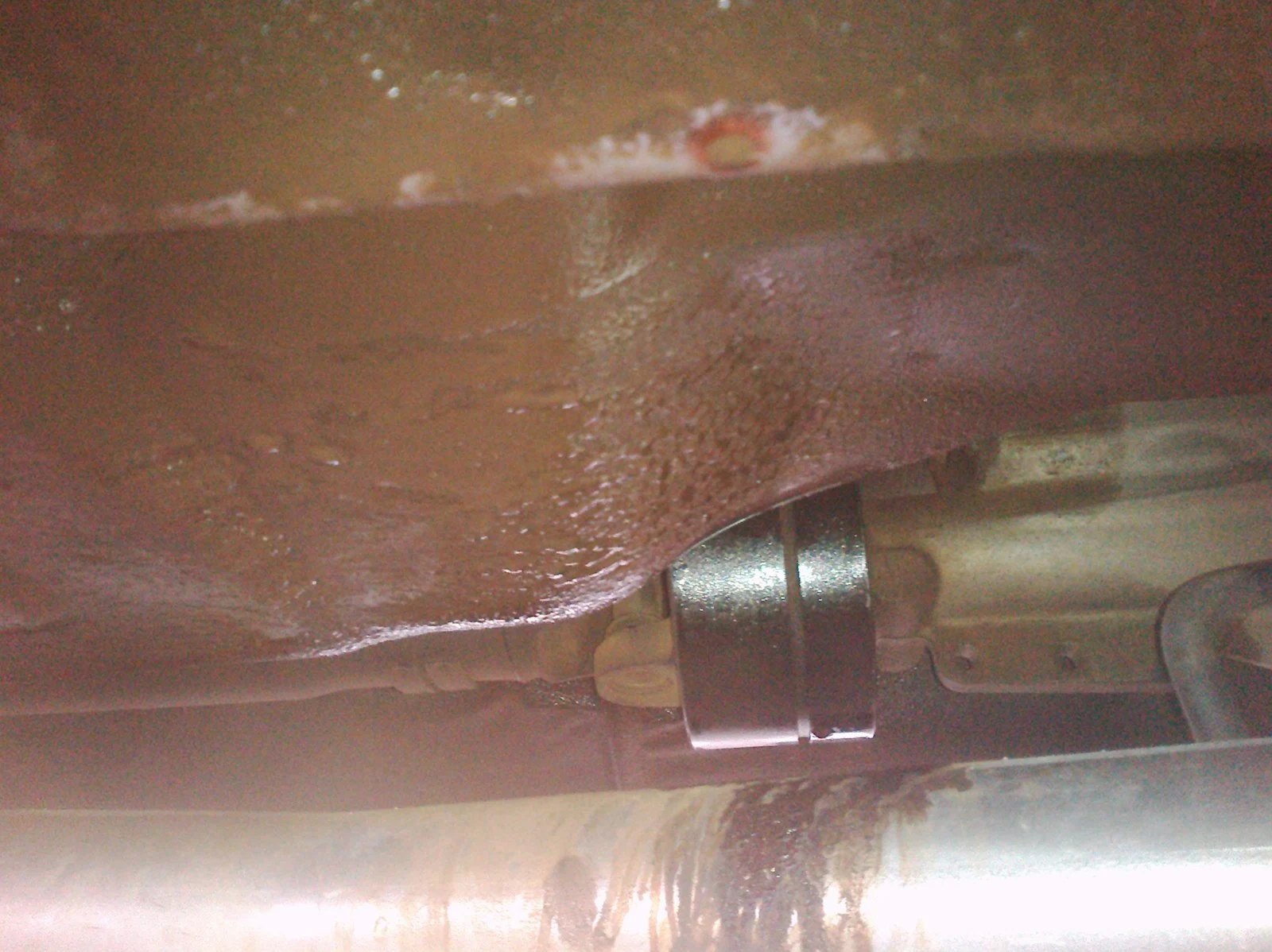

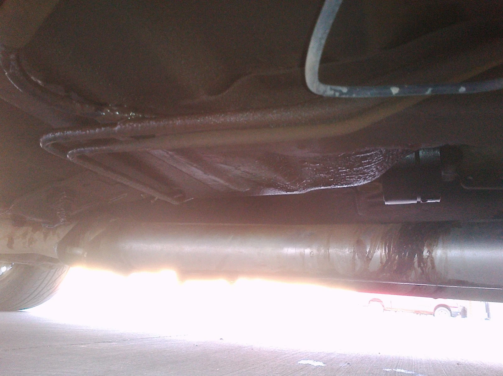

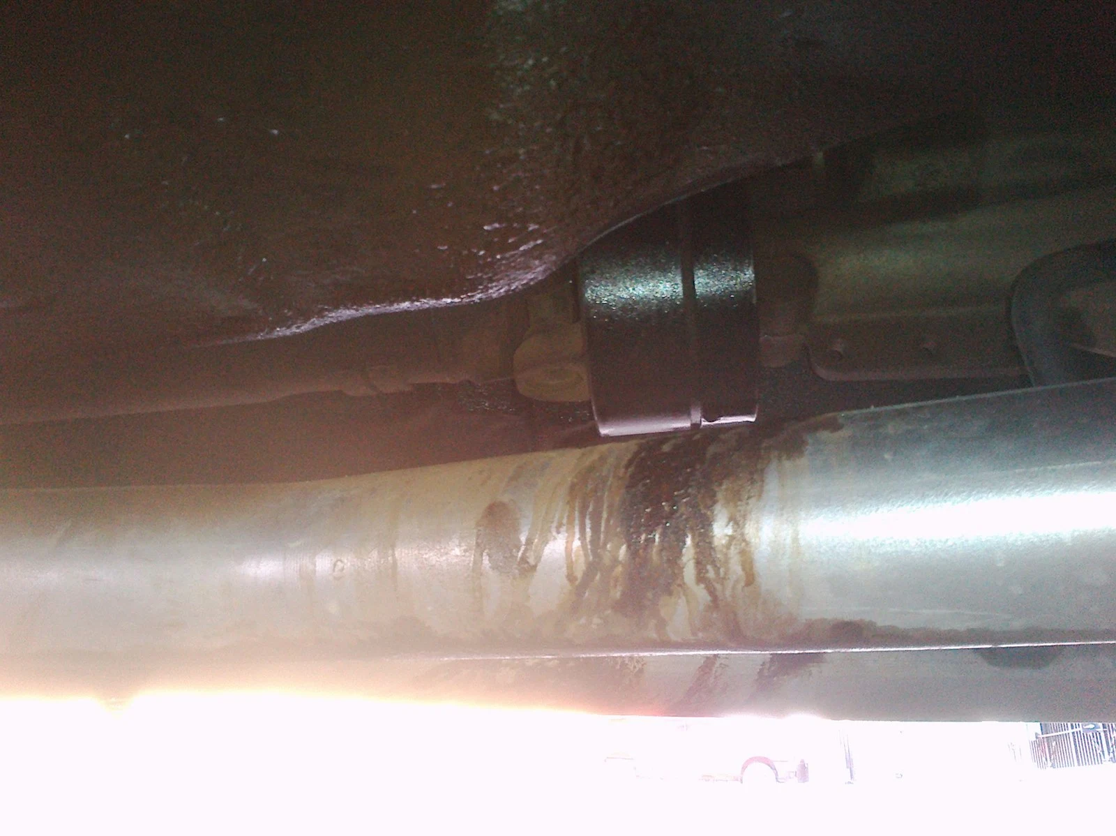

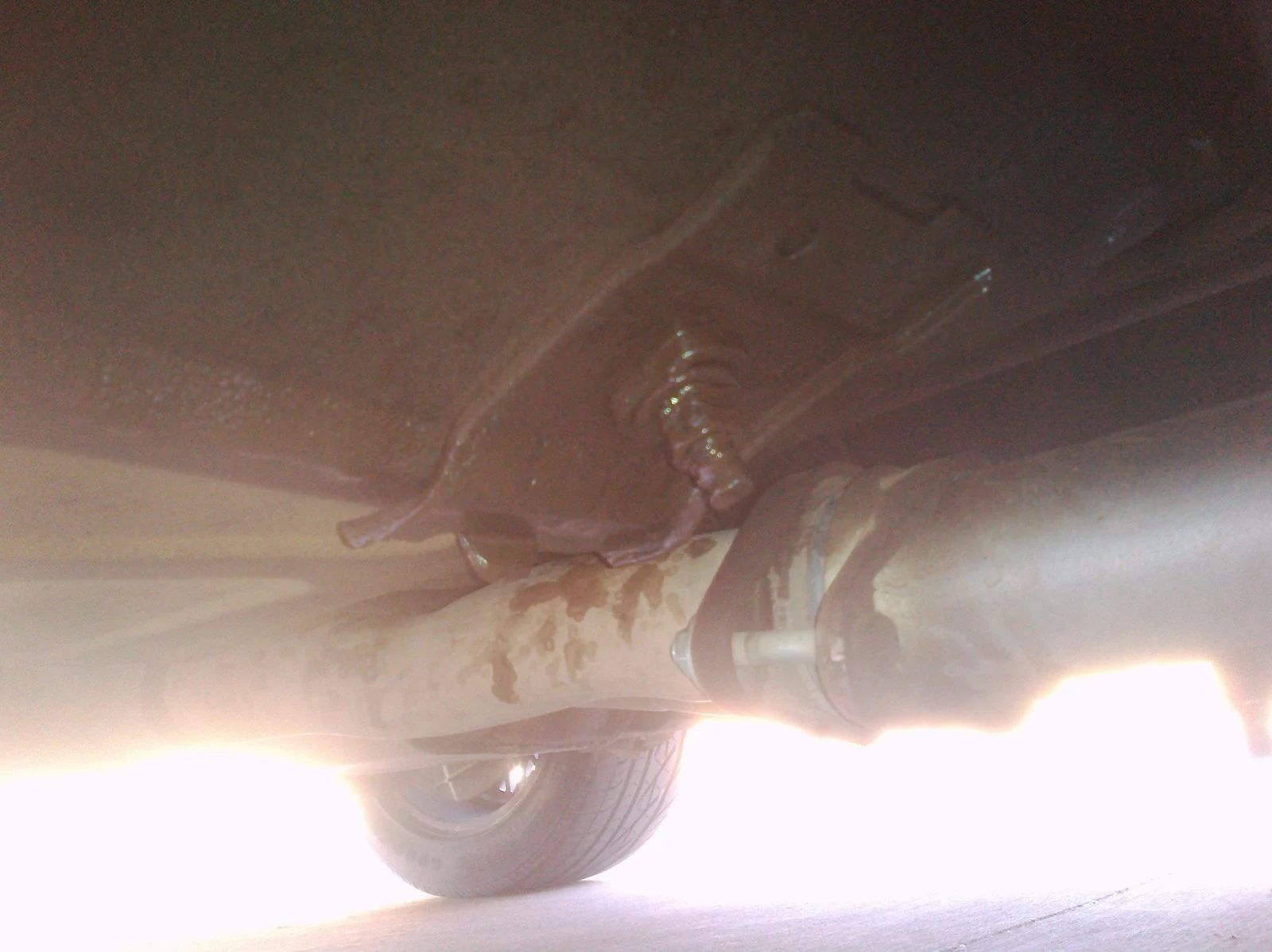

Thanks for the suggestions, I hope the booster is failing, that sounds expensive. Also, when coming out of work the other day I noticed a small puddle under the car. I thought, that can't be good. I looked and this is what I found.
That looks like your trans output seal is leaking...
The brake line does run through that area..so you'll want to check it out
Awesome, looks like I have some work to do this summer. This is why I am going to buy another daily driver, so when this happens I don't have much to worry about. Is there a temporary fix for this? Like just keep topping off the fluid until I finish with finals?
What most likely happened - hope that it is this and not the bushing- is the rubber tail shaft seal is worn or cracked. It's a $5 piece. You'll need to remove the driveshaft, and then carefully with a hook or small screwdriver pull the old seal out. If its the bushing, then the whole tail housing needs to come off. Before you take out the drieveshaft, try and measure or feel the amount of play when you wobble the drive shaft. It shouldn't be more than an 1/8 to 1/4 of an inch IMO. If it is, chances are the bushing is worn.
You are going to keep pissing out fluid until its fixed. Stay on top of the fluid level as that is an easy way to fry an AOD.
Same deal...low fluid in a T-5 can score the mainshaft and cause the trans to whine like a bitch. Only way to repair is replace the mainshaft....
so stay on top of keeping the level of fluid full.
