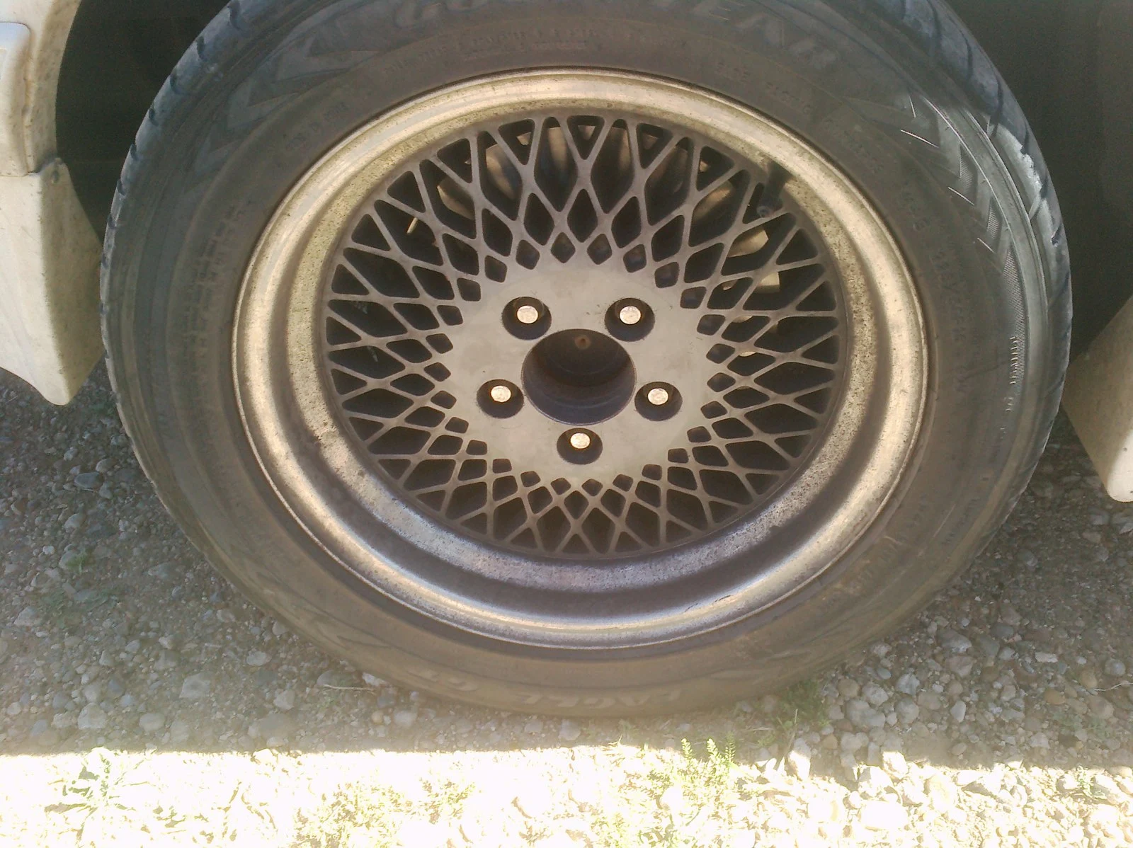

I have 5 lug wheels. The MC has two lines coming out of it. Yes let me go out there and snap a couple real quick.

Prob Sn95 brakes then.
Pics of MC, booster, front and rear calipers would help ID it

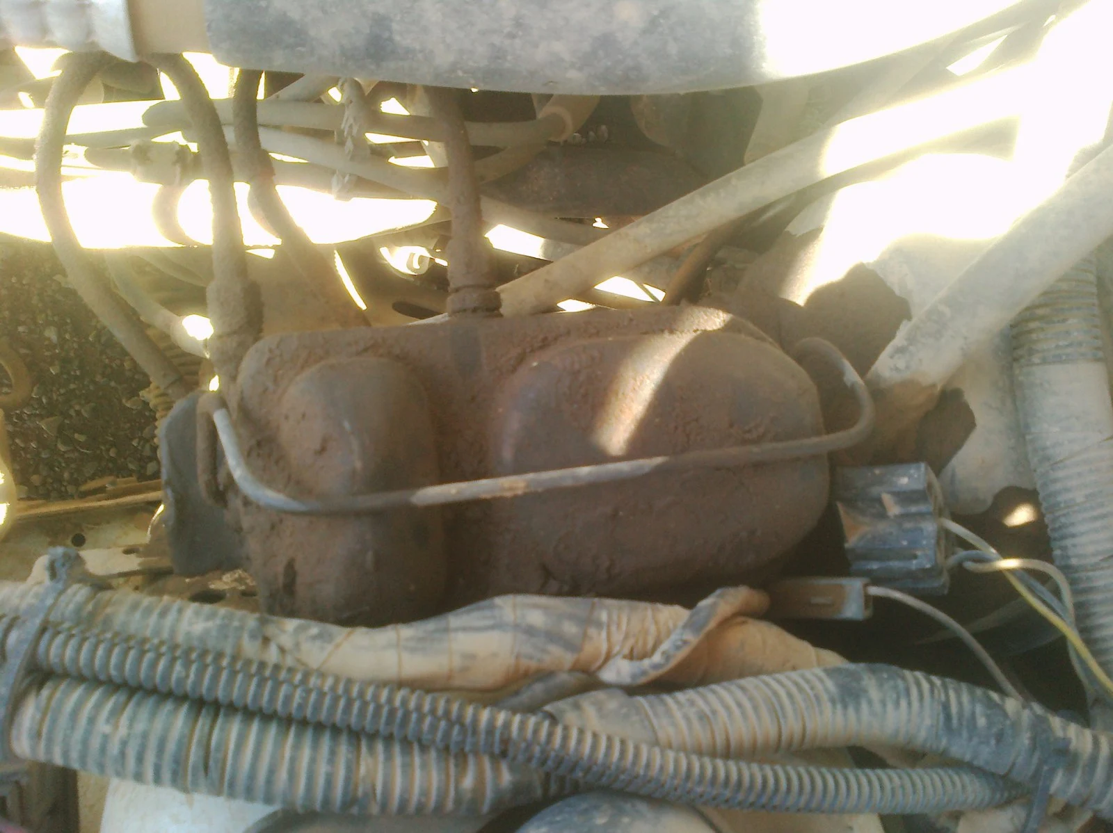

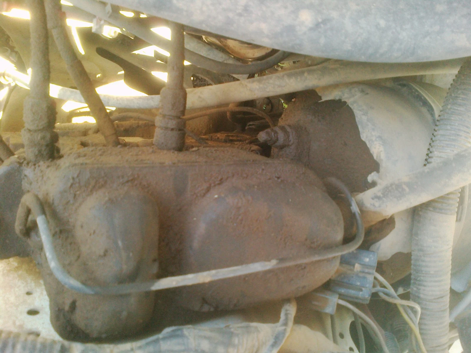

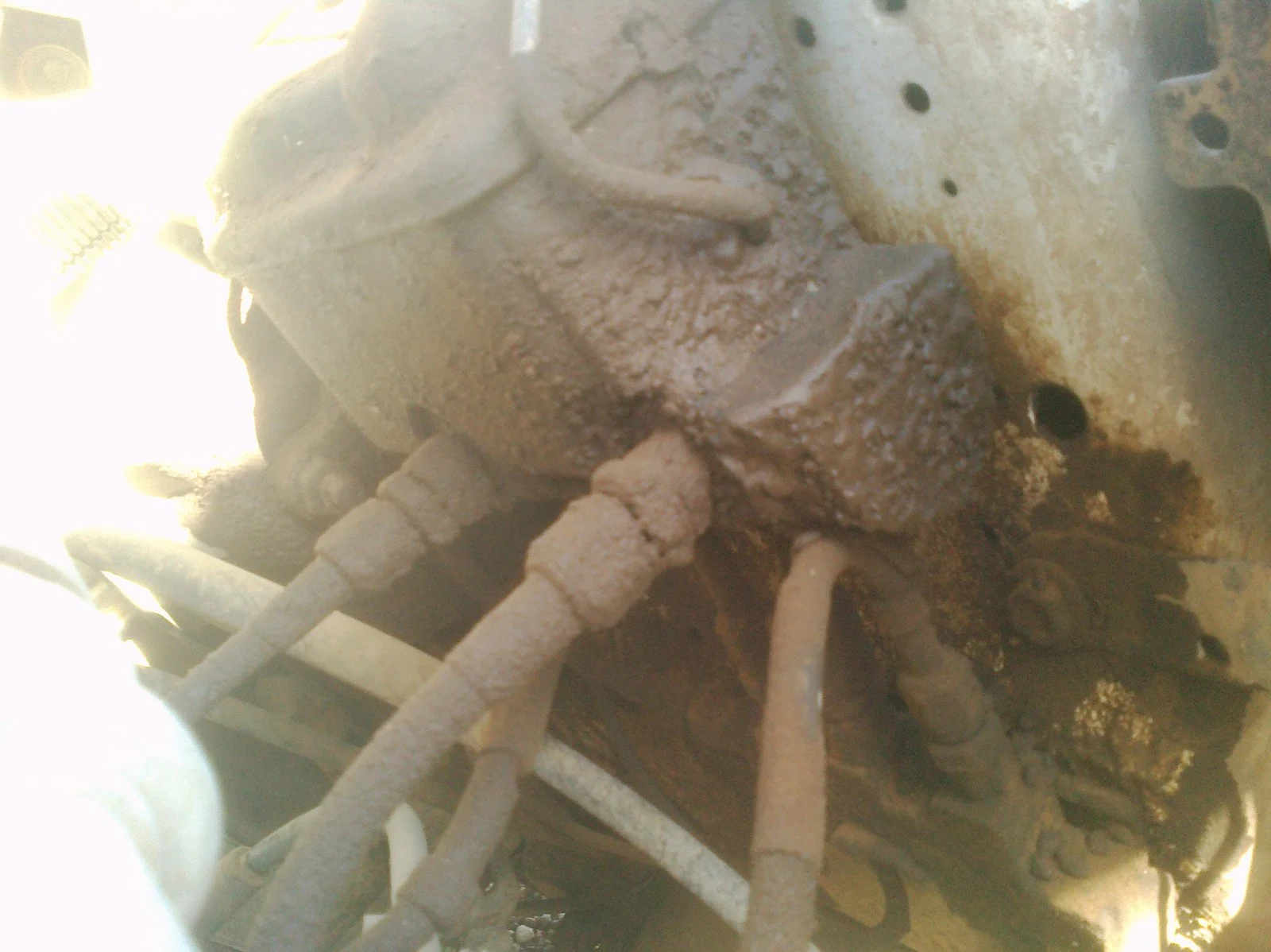

Wow, you are going to want to address that. You are def losing fluid. The fluid all over the booster suggests that is probably bad as wel due to the fluid eating the internal rubber seals.
I'm going to guess that that is a 1985 Lincoln Town car MC judging by the fact that it is cast iron and rusted to hell. 84-86 Mustang SVO master's are aluminum. However, some parts stores do sell cast versions.
Really need to see the brakes on the car to tell you what MC should be there. Who knows what fittings the owner used to adapt the MC to the car. Judging from the pics...there are plenty of leaks.
Try and clean up some of that fluid in the meantime with degreaser and then carb cleaner. BRake fluid is corrorisive and if you aren't careful, it will begin to turn the metal on that inner fender to rust and it will need to be repaired by a body shop.
Def a repair you want to get on ASAP
