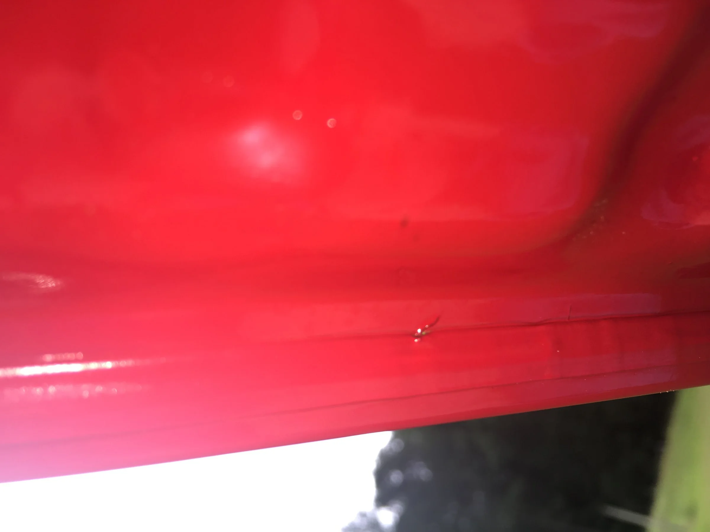

Well after only driving it 1000 miles on the car in past couple months. I have ran it through the car wash (touchless) a few times and got around to waxing it by hand.
Lone behold a bunch of rock chips. On the hood and above the passenger window.
Called Ford and they said they do not cover rock chips but now if there was trash in the paint.
Well turns out there is a bunch of trash in the paint as well.
Ford has escalated this now because there is trash in the paint all over the car. :(

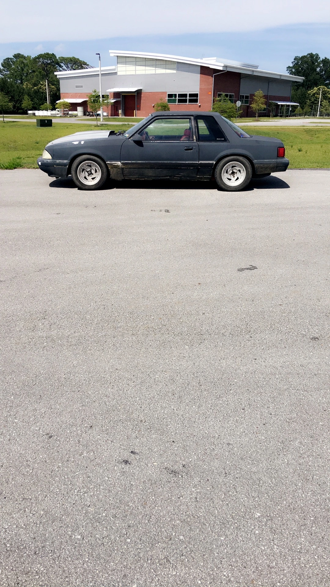

Foxbody runs like a champ and now the DD

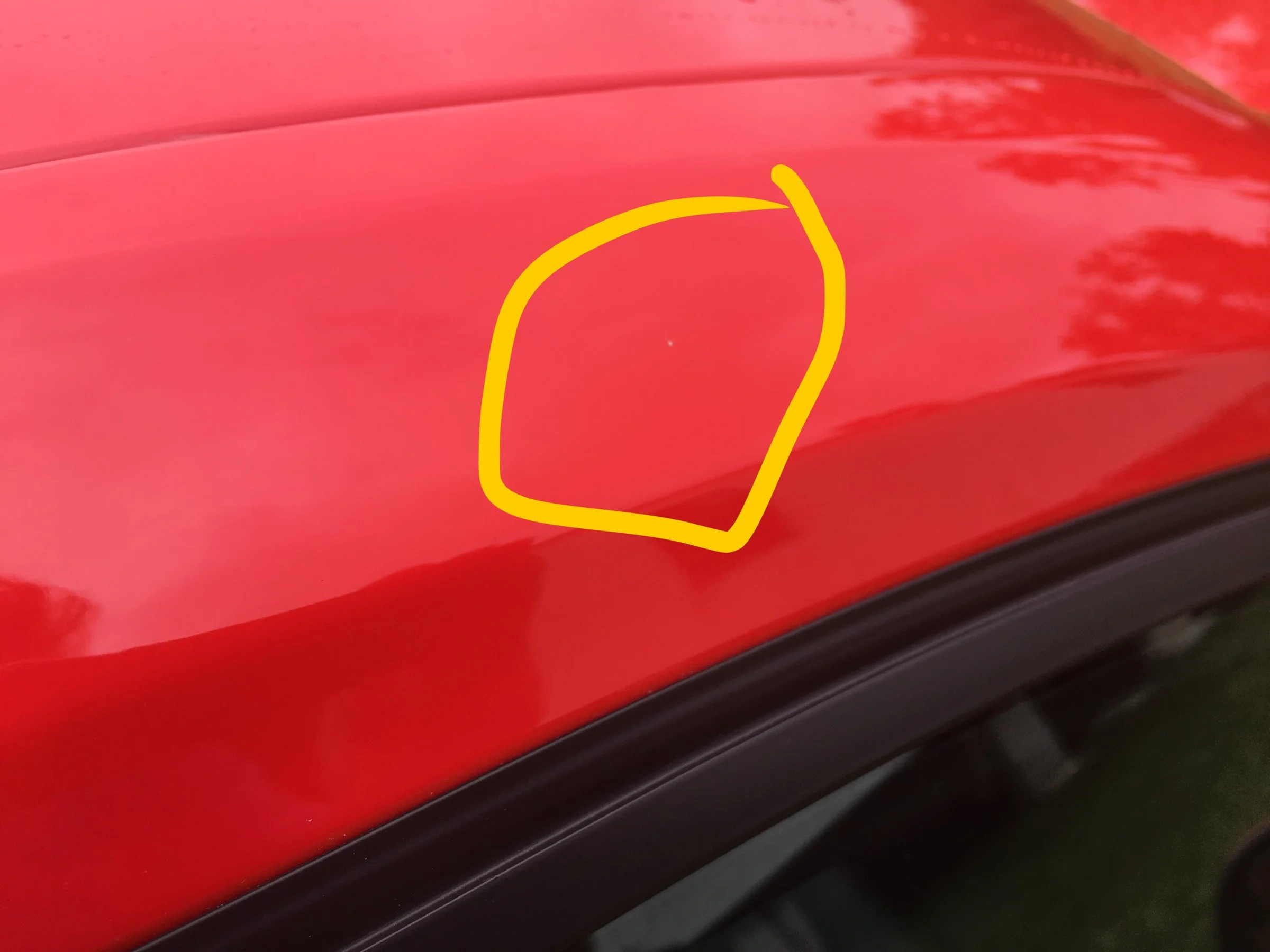

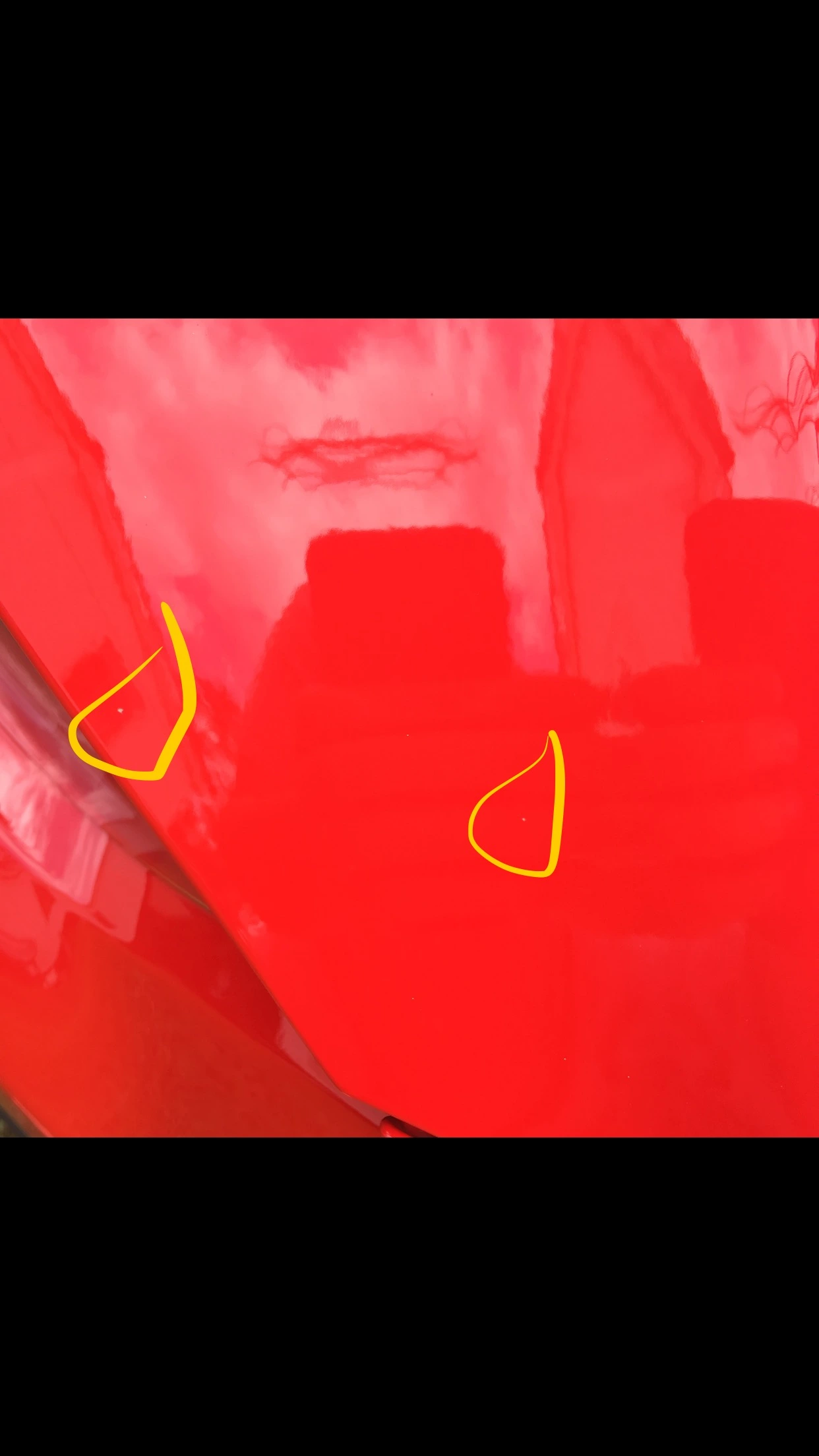

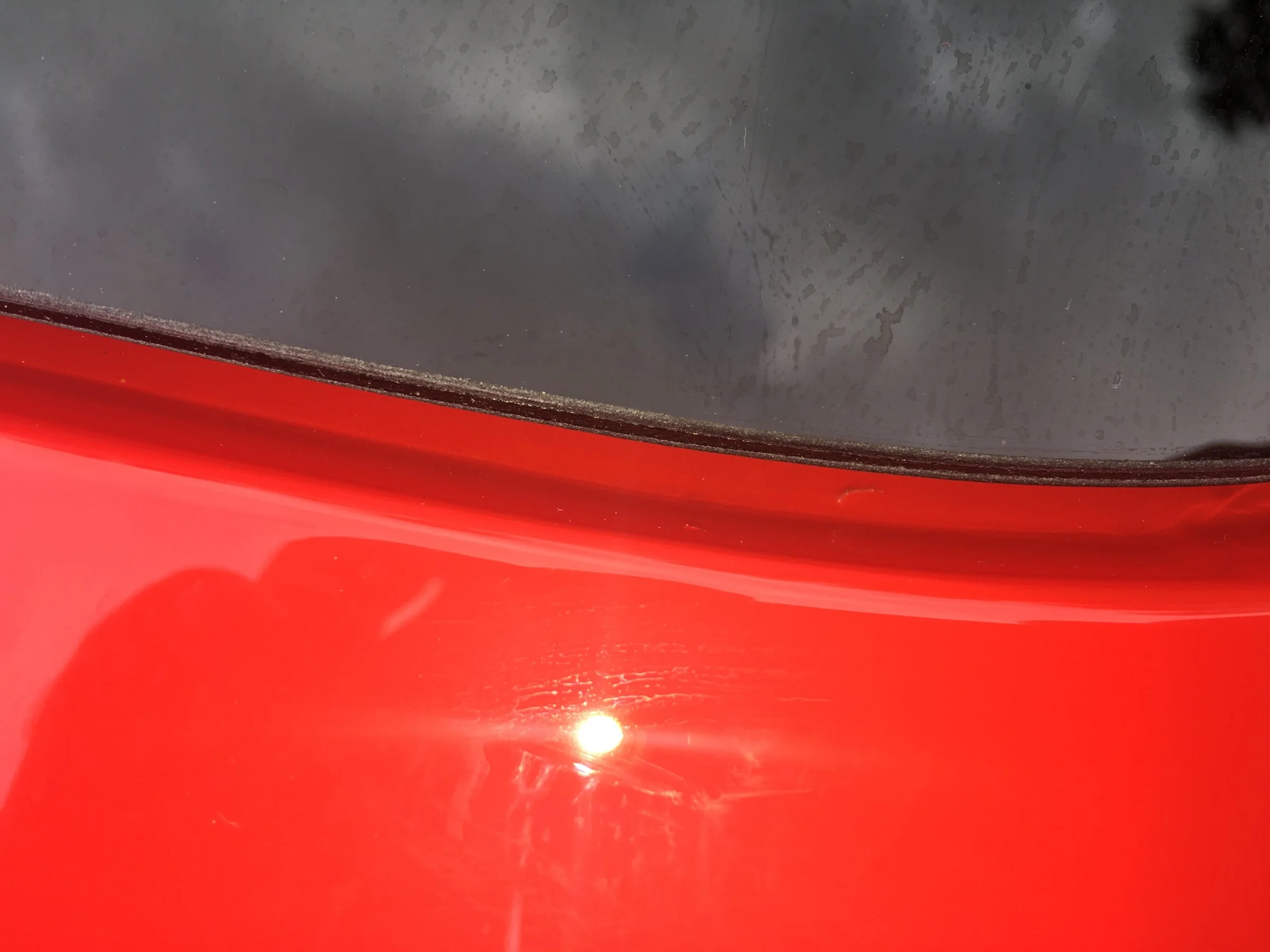

The car looks great walking by. However when I found the chips and hand washed it. I found about 7 places that snagged the microfiber. I called the dealership around 800 miles and said i had a few chips and wanted to show them.
Here are the two on the hood
Finally got a chance this week. The one dumba$$ salesman kept trying to scratch the chip on the roof with finger :mad::dammit::chair:.
The service manager was very helpful though, but I politely told scratch mic scratchersion to get away from my car.
I mean it looks great far away though, but im afraid to drive the car because of chips now.
Btw, the notch looks like it could use some love......... and I'm not talking about the kind you give a hooker. I'm talkin some tender love and care.
Now didn't your moma teach you it's what on the inside that counts. Haha jk
Nah she is good just needs to be resealed with satin black and some flat clear. She hit a high 13 the other day 1/4 and is averaging 23 mpg. :rock:

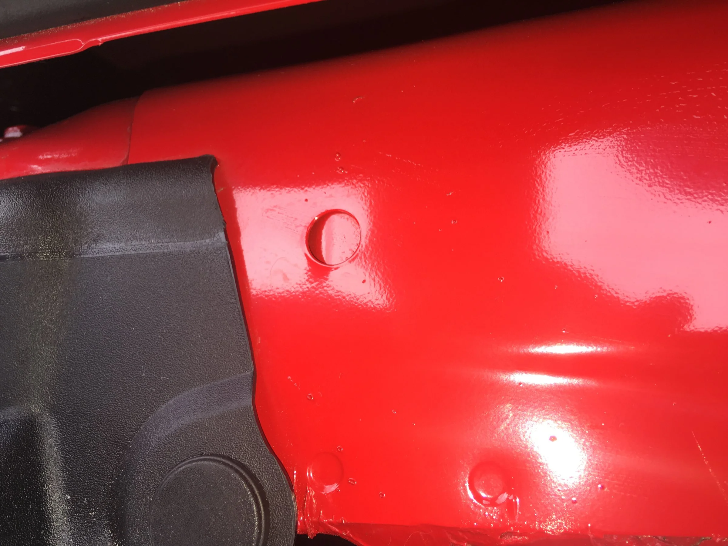

Hopefully Ford makes it right. The other Race Red one I drove had more trash in its paint believe it or not. found this one and I didnt see anything at first. But as you can see, I missed some things.:cry:
Such a shame. The paint on my '14 Taurus is actually pretty decent. Wonder how that got past QA because those are some pretty bad runs
See i was thinking the same thing for 35k car. My 14 Escape and 15 Focus paint were spot on. Like i said it may be a Race Red thing, because the black accent package GT i drove for a week had large piece of trash in the paint on the quarter panel.

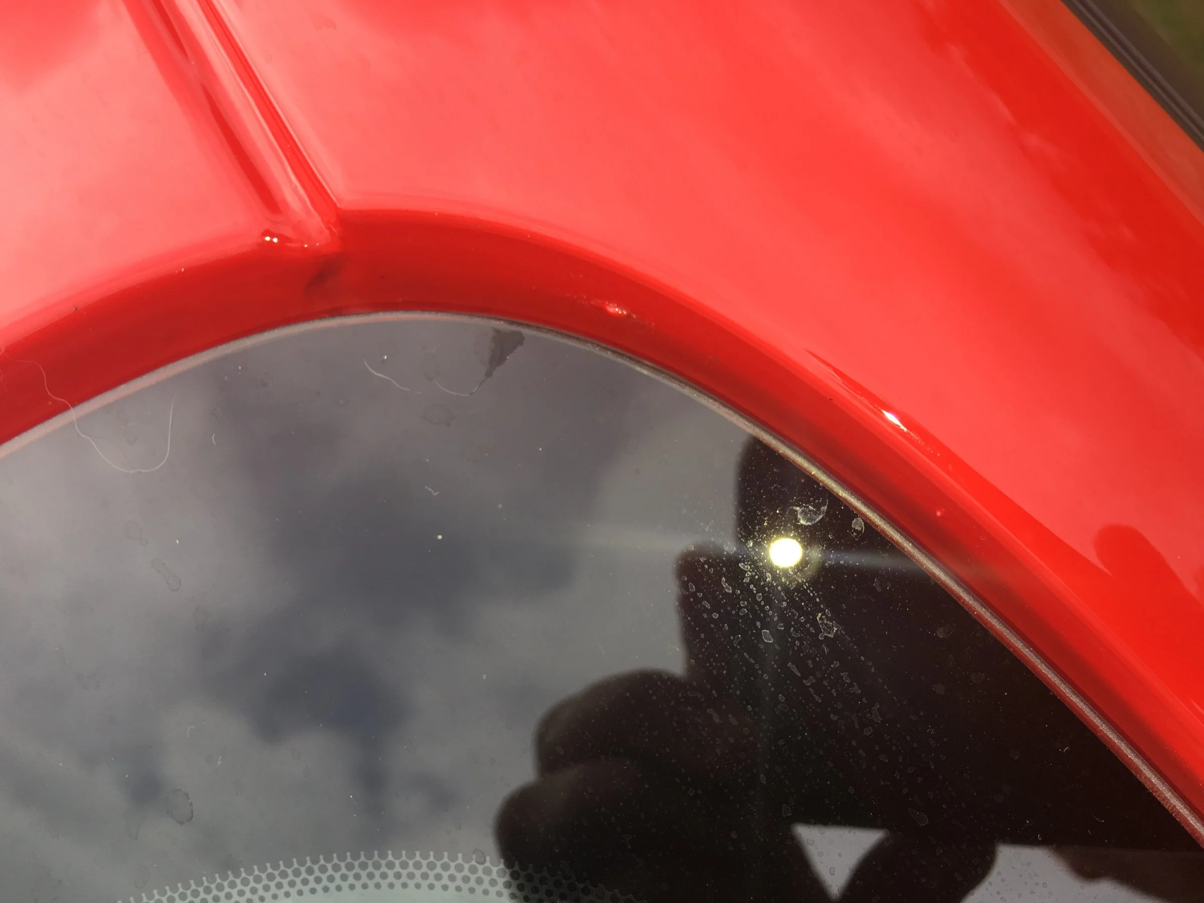

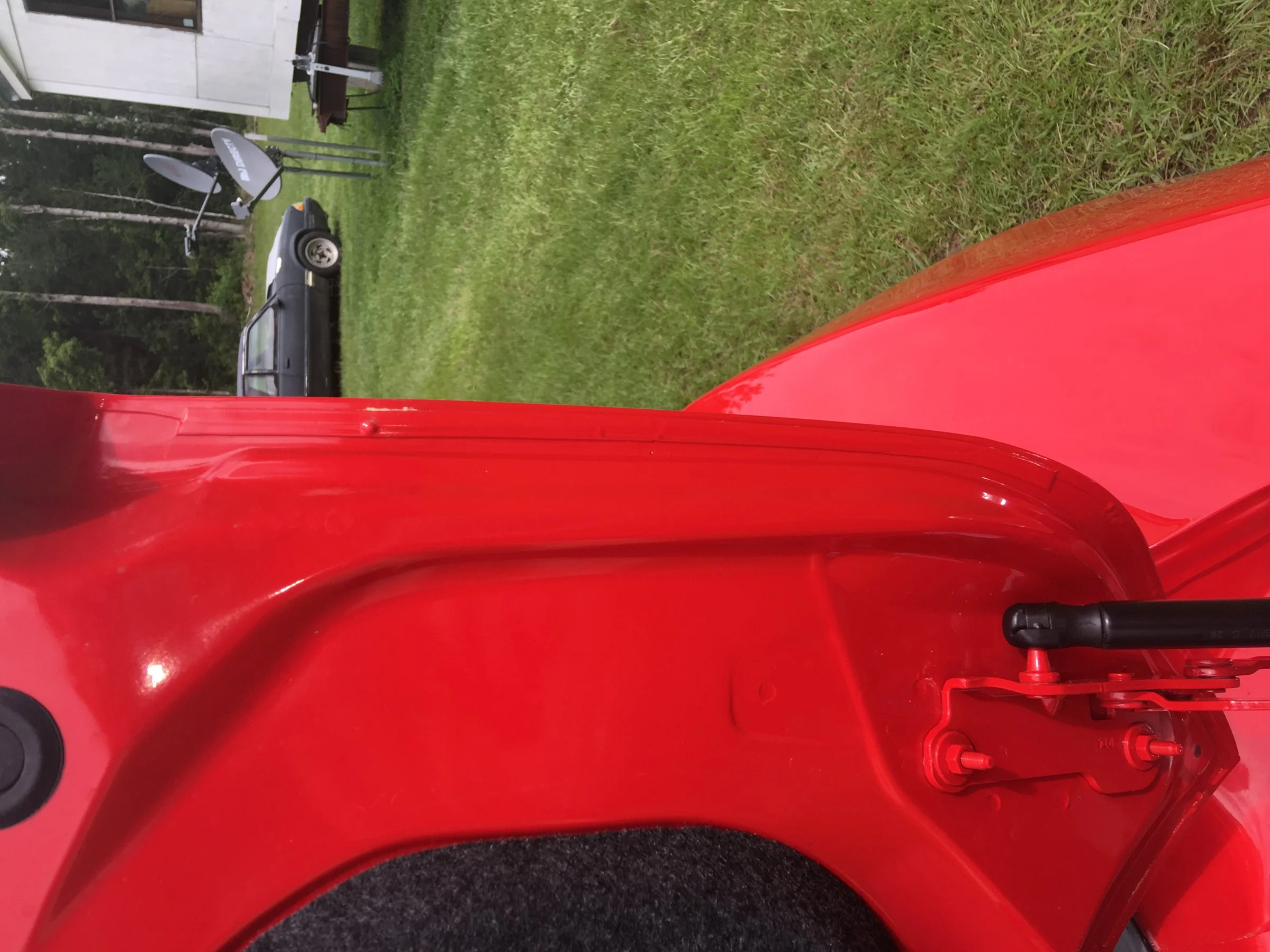

This one seems to be around the windshields under the hood and trunk lid/ jambs. The chips are what caused me to look closer.
I'm at the point I don't want a respray, just give me a different color one and call it square....wishful thinking.
Btw those aren't runs but chunks of trash smh.

I somewhat understand it though. Ford, as well as the other manufacturers do quality assurance inspections. They got crazy on them 15-20 years ago. When a flaw was detected, the vehicle was pulled to the side, the blemish sanded smooth and run through the paint process again.
This lead to me stripping a number of new vehicles back then. I remember one F150 at the time that had received seven paint jobs.
What they do now is if the blemish (like your dirt) is considered to be negligible, they'll ship it to the dealers with the premise being the dealers will nib and buff the dirt out.
That "should" have been done to your mustang.
I work at a dodge dealership and see dirt on practically every new car or truck we receive.
The dealership has a team that preps the cars to be delivered. One of their jobs is to remove those dirt nibs.
I'd go back to the dealer and tell them you want this taken care of.
If you want to do it yourself, it's the same process as you would do for nibs in any paint job. Though that one by the glass is fairly large, you might cut through the clear and base trying to remove it. Maybe you ought to let the dealer handle it. If they cut through, they have to fix it..

I took it to the dealership and they are talking with Ford. I wouldn't tackle the paint myself nor should I on a new car (just my opinion). Around the windows and trunk is a lot of trash. I'm not seeing away around them not taking out the windshield.
My concern is why the heck is it chipping so dam easy. I looked at the Chipdoctor kit (clean, glob, smear and wipe) it has a leveler and seems to good to be true.
Like I said should I be comfortable with them doing a respray if they take that route?
