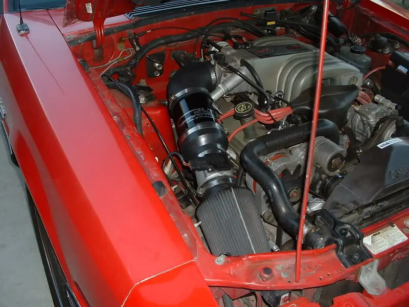

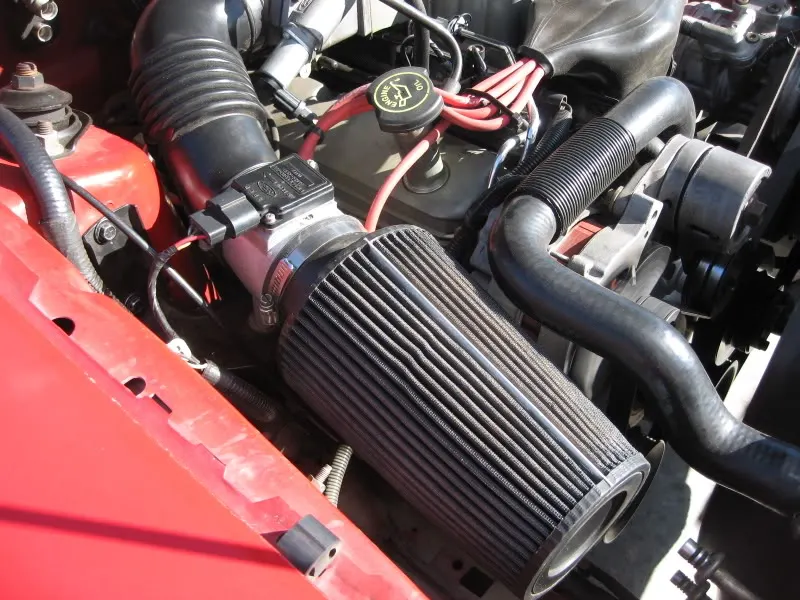

C&L 76mm maf with stock inlet and throttle body with no problems. i just installed a jlt RAI, and im having idling problems.
i checked the surging list that u guys have, i clened the iac valve and rotated the maf around, seafoamed it, put some techron fuel injector cleaner and 91 octane and the car still surges below 1k rpms. when i first start her up i need to give it gas 1.5k rpms to keep her on. after that it idles somewhat rough, not horribly bad but not like it used to. what can be wrong???? i dont have a multimeter so i dont know how to set the tps.???

Putting the air cleaner in the engine compartment is a BIG no no. It sucks up hot air and makes less power than the stock airbox. The uneven airflow due to the fan makes the airflow through the MAF unstable, which leads to all sorts of performance problems.
You guys with idle problems could same a lot of time chasing your tails if you would go through the Surging Idle Checklist. Over 50 different people contributed information to it. The first post has all the fixes, and steps through the how to find and fix you idle problems without spending a lot of time and money. I continue to update it as more people post fixes or ask questions. You can post questions to that sticky and have your name and idle problem recognized. The guys with original problems and fixes get their posts added to the main fix.
The proceedue to se the TPS is in the first post of the sticky.
