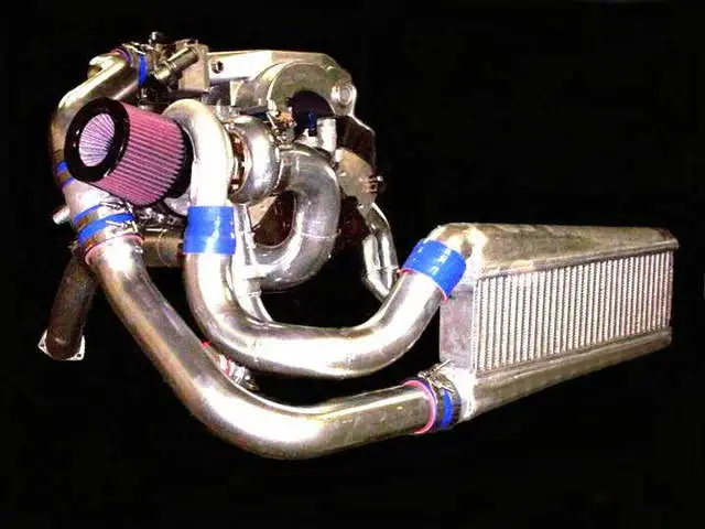

IM GETTING READY TO ORDER THE HP PERFORMANCE TURBO KIT :D
After seeing the build up in the mm&ff on the stock motor fox im no longer going to get a supercharger they changed my mind.
They got 433 rwhp and 493 rwtq on 10 psi of boost and a stock efi motor.
I will get pictures of it and my install when it arrives :nice:
The kit costs 4500.00 here it is http://www.turbochargedpower.com/79-93 Mustang.htm
I was looking at the blowzilla/flowzilla and by the time i got everything i needed it would be about the same price
HERE IS A PICTURE OF IT
