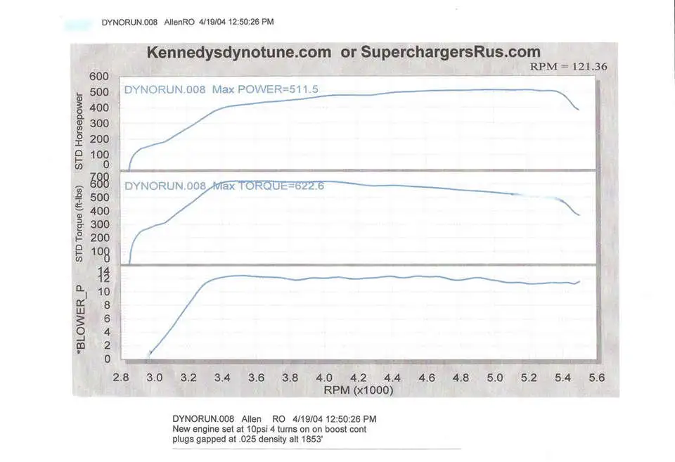

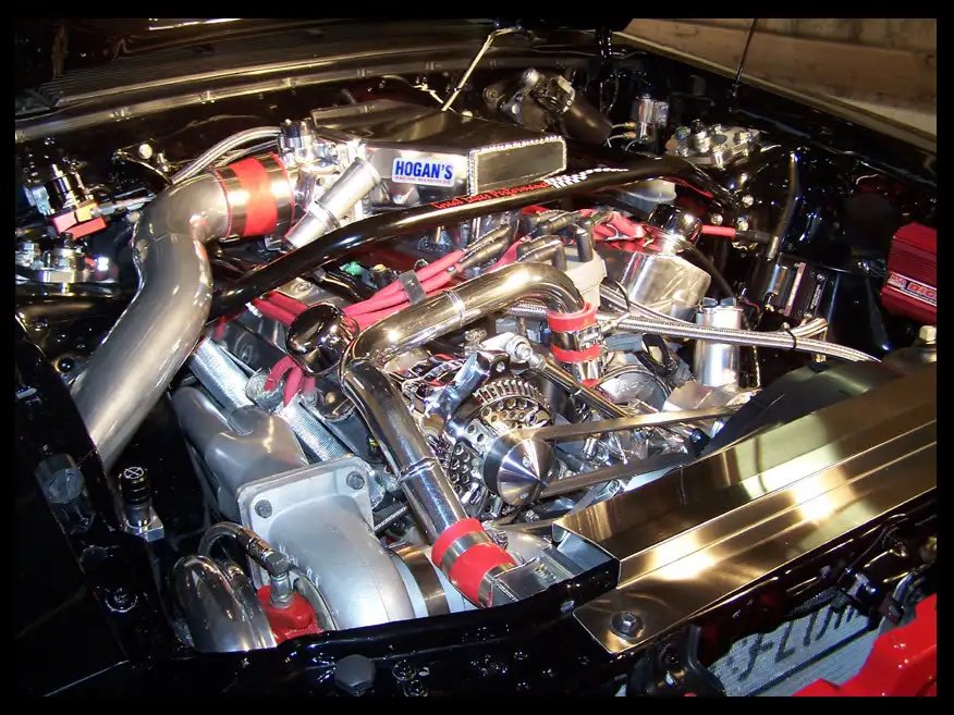

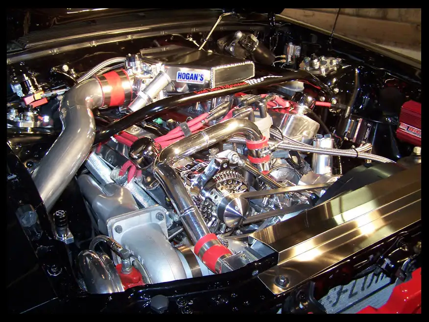

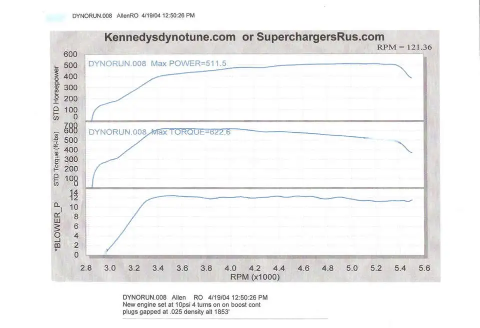

Welcome to turbo world, I have had my HP kit for going on 5 years. Make sure you have a reliable air/fuel meter the best is innovate (most accurate). if I can help with any questions give me a p.m. Here is how pretty that HP kit is gonna look:lol: And here is dyno sheet with my old heads and intake combo, haven't been to the dyno with the Hogan/Trick Flow set up, but I think it's gonna be better.

Is it streetable? How about 30K miles worth . It's a DSS block but isn't that a stock block in all reality? It is way more streetable since I installed the XPI Timing lock instead of having the timing locked out at 20 degrees, which is what I ran for 30K miles. It is truely insane to drive, it commands a lot of self control. Other people have vids of the car out on the highway, I'll see if i can snag one. I would not be afraid to use this kit on a stocker if you have a good tune ,a reliable air/fuel meter and realize that you will NOT be able to use the full 20# of boost that the kit is capable of. This turbo made 25RWHP/lb. of boost,which is insane compared to a supercharger, that puts me close to another 200-250 rwhp if i had the block to hold it. Also note the turbo lag (not):lol:
