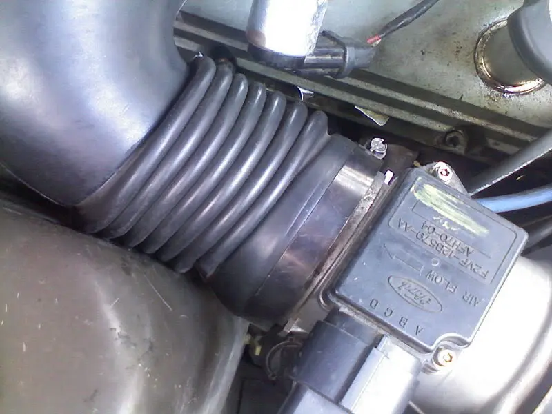

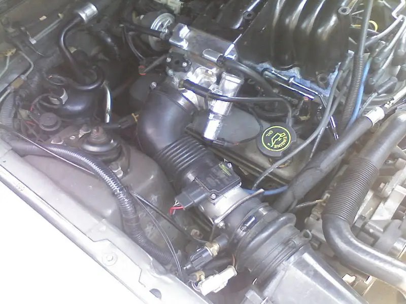

No if you use the adaptor for the flange to make it fit in the stock box the tb elbow will be too long. I have a 70mm TB and 70mm MAF out of a lincoln towncar and BKCAULEY cut my stock tube to fit as a ghetto rig at the track lol. It doesn't look bad,, you can't tell b/c of the clamp covering the swiss army knife cuts :D
I'll take a pic.
Well my upper intake is off right now, but you get the point. It had to be cut almost right up to the coils to fit, but its functional, it just looks a little stubby.
Edit: but by reading your first post again it will still squeeze over the larger units. it just has to be shortened.
