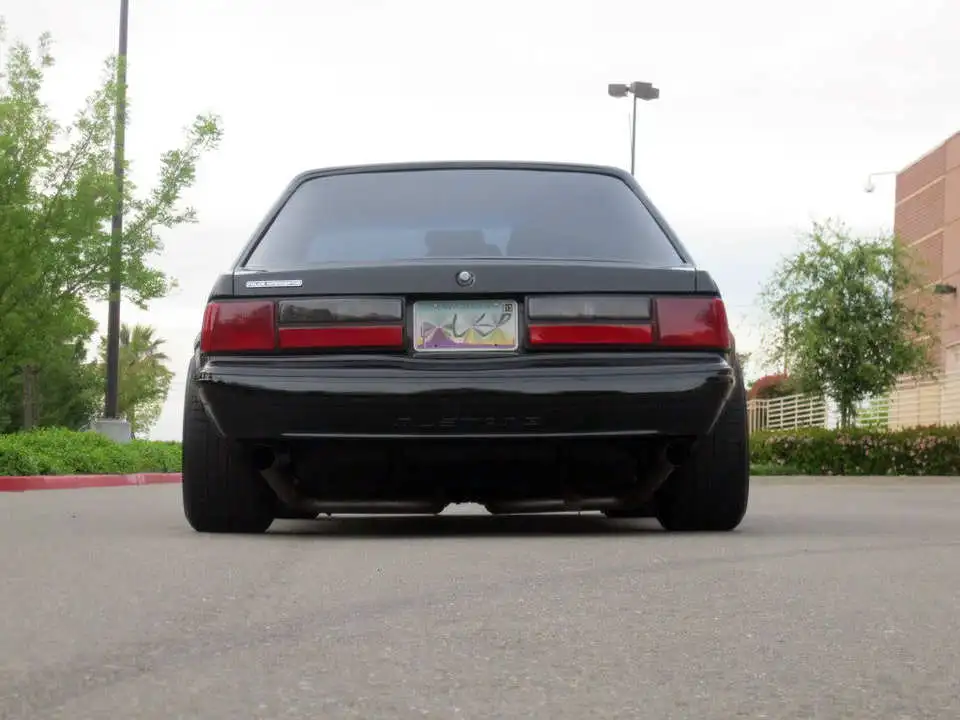

It recently came to my attention that 03/04 Cobra catbacks bolt onto Foxbodies and fit great. This would solve a lot of problems for me which currently prevent me from running tailpipes at all. However, I'm not sure if it'll fit with a panhard bar and torque arm in place. Anybody know if it will?

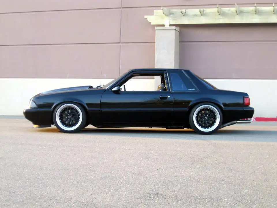

Here it is installed on a foxbody but without TA/PHB

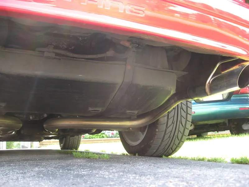

Don't know if it will work with the phb/TA arrangement, but here is a better pic for you. On a fox body LX. My only concern would be potential ground clearance and/or wheel interference issues
BTW, I just noticed the car in the pic you posted has an IRS not solid rear axle. Look at the camber on the rear wheels......
Thanks for the closeup. I'm thinking it would probably clear the T/A, what's a more likely issue is the panhard bar. The bar itself peeks below the gas tank at just about the same height as that exhaust.
