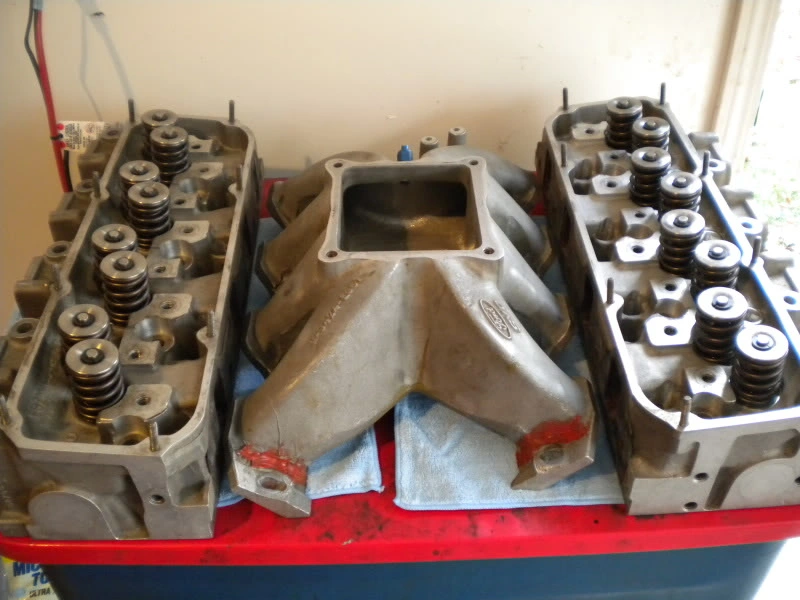

I didn't want to highjack 281pony's thread so I started this one. Wow, this forum has me second guessing myself now! I knew I was going to be laid off again this winter so I bought an 87 gt this last fall to give me something to do this winter. So far I have bought all this to build a 418 stroker when I was just building something to just play around with: c-9 block, a set of c-3 yates heads with matching intake, eagle forged crank and rods, diamond 36 dish pistons, jesel roller rockers, Isky 714" roller cam and I'm not even close to being done. The engine is at the machine shop now. I'm wanting to go with a c-4 trans, but the way funds are looking, the T-5 is staying for awhile. It has an 8.8 with 4.10's. I got a really good deal on the heads, which are only 40cc's, this why I have had to go the route of the diamond 36 dish pistons. I should be around 10.5-1 compression. I am not wanting a race car, just a fun street car. Please feel free to voice your opinions on what some of you guys would do.

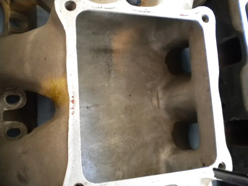

The heads and intake are usually a matched set as used on circle track engines. Typically, the C3's come in many different variations-and that is why I tell people that are interested in them to stray away unless you know EXACTLY what you're getting.
Many (most?) are set up to run a very narrow RPM band. On asphault engines, typically 7800-9500 RPM. Some of the shorter track engines are built run run 6500-8000. Below those RPM levels they're really not set up to run. Bucking, rough running, run fat to stay alive, that type thing.
And most of the Yates style manifolds-especially NASCAR asphault track stuff-they don't do squat until they're 7000 RPM or better. HUGE plenums and runners with a cross section approacing (or exceeding) those of most drag race, street-strip big block engines with 100 more inches to feed.
The camshafts are same way. Narrow RPM band on most circle track stuff. responsive on the low end but not much power-or not AS much power as a good custom cam should be.
I say since you have the stuff, run it and see how it works out. Yeah it'll be a monster but at more RPM than a typical serious play toy street car will ever see BUT it should still be fun. Just not optimal.
Now stick a pair of hair dryers on it and that RPM band comes down and power goes up. WAY up ;)
