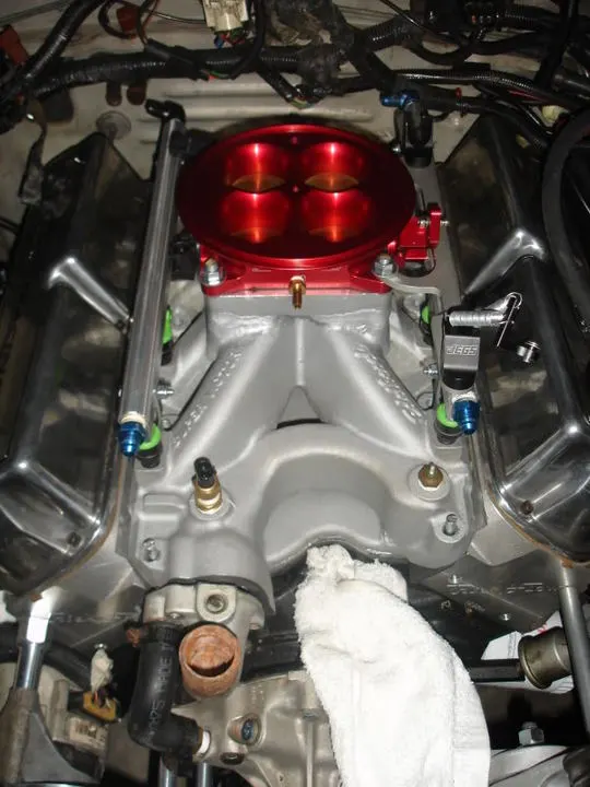

I think going carb is definitely going to save you a good bit of money and allow you the best chance to feed it the air it is going to need. If you go EFI, you would more than likely have to run a FAST if not for tuning concerns, but then likely so you could run a carb style 4 barrel TB that does not use a mass air meter.
I switched to a FAST bank-to-bank and Accufab 4 barrel Dominator style TB which required having the Super Victor EFI intake fabbed to accept the TB.

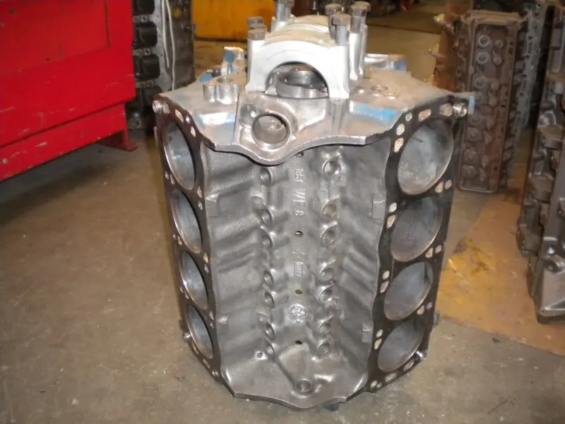

Buy a good set of micrometers and a dial bore gauge and hand measure everything, throw the plastigauge in the trash.
I asked if he would refer anyone to build it and he suggested that he would give me all the tools and knowledge to do it myself, so I'm going this route.
The only problem I have here is that I do not know all the allowances or clearances. I'm thinking that .003 is the max, but what do you do if your over the max, have the crank turned? I have read after the fact of buying all Eagle stuff that they have been having problems with the cranks not being perfectly round and having an oblong shape journal. John my machinist is checking all that and if it needs turned, he will turn it to be perfect. He is getting all the bearings and rings that I need. Thanks for any input here.
