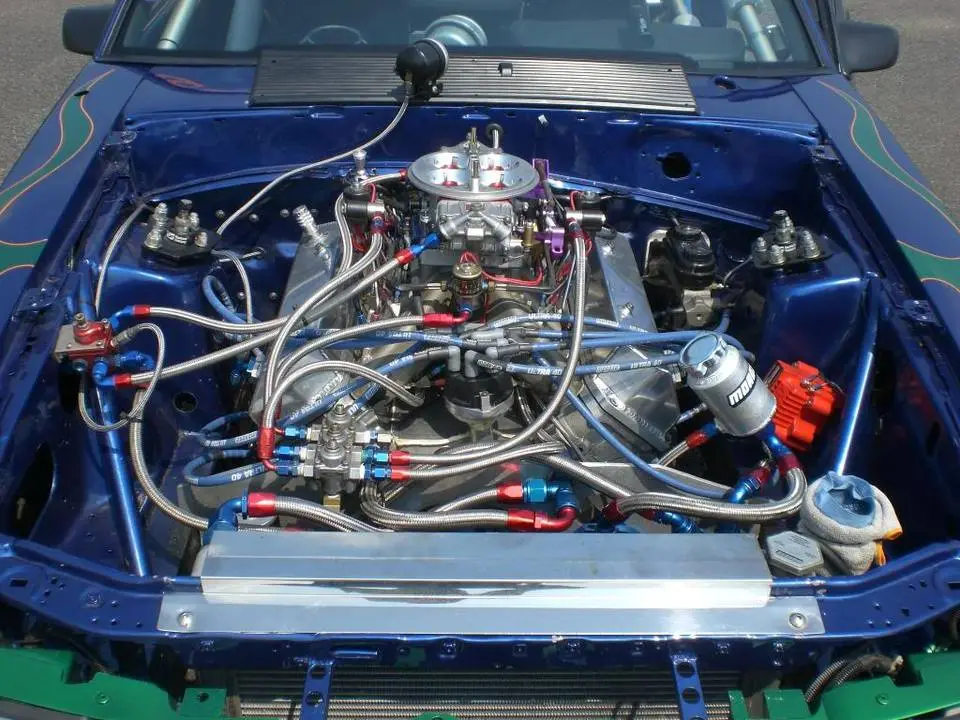

just an idea of the room youll have
Wow,,, thats what I'm talking about! I hope that mine only looks half that good when done! You may have just killed the progress pics though, lol... how am I suppose to back up something like that...:D,,, I'm just a poor union carpenter that has invented a Dual laser bow tuner, for bow tuning.
haha no need to compete with that thing... when the motor was set up it was the best of everything that was needed or allowed by the NMRA SSO rules. he could go sheetmetal and twin carbs now though. the foggers alone are more then most people have in a long block...
Yeah I noticed that!!!! It's sweet! I just want a happy medium, if there is one. To cruise town every now and again, and drive it to the track to outrun some of the trailered cars, as I say that,, mine will probably be trailered as well incase something breaks.
