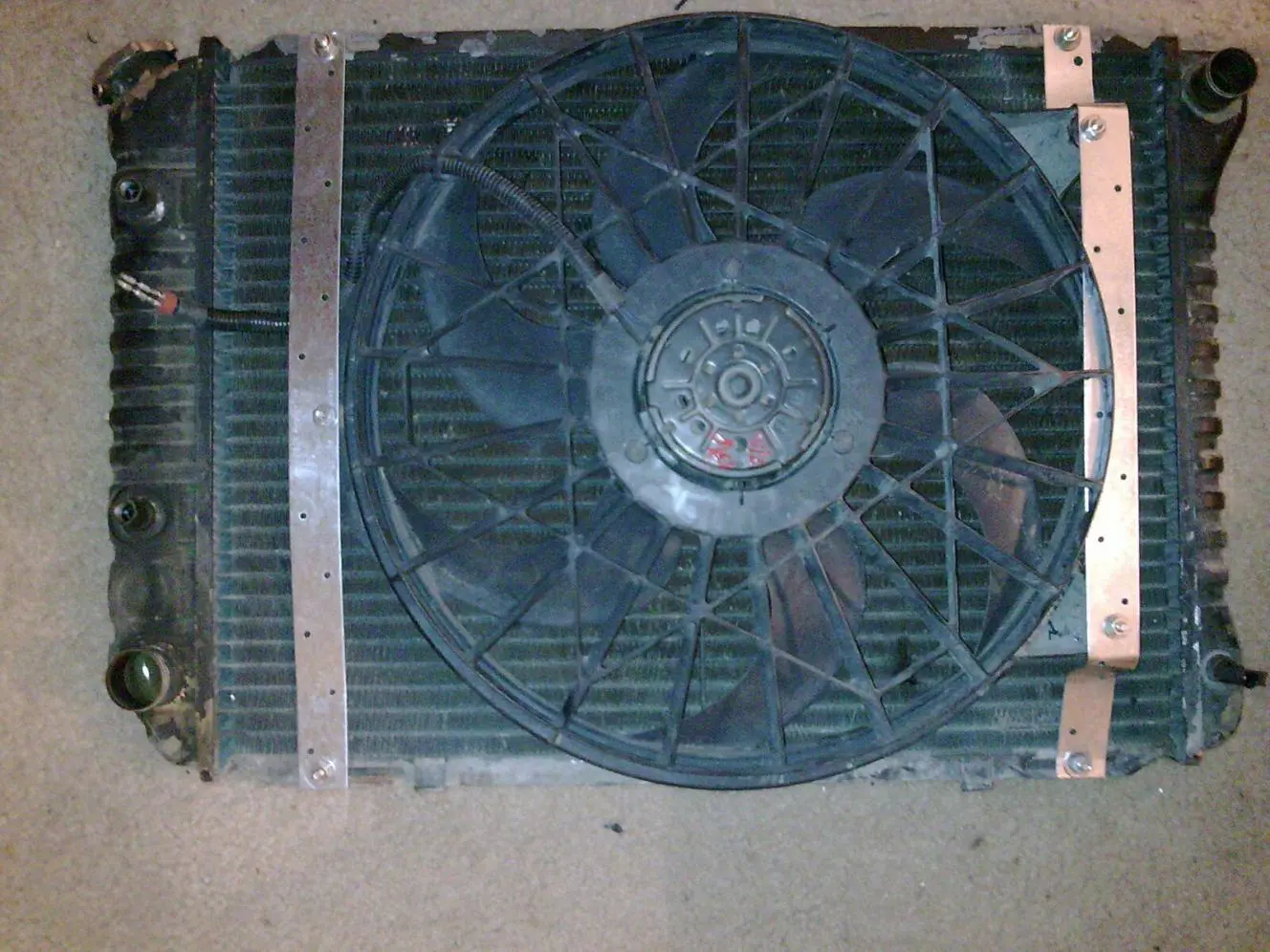

Im not sure why you have a clearance issue but, here is a pic of my electric fan mounted directly to the rad as a puller. Its out of a mark VIII from the junkyard. about $10 & a couple brackets from Lowes. electric fan.webp
