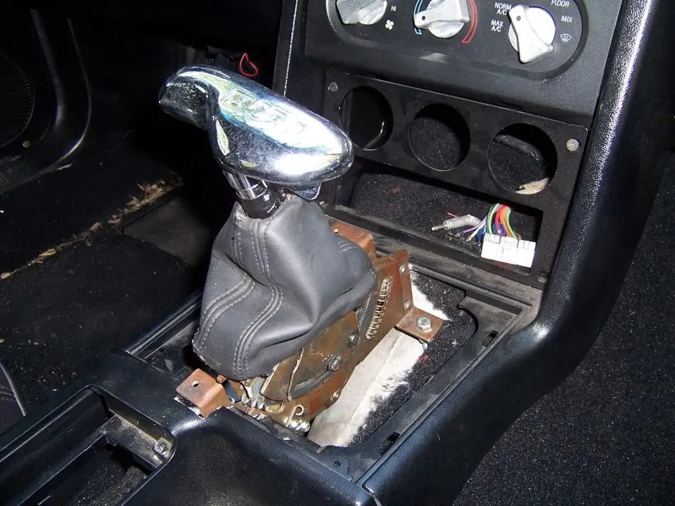

When I raced it I had to leave the shifter in drive because the previous owner put the wrong b and m hammer shifter and it is about to break, so I have no idea what gear it was leaving in. The car feels struggles to get to 3000rpms then takes off and throws me back really hard in the seat

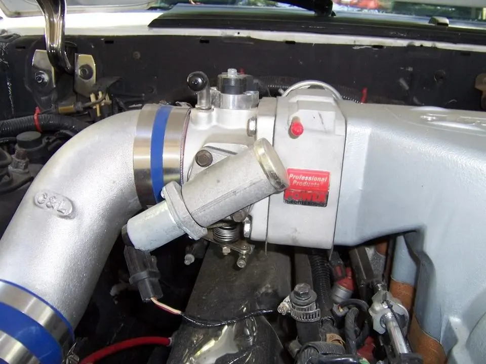

Most PP throttle bodies whistle... at least the three I have owned did. As for the clickingnoise... I havent the foggiest man.

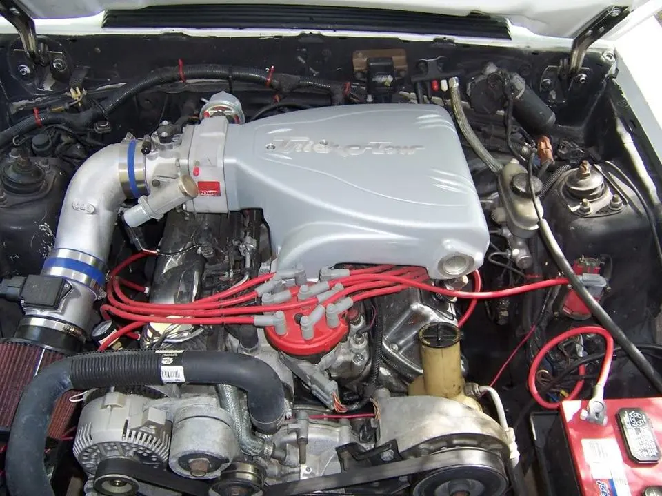

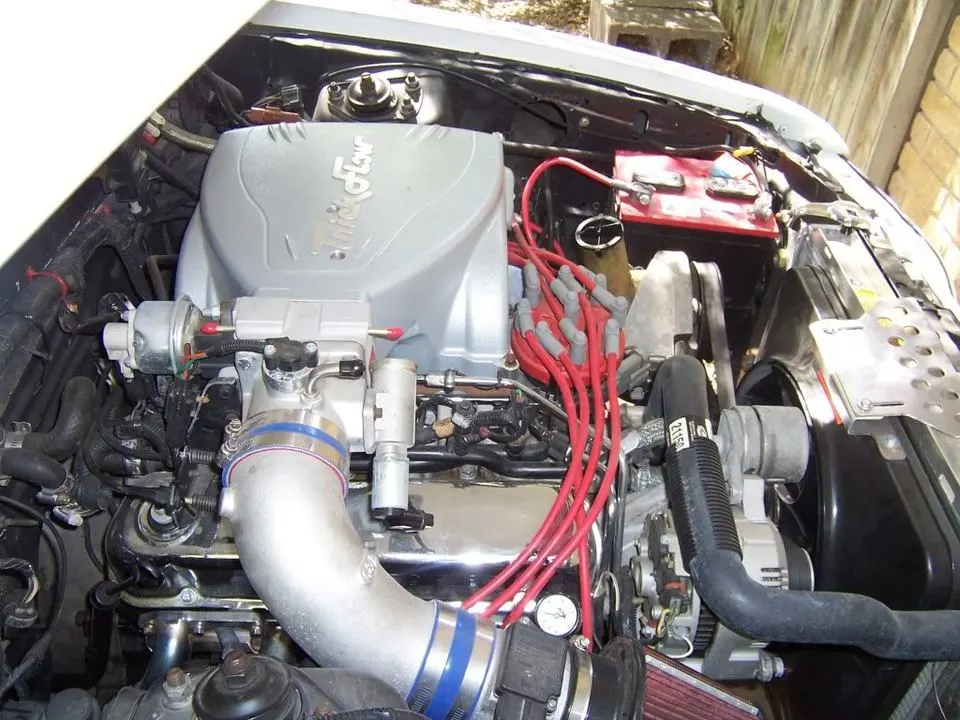

I see allot of little things on that motor I dont like. The mis matching valve covers for one, the half assed block off of the coolant line that feeds the throttle body normally.
The MAF may also not be tuned to the injector size. If its a C&L then you need to make sure it has the right sample tube for the injectors installed, I dont know what size red injectors are but I am sure someone will chime in.
Also C&L meters suck anyway. Having the air filter there will cause issues as well. It will get turbulence from the fan and its sitting right above the header feeding to a metal tube. Your AIT must be extreamly high! I would change that out and get a fender well mounted setup or even a stock box with a K&N filter.
There is allot of very nice stuff there too. Great intake and nice fan/rad combo. Has a 3G conversion and some nice looking headers. You should be able to see what kind of heads they are by looking at the front of them. Most companies will have their name and/or the part number on the end right behind the altenator or the A/C elimination bracket.See what it says and let us know.
Now on to checking for issues. For one I think your trans is a big issue and may only be using 2nd gear at launch. I would still pull all the plugs and check them and then do a compression check. Autozone used to sell this $20 tool that hooked to the port by the drivers shock tower that would test various things but what I used it for was to check the injectors. It would run one at a time full open to make sure each was flowing. Check your TPS and make sure you are at .90-1 volt at closed throttle (there will be arguments on the exact voltage but thats a good range).
