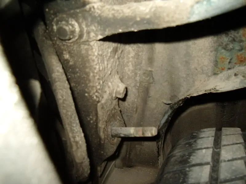

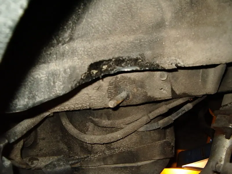

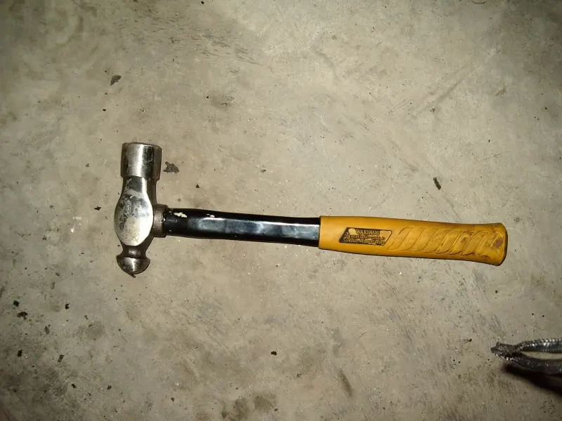

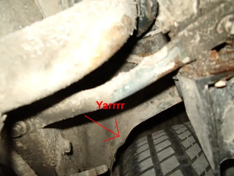

Well after driving the car for 3 days with the right rear tire rubbing occasionally, I decided to take action.
The Problem:
The Problem-Solvers:
Results after 4 minutes of problem-solving:
No more rubbing! All is well in fat tire land.

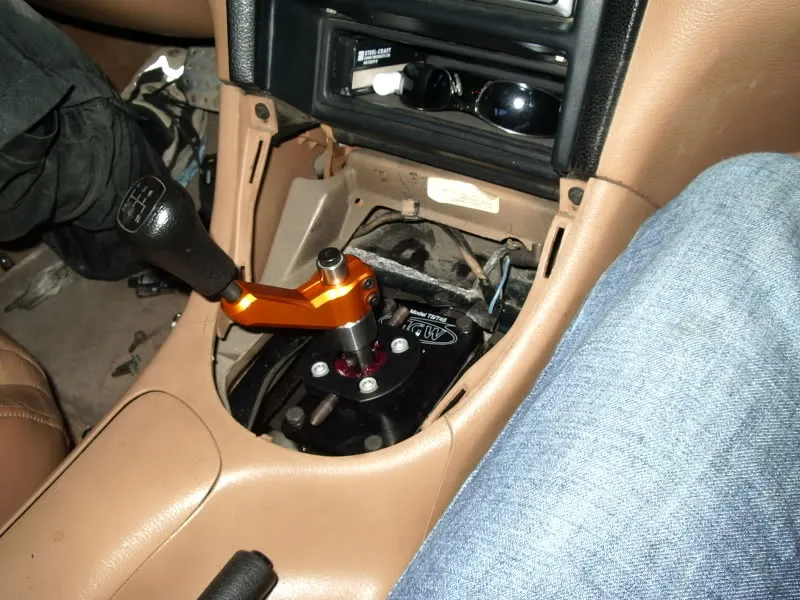

We had the old driveshaft out and the new one on in a matter of 15 minutes, the bolts came out like butter with the help of a torch. Next thing was the shifter, we had that installed within 30 minutes, the most annoying part was getting the lower rubber boot to line-up with the 4 bolt holes over the new shifter, since its pushed up higher over the MGW. Below is the only pic that was taken yesterday.
The next matter of business was to tackle the LCA's once again. We tried bashing on the pass. side axle-side bolt again, and gave up and decided to try the driver's side instead. The bolt did not want to slide-out on that side either, but after about an hour and a half we finally had the new MM LCA in the driver's side bolted-up. After this there was only about 50 minutes left before the shop closed (we were working on the hoist) so had to put everything back together and clean-up. I think we can get the other one done on Tuesday night, now that we have our methode down. As for the uppers, we'll get those done some other time this week I hope.
I now know the true meaning of NVH first-hand. The shifter isn't too loud but is certainly much louder than stock. It feels superb though, perfect engagement and it guides itself perfectly into 3rd. I love it so far!
