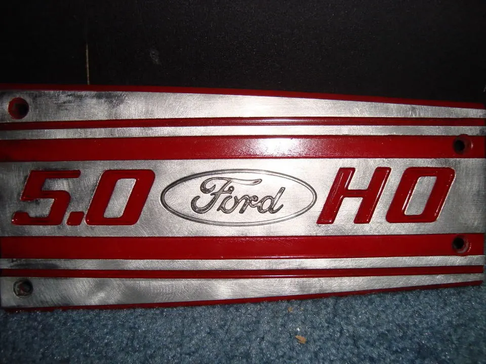

cleaned up and painted the intake placard...

going to repaint the 'ford' center when i get some black enamel
Use blue, it will look better

blue on a red car? not really i'm about to re paint the ford emblems black. i found a forum about ford trucks with all the info how to.
