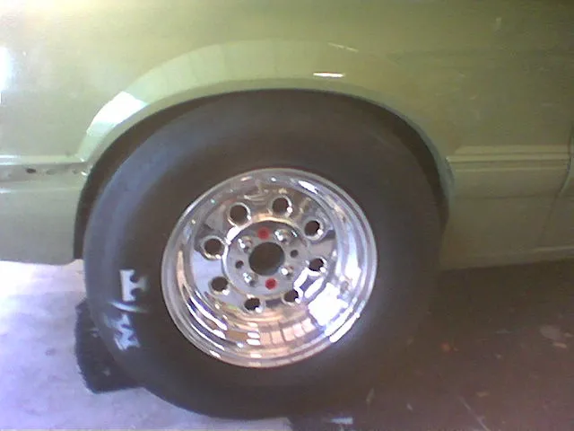

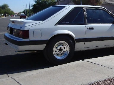

91lxttrim u got any pictures i could see??
yeah check this out...
I have a better pic if the tires on the white LX, I just can't find it right now.
The green notch had ET Streets that were 28.5x11's. They both fit about the same.
