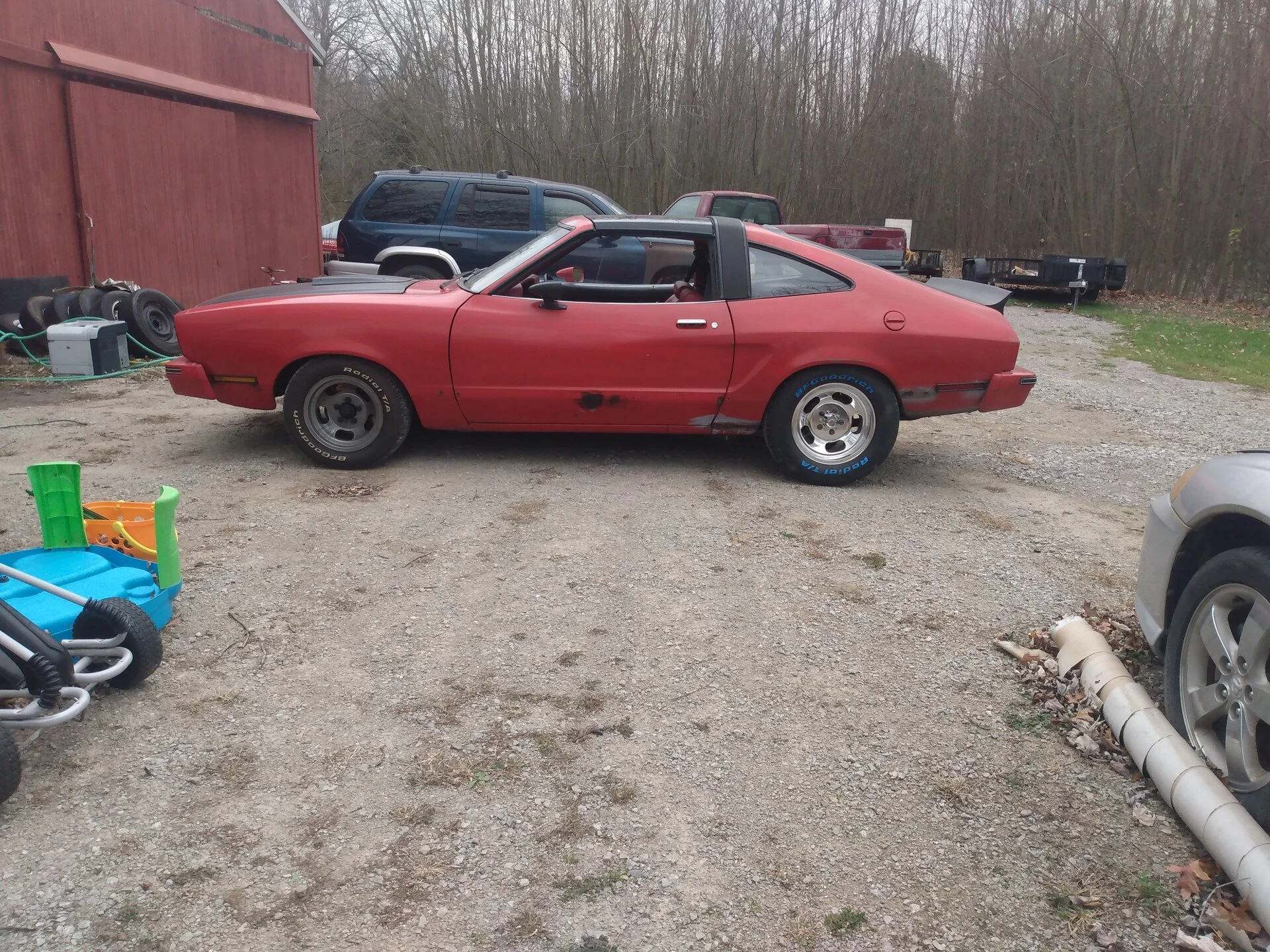

Wait.. 235/60/14 on the front? I rub with 205/60/14 on the front. Granted I cut 1/3 coil from the v6 front springs. Still I cannot see a 235 fitting and not rubbing. I can drive fine but entering aprons/driveways while turning causes me to rub. I cannot turn full lock in reverse on flat ground without rubbing. I rolled the fenders a bit, removed the liner and smashed the pinch weld and still rub. In the 80's I tried putting 215/60/13 on the front of my first II and they rubbed when driving. It was stock up front.

I don't think you should have the wider tire up front. Our cars are nose heavy to begin with. Adding better traction up front vs the rear will induce overstear. Back in the day if the customer had bias ply tires and bought two new radials we were not allowed to install them up front. The improved traction of the radial could induce overstear. Same principle here.
Better to have some understear then to have your ass end suddenly facing your previous direction of travel.
I would probably plan on using the 235/60 on the rear and getting new fronts. I just don't think they will fit up front unless you have the Monroe Handler front fenders or similar modifications to the fenders. Is the front end of the coupe sitting higher than stock?

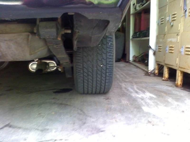

My rear wheels are 4.5" backspacing and 245/60/15 were too big. I am now running 235/60/15 on rear. I smashed the lip in some and still rub on sharp dips or when having more then 2 adults in the car. Depending on backspacing the 235 should fit but you will need to roll the quarter.
I was running 225/60/14 on the rear and they looked good but I was fighting a vibration and bought new rear wheels. So I went to 15's. They fit fine.

What is the width of your rear wheels? I have 15x8 wheels, 4-1/2" backspacing with 265/50-15 tires and only have a slight rub with someone in the back seat when I hit a bump/dip at speed. I don't think I'm rubbing on the lip as there's no damage to the tire but I couldn't rule it out since it happens so infrequently. Again, I'm no help on the fronts since I run a 4 inch wide wheel with 0 offset and 165/80-15s. Those required pounding the body seam and removal of the splash guards, but I've had no problems with them otherwise. These are old pics from when I first installed them in 2010 for reference:

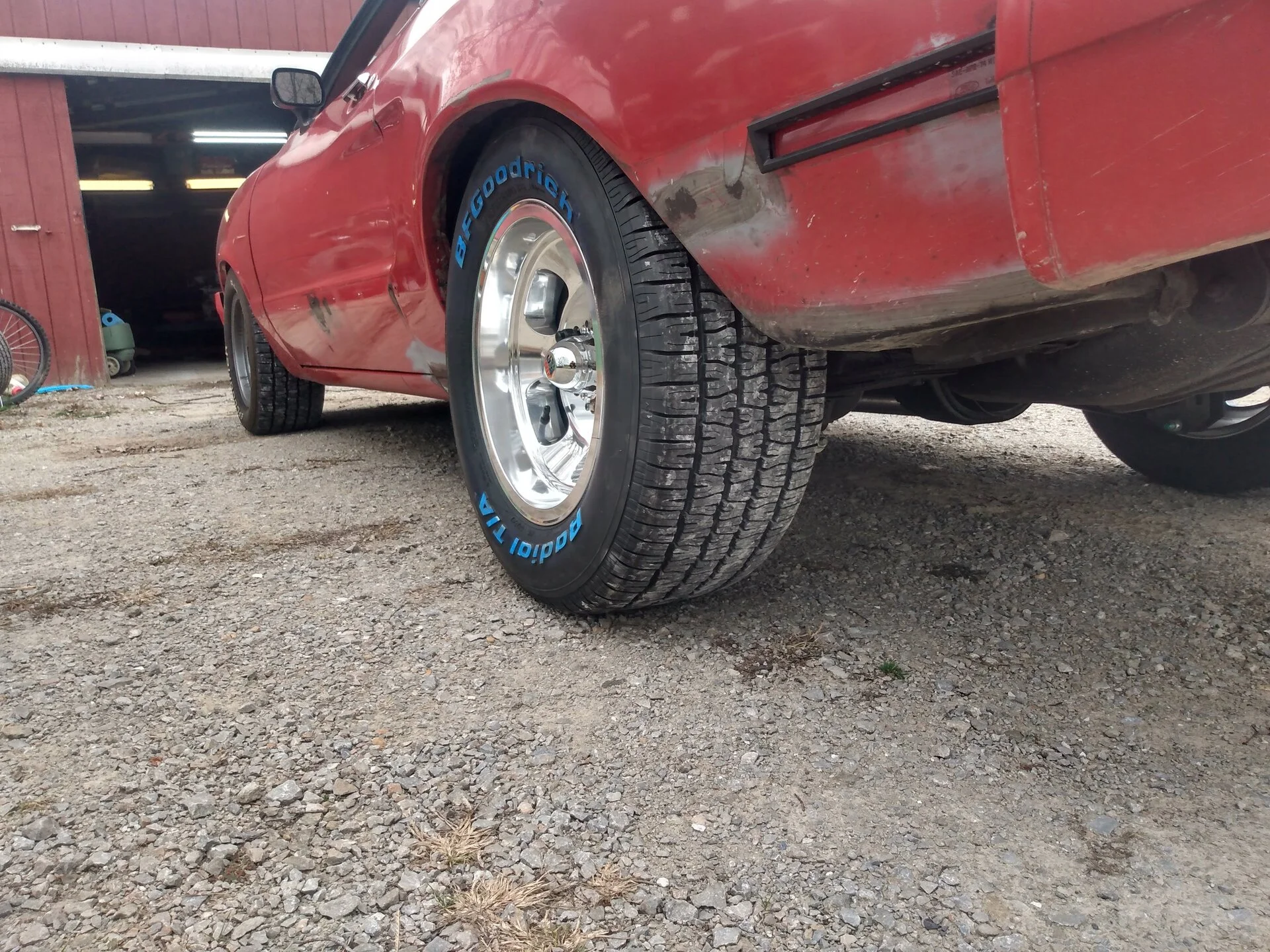

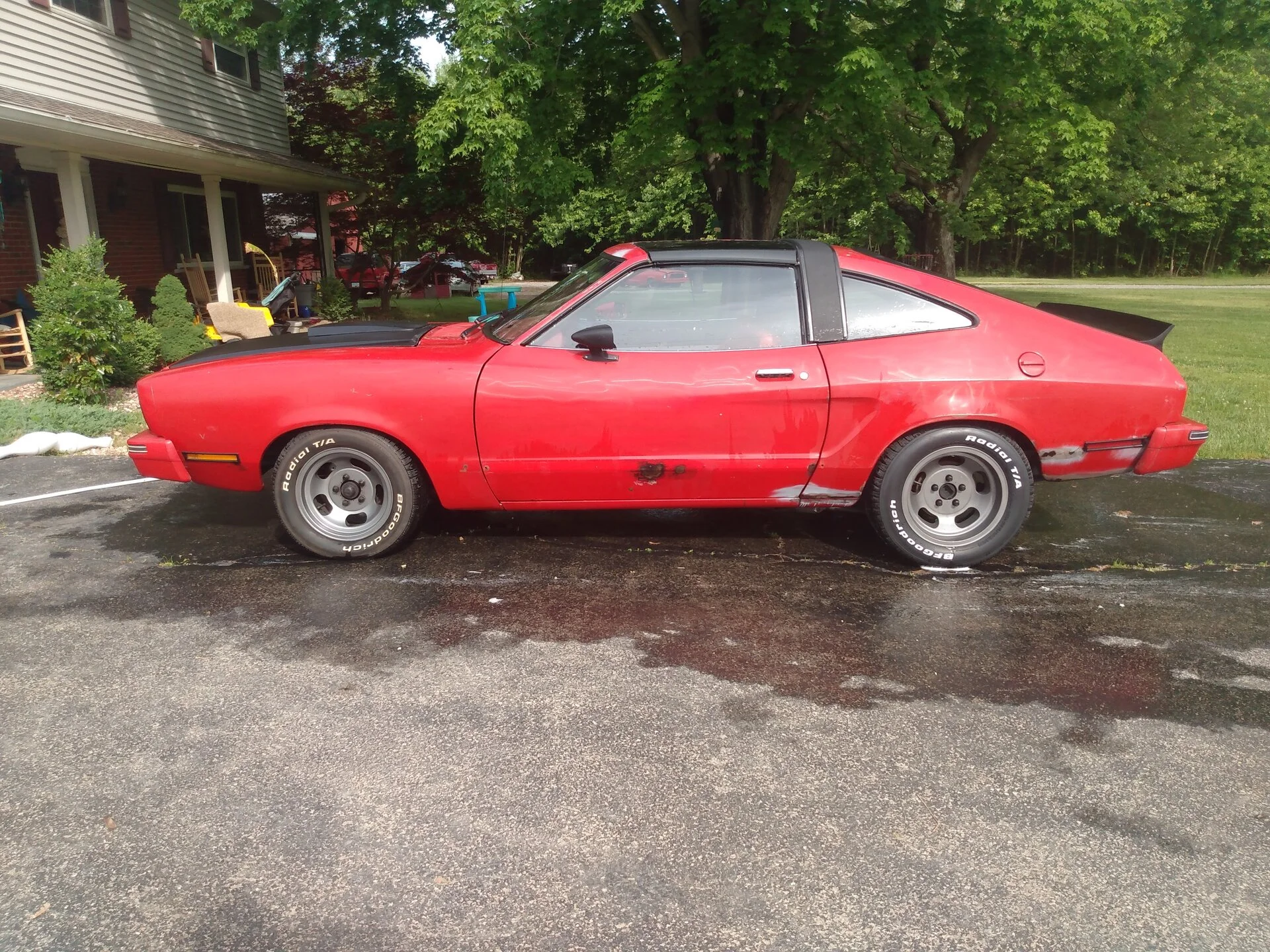

Here I am wondering how you fit the 265's. It has to be them being 50 series. I double checked mine. I run 225/60/15 rears and 215/60/14 front. Rears wheels are 15x8 4.5 backspacing. They rub on sharp dips or riding with an adult in the back seat. Before installing carpet I picked up 2 bags of bedding and 2 bags of feed for the chickens and rubbed with my wife and me in the car going over dips.
I ran the 245/60 for a few miles. Literally just a few miles. I damaged the quarter panel and ripped off a few tread chunks with just me and the wife. The tires hit at about 8 o clock position of the wheel well looking at the drivers side. I think that would be alleviated going to a 50 series. That would not fix rubbing the lip at the top of the wheel well which is where the 225 rub as well.
I have the original rear springs with new kyb shocks. It sits a little lower then some cars in pics but I am not sure if it's tire sizes or springs when looking at said pics.
225/60/15 Rear 215/60/14 Front

Yeah, I also think my car sits a tad higher than yours in the rear, that would definitely help. And I've only had children/young adults in the back, most all of my full sized adult friends won't ride in the back - they had enough of that in high school in the late 80s. :rlaugh:
