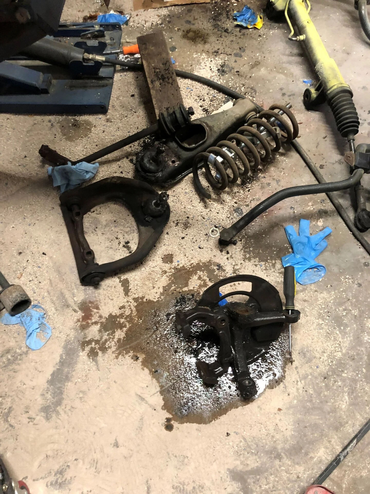

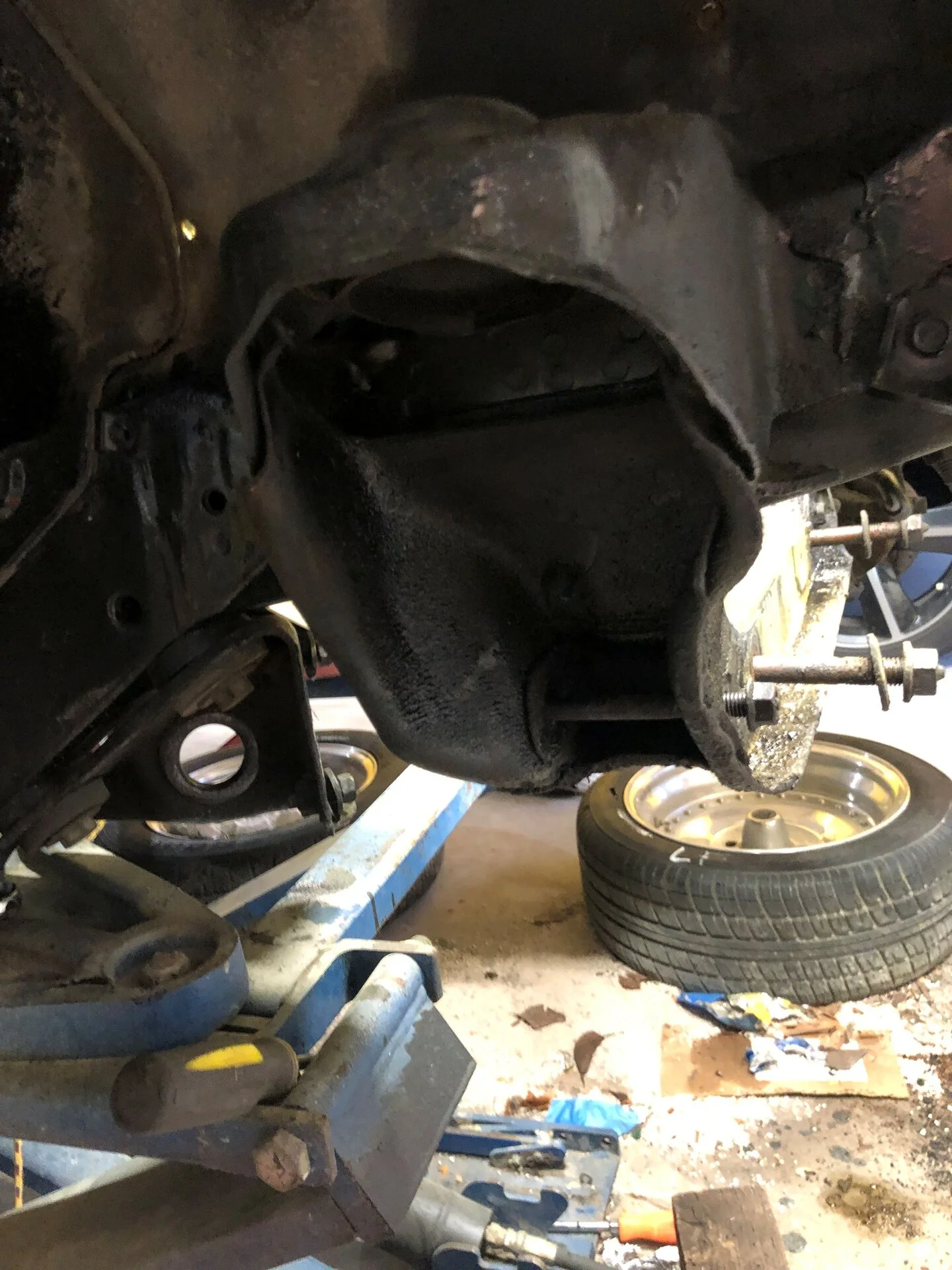

Finally got the right side front suspension off. Going to use a high pressure washer to get the grease off the frame and start installing the coil over suspension. Hoping to not find out this is a complicated process....

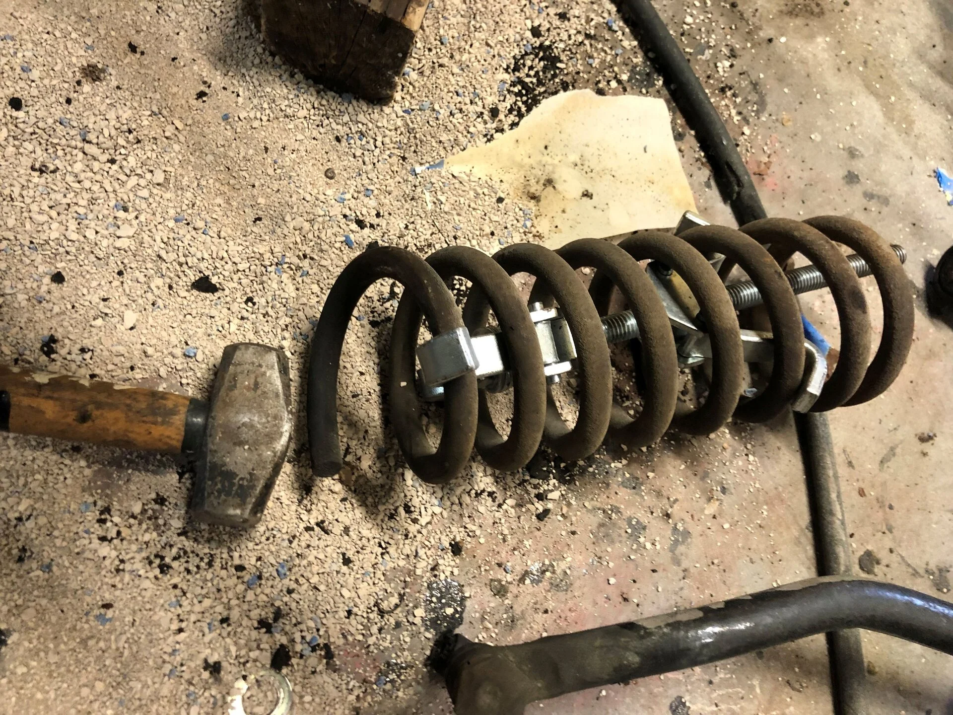

Life Lessons Learned: Well, while taking the front coil springs off I learned a lesson. The shop manual does not say anything about using a coil spring compressor. Not a word. Read it three times. So, I followed the instructions. Put a floor jack under the lower A Arm. When I separated the ball joint from the lower A Arm the body jumped up about three inches, moved a couple of inches to the right and just about fell off of my lift.................I guess the shop manual was ASSUMING the engine was still installed. Lesson learned

Then while in the Marines going to tech school at NAS Jacksonville Florida. I was told by a fellow Marine from Texas the Marty Robins song “El Paso” was kinda a lie. Seemed during the wild west if two dude “Drew Leather” and one lost, it was not considered murder. So I asked why did they shot the guy. Well, it seems they shot him because he stole a horse..........for that you get shot.........And now I have learned to use a coil spring compressor when removing the other front shock. I guess it’s true, you never stop learning. At least I didn't hear anyone using four letter words and i didn't get shot! So that just about finishes my history lesson for tonight....Enjoy! :tss:

I am happy you only learned a lesson. Sucks it was learned the hard way.
I had to have my 2 sons hanging off the front bumper putting the front end back together without an engine installed. Don't tighten the control arm bushing bolts with the suspension hanging down. It can cause binding in the bushings if they are tight then you add the weight of an engine.

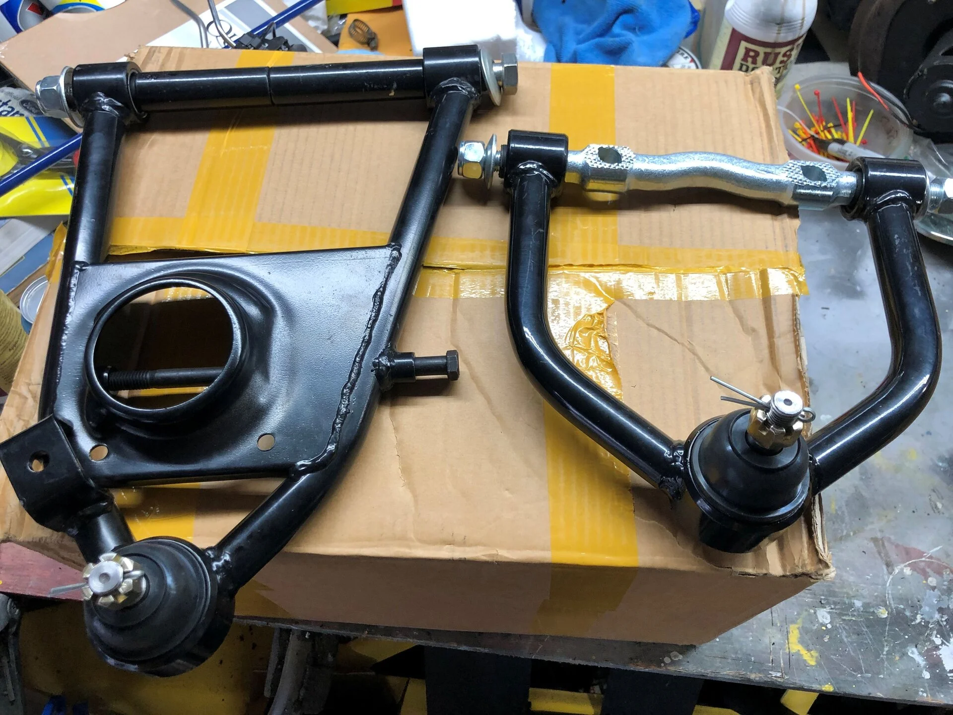

Will do. So, it seems I ordered the wrong lower control arm. I ordered a kit for the aftermarket type MII front end. Now i need to find the lower control that also excepts the strut. Anyone have information where to look? I guess the upper will work.
Found a lower control arm that is said to be the correct one. Part # 91034321
Speedway Mustang II Tubular Lower Control Arms for Coilover, Strut Rod​
Reactions: LILCBRA
