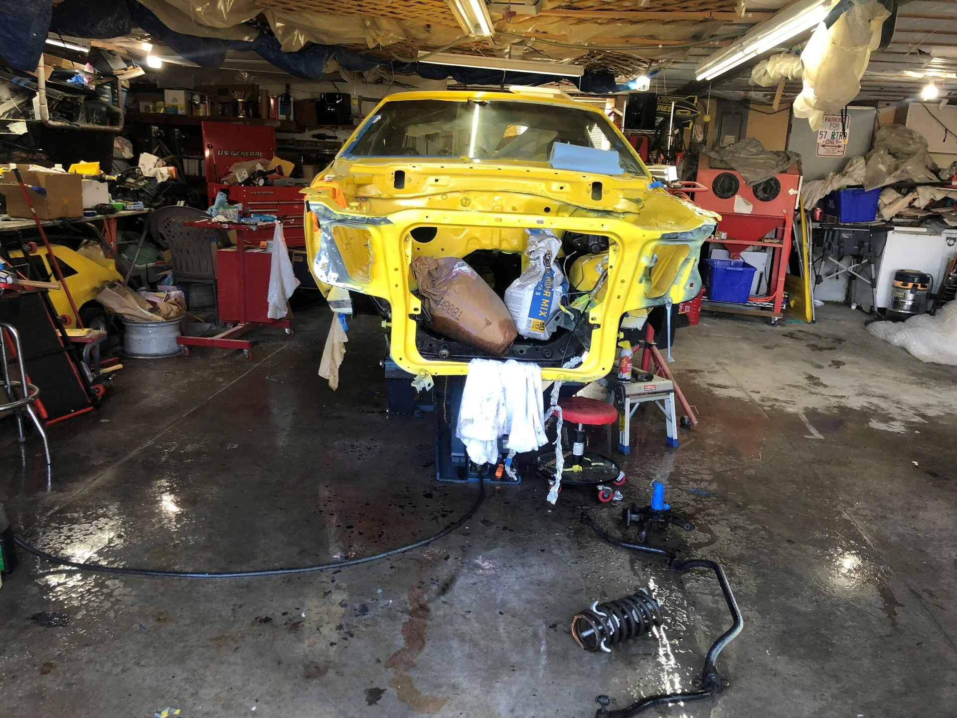

Found out if you use a spring compressor it makes taking all the other parts off much easier... Today is great day regarding my project. I took the last part off I need to. Starting tomorrow I will be putting parts BACK ON:banana:. Ordered the lower control arms and hope it arrives Monday. Sand blasting some parts tomorrow along with finishing applying POR and spraying undercoating in the front wheel. Rebuilding the front brake calaphors. They look new along with the pads and rotors, but car sat for over 5 years, so figure while they are out I will replace the seals.

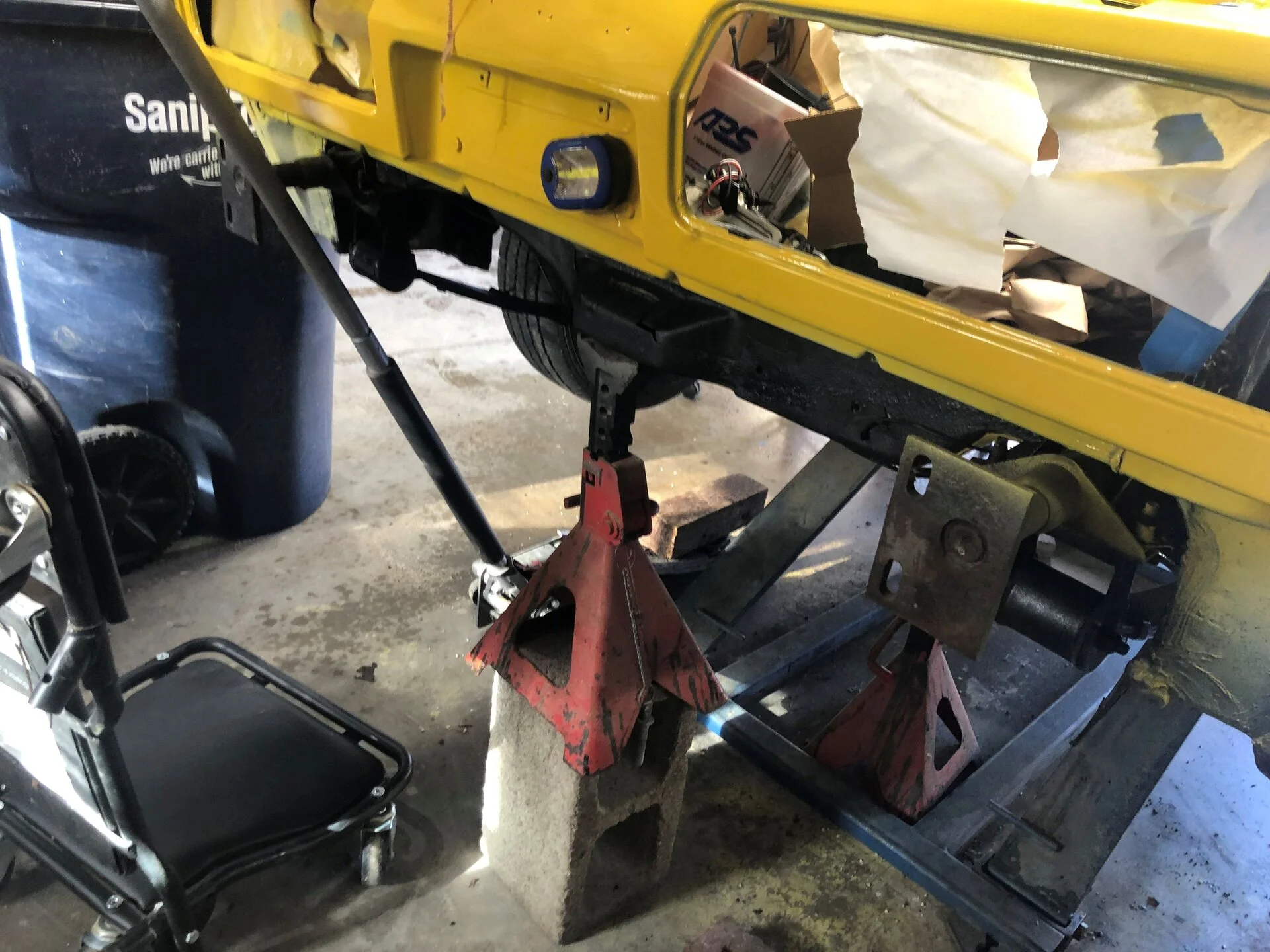

Mustang kept moving up and down so I put a jack stand under the rear and stabilized the body. Hope to start working on the motor and transmission next week. Rebuilt T-5 sitting under my work bench waiting to be installed. Also find out next week if I need back surgery. Losing feeling in the bottom of my feet. That's the parts I use. Well my cat is giving me the evil eye as it's her dinner time....Later

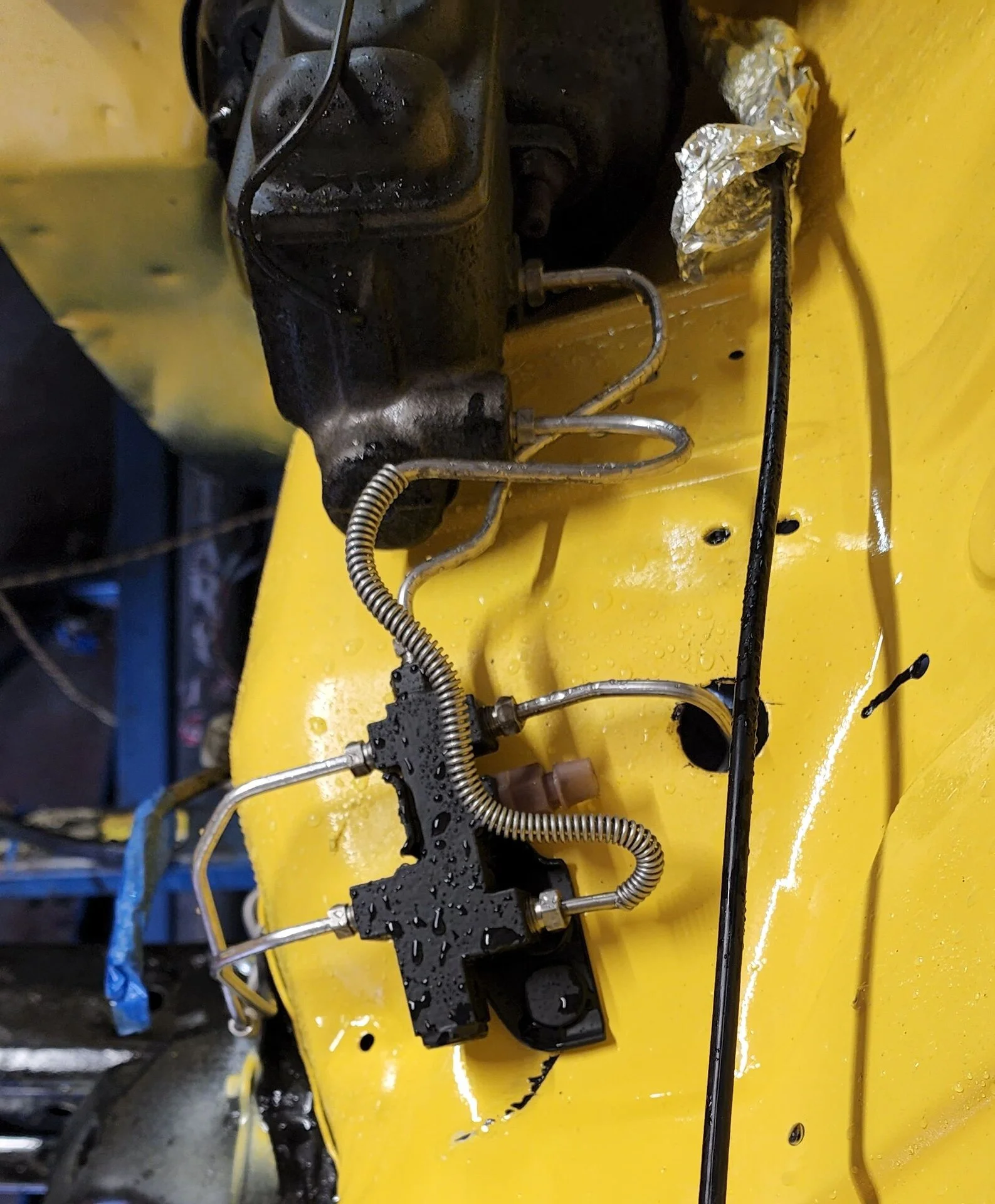

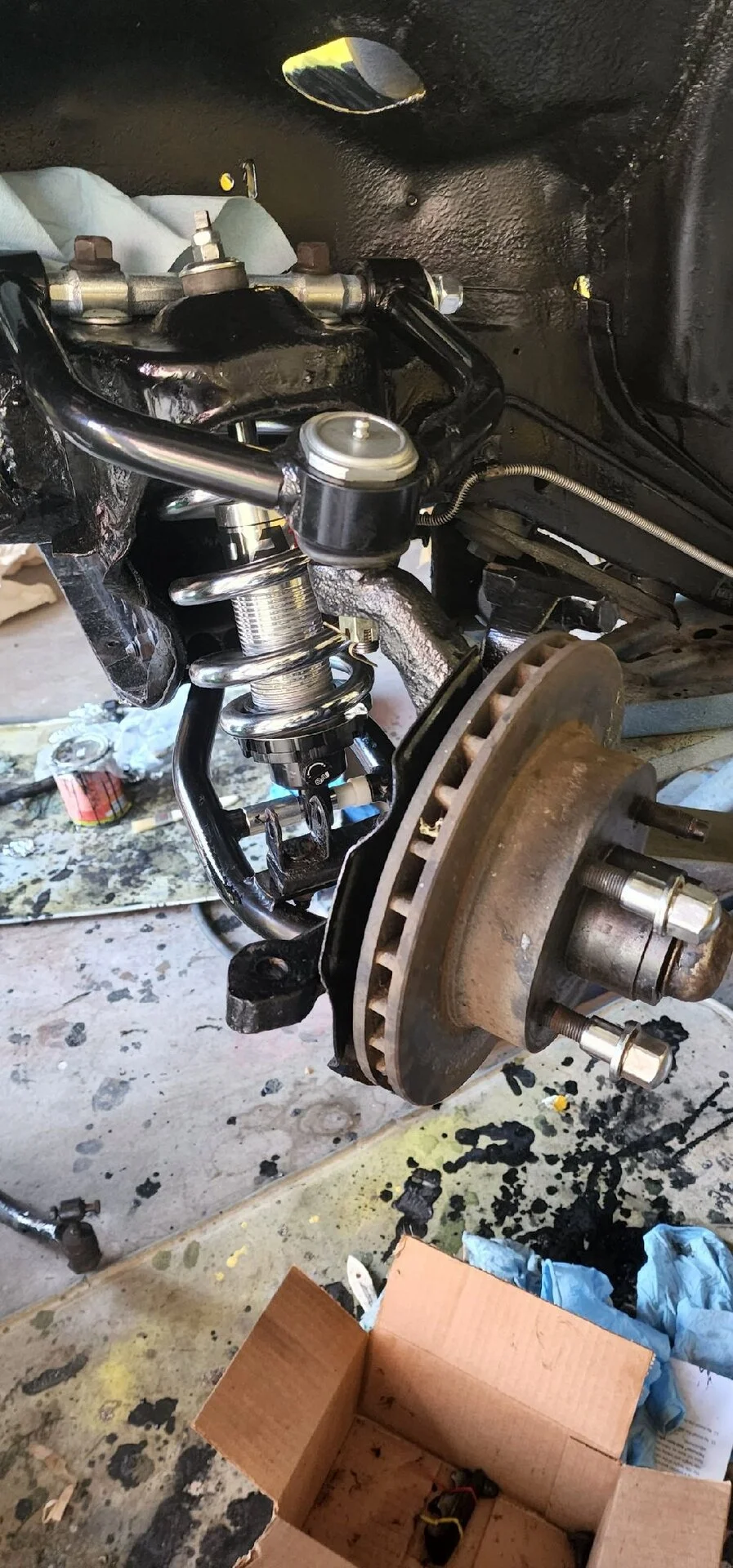

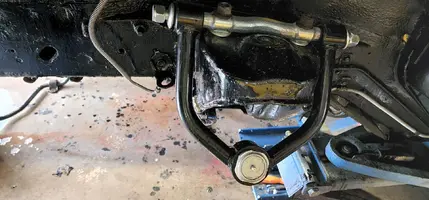

First item I tried to install was defective... Began installing the new upper and lower control arms and coil overs. Tried installing the ball joints on the lower control arm. That did not go well. Seems the treads on the ball joints do not match the treads on the control arm. Took it to a machine shop and they confirmed things were not going to work together. Called tech support, followed the instructions before taking to machine shop. Call them again and they are sending replacement ball joints. Switched to installing the brake engine compartment brake lines. I had the proportional valve powder coated black. Just need to find photo showing which brake line goes where.

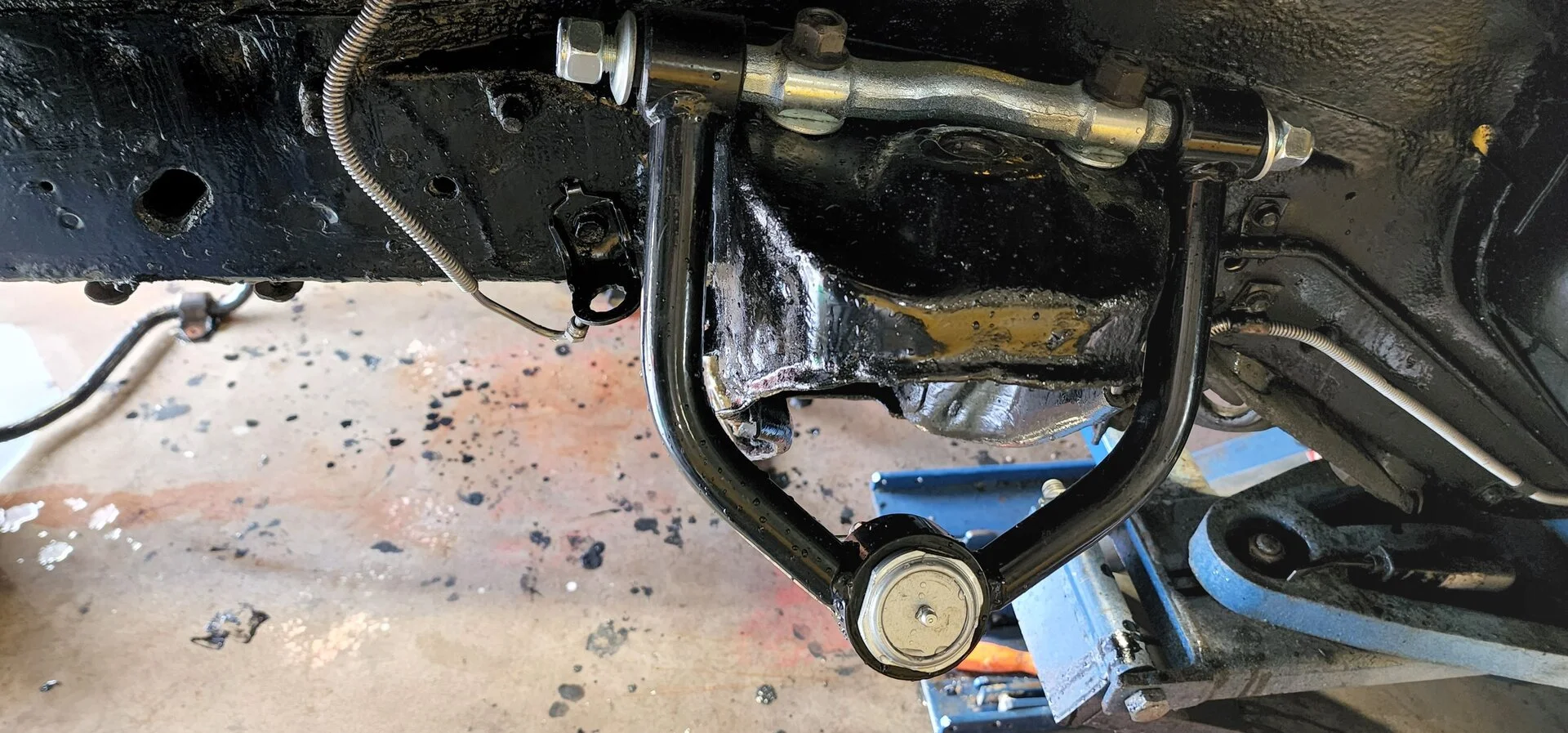

Got brake prop valve installed. Found the extra one with master cylinder lines installed. Installed upper control arms. The lower control arms are at a machine shop. Having the ball joints installed. company sent new ball joints. They did not fit either, so to same time I took the arms and ball joints to machine shop. Hope to have them back by Friday. Figured this will be faster then sending them back, have replacement ones sent. Also figure if two arm are not excepting four different ball joints, there is more wrong then just this set. I will send information and photos to company and let them know what I had to do and suggest they check out their stock. Detailing engine compartment tomorrow then installing power steering unit. Started to replace seals on brake calipors but found out there was rust inside them. Just decided to buy replacements. That's if for now....

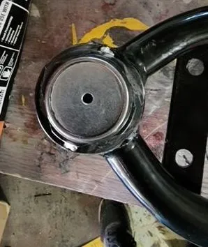

Did you get speedway brand control arms? I initially purchased them but had ball joint fitment issues. The hole was slightly too large and oblong. The ball joint threaded in but would not tighten up.
I wound up returning them and getting the heidts. Speedway worked with me and assured me it was a one off problem but it looks like 2 years later their problems still exists.
I have purchased several parts from them and all were fine except the control arms.

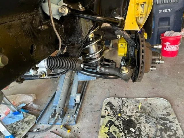

Finally got the lower control arms installed. Had to take them to a machine shop and have the ball joints installed. Owner is a car guy and did my a good one. $60 to install both. Did spot welds to keep the ball joints solid. Had to machine the threads to allow ball joints IIcrew is correct. The mounting place for the ball joints are oblong. Machinist said the way they welded the frame together caused the oblongish hole.... Just need to remember how to install the brakes......Kept dropping stuff so decided it was time to stop and take wife to a dinner and a movie.

OH. The right (car's) rack and pinion arm is to long. Put the tie rod end on and can not get them short enough to align the wheel. It points outward. Going to cut about an inch off the end of the arm then attach the tie rod again. Should work.............:coff:

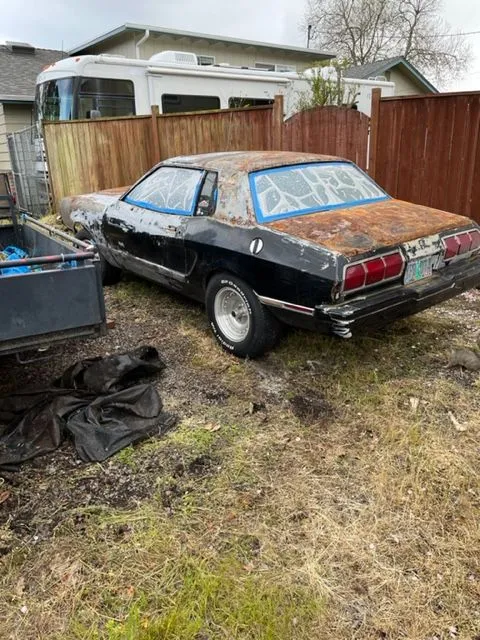

Found a 1975 GHIA on facebook. It is about 20 miles from me. Has the rims and tires I want. Both look good. It is a V6 coupe. are the door windows the same as on a Fastback? Body not good, but glass is good. figure this is cheap and I could pull some stuff, like the door glass for "just in case". Assume windshield is the same. Seats are purple.........really. At one time it was good looking. Just left out in the weather and may have had a front end damage from accident. Anyone needs stuff???? Figure if the tires and rims are in good condition, cheaper the buying new. May experiment on the rear fender to see how the gas cap looks. Car is trashed..............not cutting up anything good, unless some one needs a coupe rear fender.
Reactions: LILCBRA

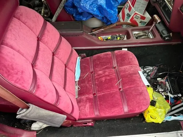

Purchased the 75 Ghia. Brought it home and have been getting parts I need. Car body is in very good shape, except the paint. Seems a young kid bought the car with intentions of restoring the car. It had a nice paint job and ran good, according to the guy who sold it to the kid. Has a rebuilt V6 with AT. As shown i has a very nice pink crushed velvet interior. Lots of parts, like the front bumper and trim laying in the car. HOWEVER, not ding or scratch on the ping crushed velvet interior. Front and back seats in great condition along with the door panels. One arm rest needs a cleaning. Center console in good shape but shows some wear. Needs to be re dyed. I will be putting this on ebay soon. Just go good to get tossed out. Nice Alpine stereo will no be installed in a 65 Mercury or 62 Falcon Station wagon. My buddy can decide yet. Rims and tires are really good. this is why I bought the car. Tires are in really good condition. I found 1 inch spacers under each rim. Front are P235-60R 14, rears are P225-70R 14. Tires are wider then the ones that came with my Mustang. But these were on a running Mustang, so hopefully these will fit properly. They are wider then mine. Put tires on front and checked to see if they clear the new upper/lower arms. Seems good. But I still don't have an engine installed or the front fenders. Working on dash/heater/stereo then putting seats back in and start working on the engine. Any comments regarding the tires ? Put the spacer on the back wheels but the front seemed to fit ..............
