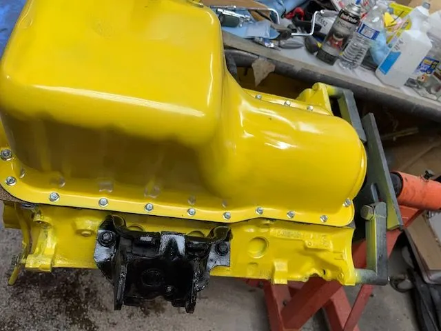

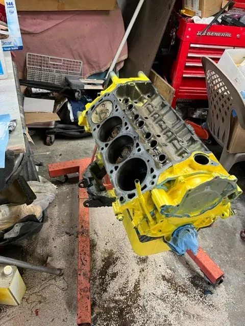

Getting engine ready. Just found out that in 1962 Mercury engines were yellow. At lease my buddy with a 62 merc told me. Hope to have new heads on tomorrow. Took my manifolds to be powder coated and have the rear hatch sand blasted to I can repair some rust areas. Planning to paint the engine compartment Saturday; at least get the primer/sealer done. Ordering new clutch and parts from MDL next week. Was thinking about a hydrophilic throw out beating system but they seem to be pretty costly. Not use which one/system to get.

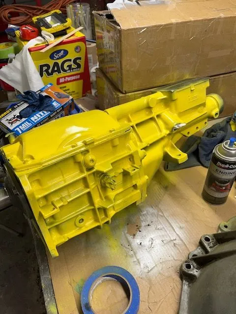

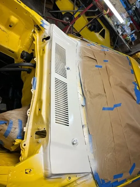

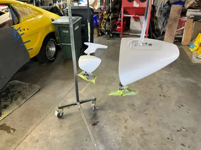

Ordered a new clutch kit today. still thinking about the hydraulic throw out bearing. Need to check some prices. Painted Transmission Saturdy. Looks good. Ran out of paint. got more and will do the bell housing tomorrow. Cleaned it a bit more today. Put more sealer/primer on today. Had to redo the area in front of the windshield. Several areas I sanded came thru. Fix run on the mirrors and put another coat to ensure the black does not show. Painted inside the mirror housing. Will paint the sealed areas yellow tomorrow.

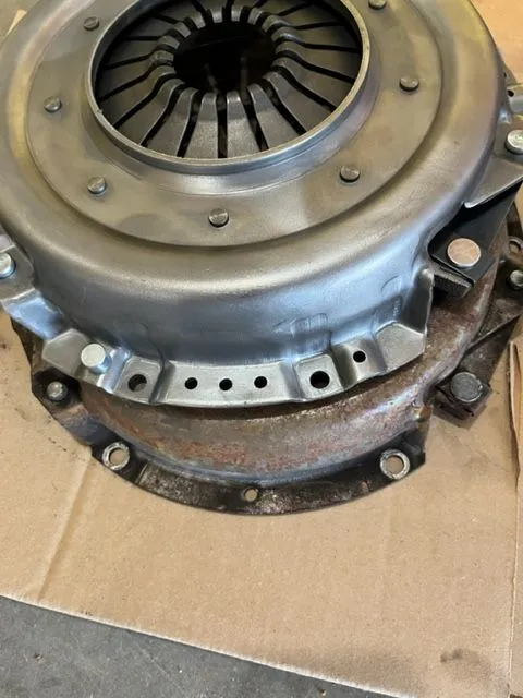

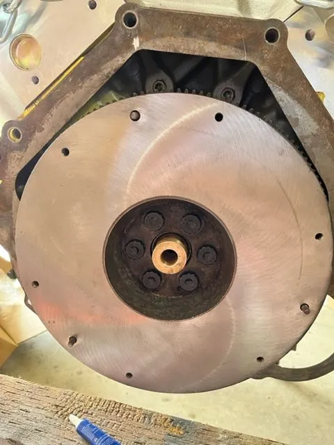

Yesterday tried to install engine/transmission. Had the flywheel done. Looks really nice but is so heavy. Tried to install the new pressure plate and it does not align. Called MDL. They are sending a chart to determine which flywheel I have. Must say their customer support is very helpful.

Called MDL. Seems they do not have a pressure plate for a "REAL" Mustang II fly wheel. They make a replacement that fits this clutch kit. This one is for a 79 or newer 5.0. They offered to refund if I send all the parts back. I am going to keep them The clutch disc fits along with the throw out bearing. I am sure I can find someone who needs a pressure plate. the old plate the the old disc really are not in back shape In fact, they show very little wear. I 'll send a photo tomorrow. I did win $150 on a lotto ticket today so I'm good. Only spend about $2,000 to win, but I won........:coff:
:ot: So my friend who just bought a 65 Mercury Caliente about three months ago traded it for a 1963 Falcon Ranchero. He wants to get the V6 out of the 75 Mustang I have. Has anyone have information regarding a swap like this? I figure it should be a pretty easy swap, just need to find motor mounts.
I am confused on the pressure plate. I was told it's a direct fit by mdl. I have an mdl flywheel and clutch assembly in Christine. I picked up another clutch kit for the mach I from them to use on an oem flywheel. I just compared them and the bolt holes do not line up between the mdl kit and the original ii flywheel. The size matches but the mounting holes are off.
I guess you have to use their flywheel with their clutch.
WTF! Here I've been promoting it vs. using the clutch available from CAR which I have. (MDL was not making a clutch for the 2's at that time.) You'd think they'd tell you that you need the flywheel.

Yep you would think. I still do not have the 2 pilot bushings I paid for from them. The ones they sent originally were tight on input shaft of the transmission I puschased at the same time. As well as being loose in crankshaft. Both were for the same application but were different from each other. I returned them last fall and still have not heard back from them. They did not refund me as they would "investigate what happened" and get back to me. Granted I have not kept harassing them but after a couple unanswered emails I gave up.
I have recommended them a few times but will no longer recommend them unless I tell the problems I have had as well.

Same here. I used the clutch from CAR but at least they were up front about it and came right out and said that you'll need to have the flywheel machined. Which I did and the machinist took the pressure plate and balanced it also. Smooth operating now. For MDL to not post that info anywhere is kind of shady. Not what I expected from them.
They did say they had a flywheel for the 2. Kinda surprised i had a "real" one for my 2. Not worn out. Had it re surfaced. Kinda heavy ........
I am using the clutch disc and throw out bearing from the kit. Using the old pressure plate. it looks find with no wear of burn marks. Disc looks fine, but will keep it as a spare. Small amount of wear. copper just beginning to show. HOWEVER it seems the T-5 output shaft cover is just a bit to big for the bell housing opening. Going to use my dremel tool to shave just a bit off the bell housing opening. Bought a few different bits to see what will trim the hole. should be a quick job.
