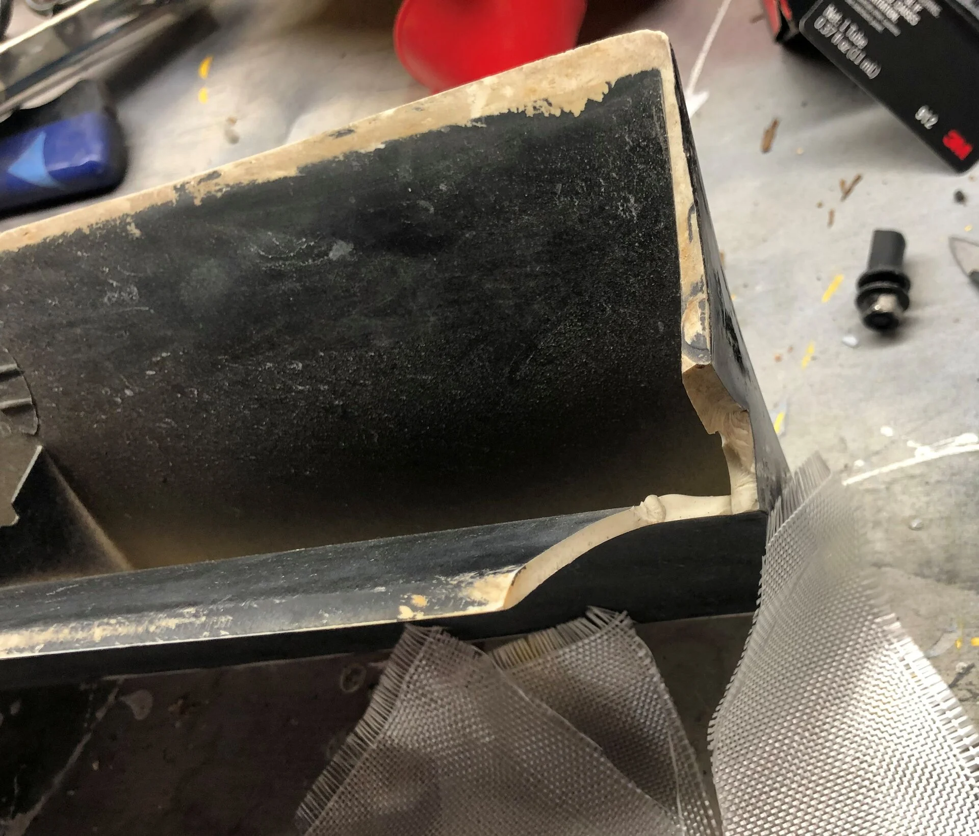

Started doing some work on my spoiler ( not mine, the spoiler on the Mustang). One end is broken. I started building up support with fiberglass sheets for support then placing fiberglass filler on the outside. then sand and paint. I am wondering how strong this will be regarding the bolt/fastener that attaches to the trunk lid. My second question regards attaching to the lid. I had to purchase a replacement lid. This one does not have the holes for the spoiler. I will put holes in before painting. However, I am thinking using the 3M mounting double sided tape. Any ideas?

I doubt tape would hold over time at speed. I would imagine there is a lot of force applied to the rear spoiler. Meant to provide downforce...err. umm sales numbers.
Before drilling holes make sure that your going to use the stock spoiler. Iirc the aftermarket spoilers have different hole locations.
I used jb weld to attach the front bolts on my hood scoop. It's held up for 500 miles or so.

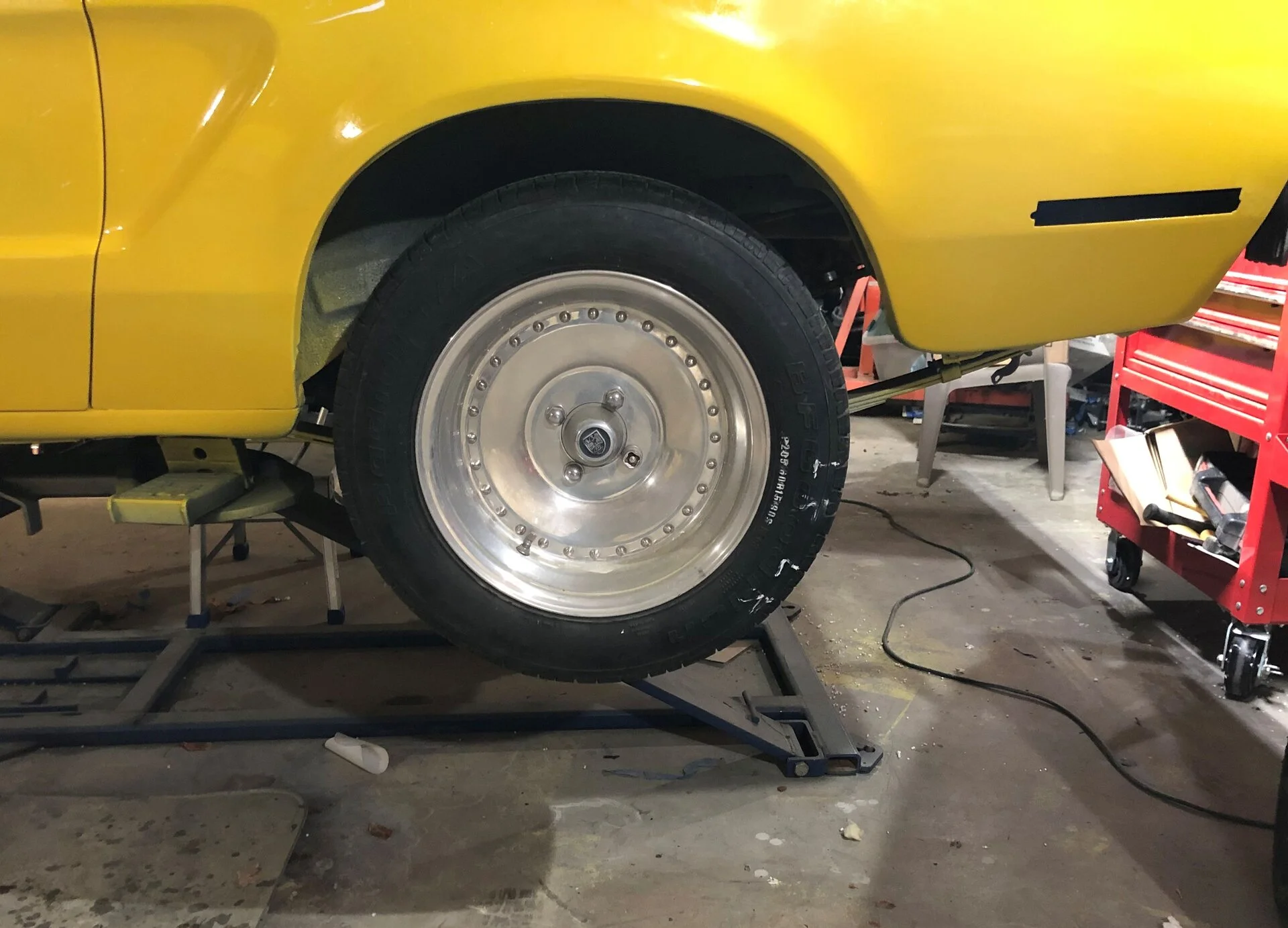

My rims now are 8 inch and there seems to be lots of room. Still waiting for reply regarding what the back spacing is. I did find some BF Goodrich T/A RAdials that should fit. I like the raised white letter tires. Wish I could find some Goodyear with just the "Goodyear" in letters. Found stick on letters.. :doh:
I have 8 inch wheels on the back of mine, it'll depend on the tire you go with. I have 265/50-15 and had to bang a few spots with a hammer in the inner well and on big bumps/dips it rubs the wheel well seam lip. I'm pretty sure they're 4-1/2" back space, but I'd have to refresh my memory. Could always go through the wheel thread in the technical sticky to see what others have gotten away with though, it's in there. But if it's 4" back spacing, the same size tire might work.... :shrug:
I just cruised through the final few pages of that thread, here's the post where I finally mounted and installed the rear wheels on my car.
Alright-I FINALLY broke down and bought the new wheels and tires, well rear tires as of right now. I don't have the fronts yet, no one has the size in stock (165/80-15's on 15x4's), so they will have to wait until next weekend. But, I have the rears- 15x8 with 265/50-15's. I have to say I love it!! Anyways, since there are only a few pics with this size, I thought I would post the few I took of mine earlier today. Sorry for the relatively crappy quality-I took them with my phone. If anyone is interested, I can take a few more with my actual camera.

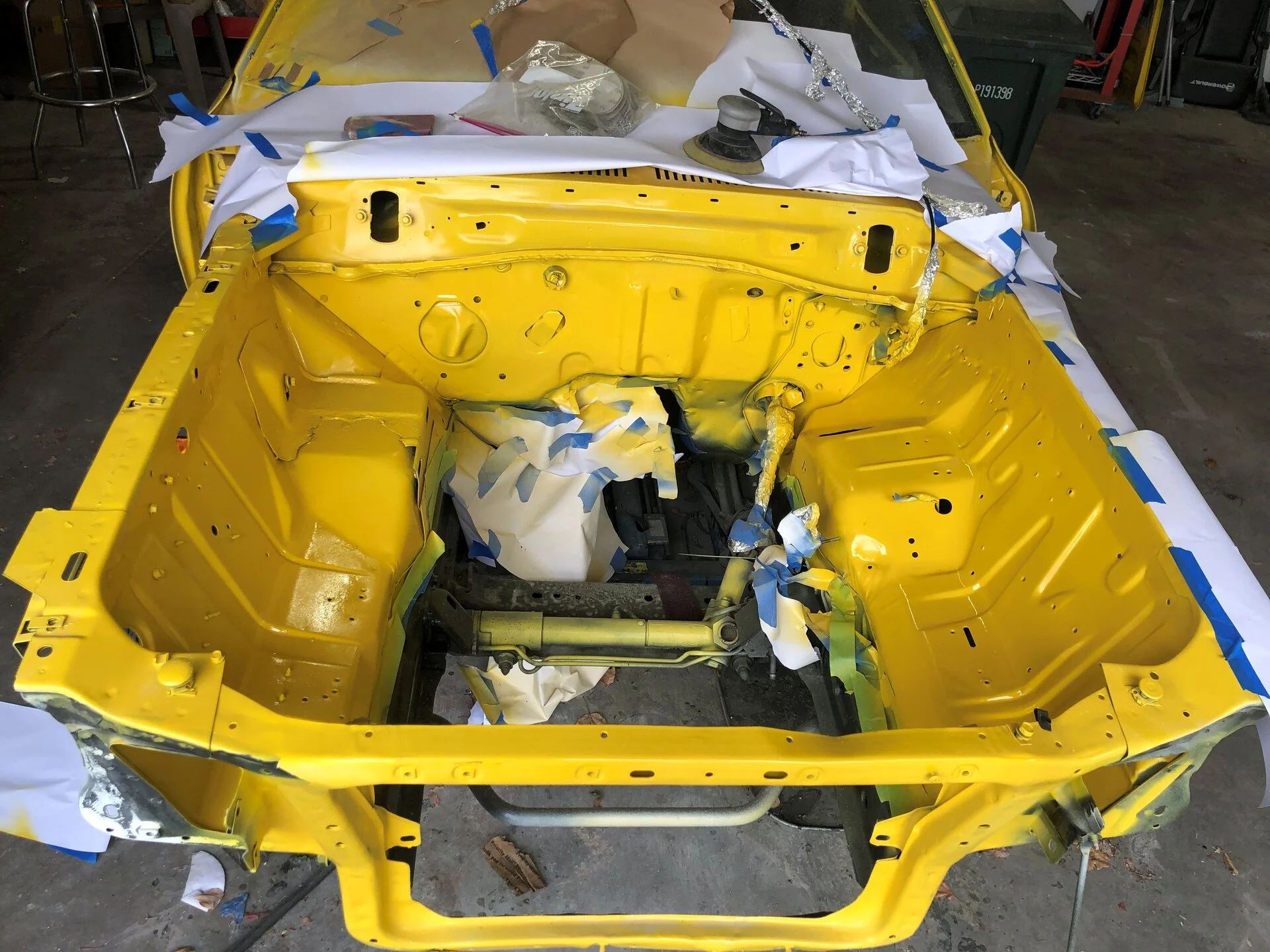

Thanks for the information and mostly for the photos. That's the look I am looking for. Right now my rims are 15 X 8 front and rear. Rear tires are 205/60/R15, front are 195/50/R15. Fronts look good now. I will keep this information when I get ready for new tires. I need to remove the rims and polish them. One rim has a small area of corrosion i need to repair. Most likely need to take to a machine shop. Thus the idea of the 15X9. They don't look bad. Just need to be polished. Here a photo of the engine compartment. While the painting equipment is out, I am going to spray all the trim black.

They move around alot with the changes in temp. Expansion/Contraction. I doubt the tape could hold them.
The 3M tape held on side strips on my repainted Cougar for years and was still a PITA when I wanted to change the color. It held the rear window plastic Wingdings on my wife’s Neon. The foam has some flex, but it is tough.
I checked on the Cobra grille insert in my LX, and there are two ugly screws through the top.
Either way, your’s will not go anywhere once installed.

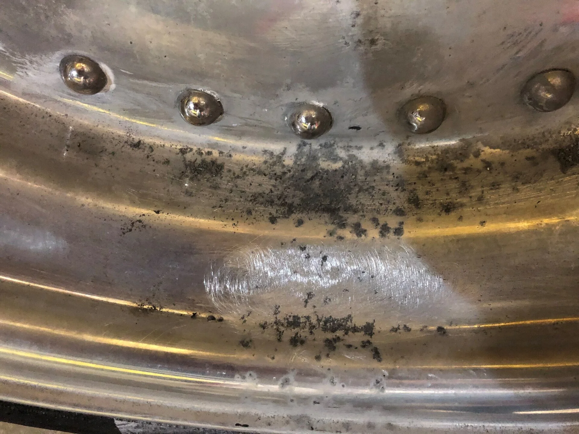

Here is a photo showing the corrosion on the rim(s) i have. This shows the one with the most. I tried to grind some off with a hand held air grinder and about 80 grit. Anything less then that did not seem to do anything. there are scratches. Don't know if I can get those out. Could not find anything on the net showing how to clean this. I like the rims and they polish nicely. Any ideas how to clean these? Can't find these new with 4 lug. However, as mentioned, there is a set on ebay. Mine are 15X8 Ebay rims are 15X9 with a 4 3/4 backspace. Mine are 4 1/4. I have 209/60/R15 now. Lots of room. Thinking 225/60/15 should fit fine. A buddy just bought a 63 Falcon Station Wagon. Very nice.

OEM wheels that have that type of acne can often be diamond cut and clear powder coated again. The rivet heads will make this type of cut problematic.
You might need to run a power ball, (a polishing thing on a drill, not a lottery ticket), with Flitz or whatever metal polish you like to shine the good aluminum and just keep it from getting worse.
